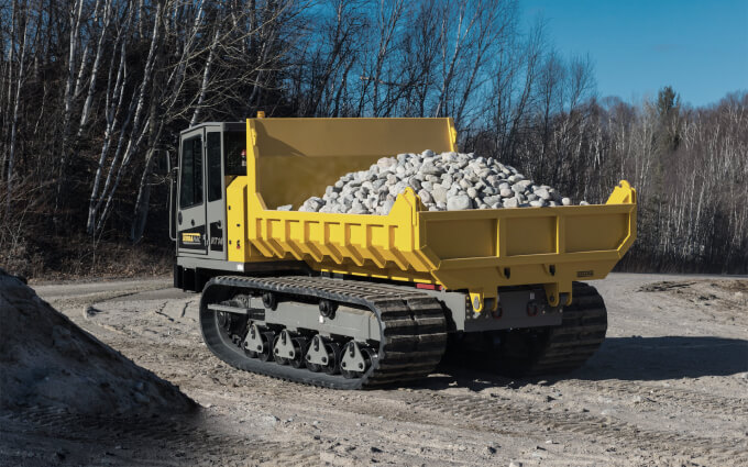

MST2200VD​
Used a morooka12t one on a pond extending job, ground was soft (tractors needed dual wheels to travel there), and quite a short haul.
It was probably the ideal tool for that job, but I think a long haul or better ground would start to limit it.
It was surprisingly quick and nimble for its size, viability was not the best, but the lack of mess was really good climb out of it and you would sink to your ankles, but the dumper was hardly leaving a mark.
Fuel use was heavy for a dumper, compared to a wheeled machine but a wheeled machine wouldn't work there.
This one was on rubber tracks, I would guess the Komatsu pictured above on steel would not be as smooth or quick traveling. :unsure:

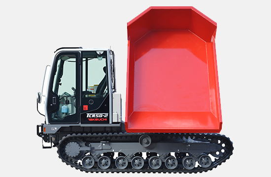

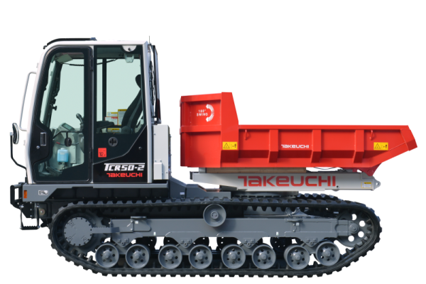

TCR50-2
Takeuchi Tracked Carrier​
https://youtu.be/j00bivycJTo👍:unsure::coffee::whistle::unsure:
