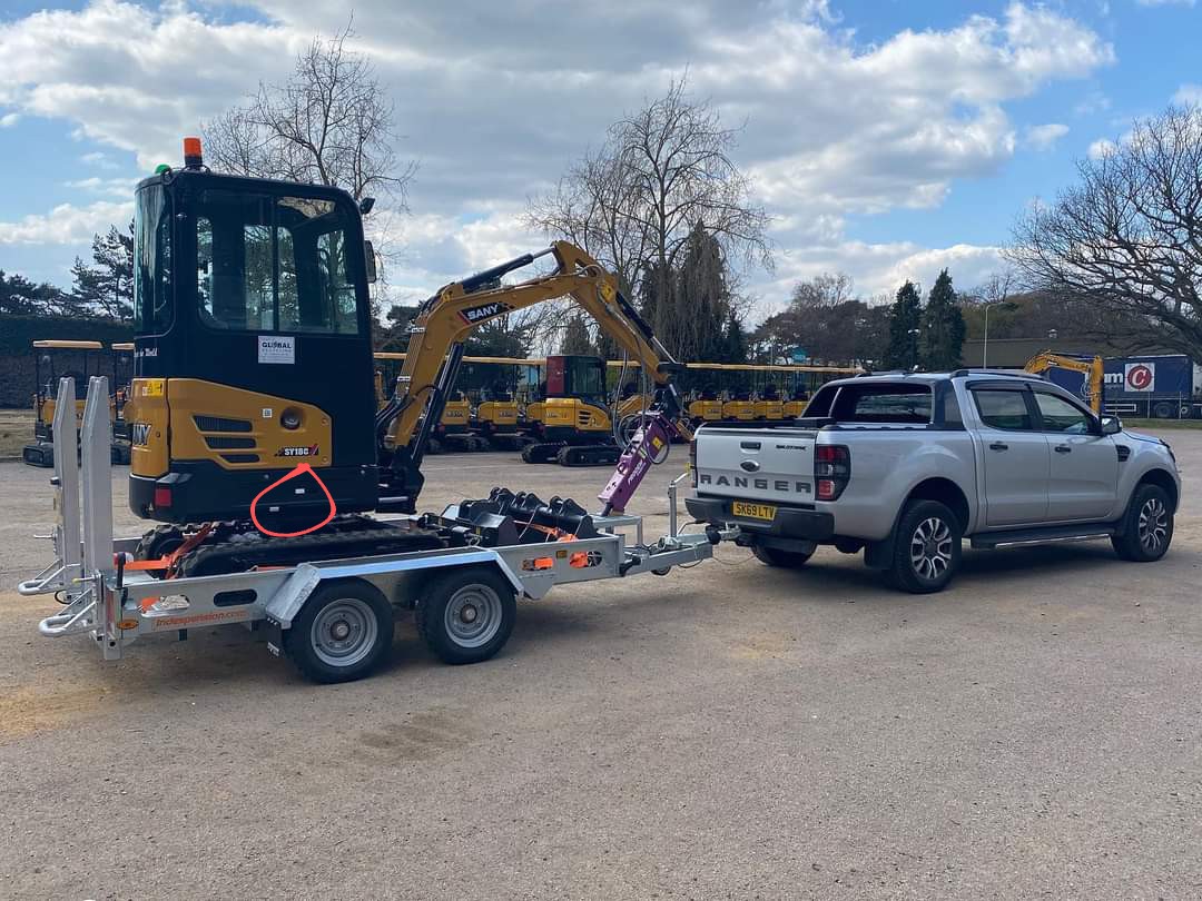

And a single strap over the bladeThat and it looks like a 2.6t trailer.
Thanks - now I'm stuck with the image of you in a dressToo much wag, nae enough drag.
Waggling.Thanks - now I'm stuck with the image of you in a dress
bet that was tail happyI thought this looks like it will end up on this thread can't ever imagine thinking that loading would be sensible
Could be better balanced than you think with buckets and possibly 130/150kg breaker. Point hod on the bucket rest isn't very clever mindbet that was tail happy... be surprised if he could get above 30 without that snaking
That's the problem with the alumax unless you add a floor, you have to have all the buckets up front so with pecker the machine is a bucket space further back. It's probably borderline balance wise and well under weight capacity wise.I thought this looks like it will end up on this thread can't ever imagine thinking that loading would be sensible
I always make sure I’ve got at least ‘some’ tongue weight tbh, just by keeping an eye on suspension height and if in doubt having a feel of the hitch (they feel tight to open if negatively weighted) - obviously don’t actually open it if weighting is in doubt!!!That's the problem with the alumax unless you add a floor, you have to have all the buckets up front so with pecker the machine is a bucket space further back. It's probably borderline balance wise and well under weight capacity wise.
The only thing is who actually checks their tongue weight especially on a twin or Tri axle
I think most plant trailers made for mini-diggers (ie with bucket rest etc) end up with the counterweight behind the rear axle - the balance tends to be right though.I don't check but am very careful where I place a machine
I always Make sure the centre of slew ring is slightly closer to the front axle than rear axle, I would always rather have to much nose weight than not enough.
If loading position is difficult a tri axle is far more forgiving on load position than a twin axle.
And with the load I posted up I would have either put a bucket in the pickup or stacked the buckets at the front and strapped them.
Either way I would not want the counter weight behind the back axle
I'd just put the ditcher the same way round as the other buckets and go on with the blade to the back it would give more than enough nose weight I would also lay the pecker ontop of the buckets but being new I suspect they were worried about scratching the paint.I don't check but am very careful where I place a machine
That would be too easy!Why not just stick the breaker in the back of the ranger
