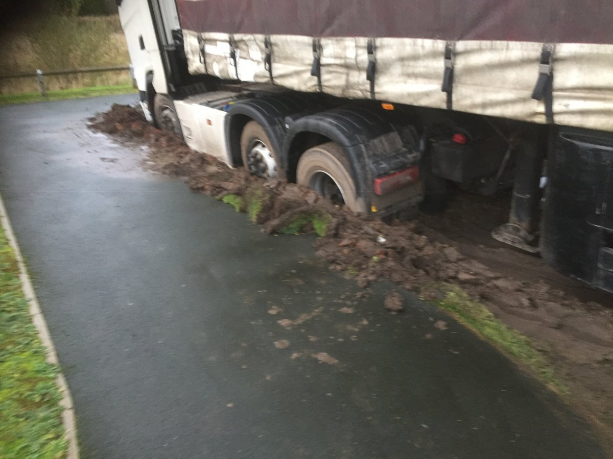

Had a call today from a pal of mine to ask if I could help a stuck wagon up the road from me so nipped around in the van to assess the situation and found this
The front wheel had dropped into a small manhole
So when back to base loaded up my truck with my machine to get a bit of weight on, managed to hook a chain from the front of my truck to the back of his trailer (which was fully loaded with 26 tonnes of baled cardboard) and eased it out(y)(y)

So what was the story? How and did he get in that position. And welldon
He tried to turn around in a small hammer head in the dark last night so bumped up the curb to get around but after a few shunts found the manhole and the feast asthey say is history

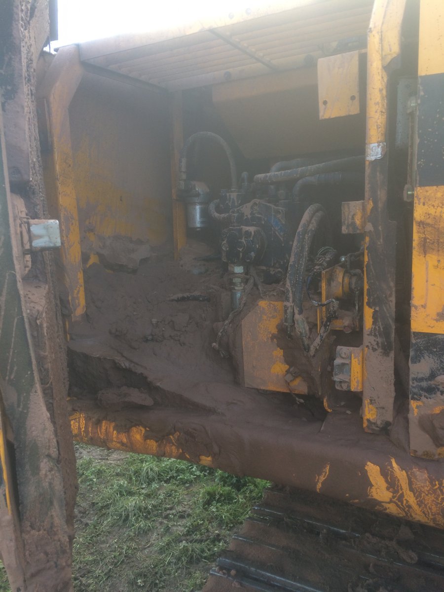

A mate found some running sand with his JS160 so I went and dragged him out this afternoon (after laughing and taking photos obviously!).
It was very bogged, incredible suction holding it in. It made my tractor sit up a bit on the winch!
Just a bit of cleaning to do now...

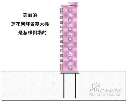

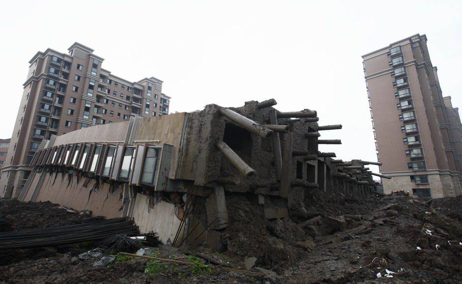

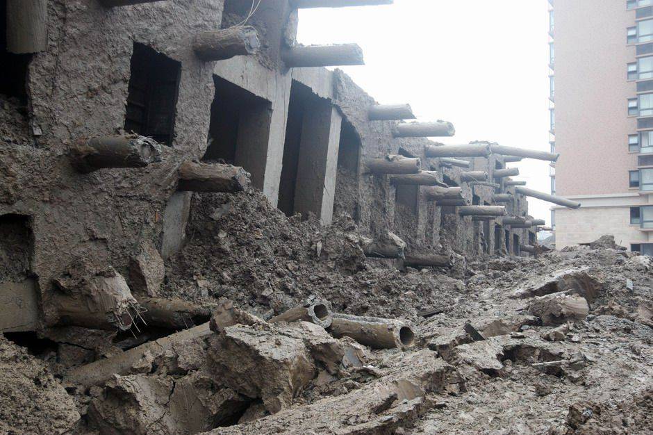

IT'S A 12 STORY BUILDING IN CHINA. LYING ON THE GROUND
(1) An underground garage was being dug on the south side, to a depth of 4.6 meters.
(2) The excavated dirt was being piled up on the north side, to a height of 10 meters.
(3) The building experienced uneven lateral pressure from south and north.
(4) This resulted in a lateral pressure of 3,000 tonnes, which was greater than what the pilings could tolerate. Thus the building toppled over in the southerly direction
First, the apartment building was constructed
Then the plan called for an underground garage to be dug out.
The excavated soil was piled up on the other side of the building.
Heavy rains resulted in water seeping into the ground.
The building began to shift and the hollow concrete pilings were snapped
due to the uneven lateral pressures.
The building began to tilt
And thus was born the eighth wonder of the world
If the buildings were closer together there would also have been a domino effect
some f**k up !!!! :eek::eek::rolleyes:
