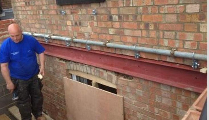

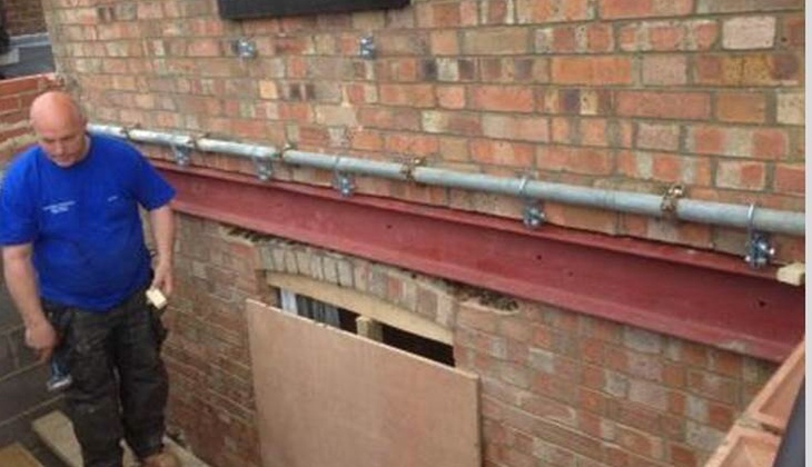

Never understood why people don't put there steels against the wall before propping, nothing worse than having to try and thread a steel through a load of acrows
Got a couple of big 4m beams to go across the back of my house, fortunately down to the builder to sort em :LOL: I did see something called brickbrace that looked quite clever for supporting walls.
View attachment 12238View attachment 12239

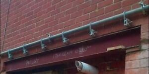

Not sure how I feel about the brickbrace, from what I gather it's just expanding plates inside the perps and supposed to have at least another one a few courses up. Surely it relies on the rest of the perps being full and mortar in good condition, you still have to prop the inside separately, but at least you have a side open.
Did look at getting one of the no more props but just went over board with the acrows and strong boys instead
My Brikkie swears by the brick face clamp things, fine I say when you have equal amount of wall either side to what your supporting but on big full rear openings they just cannot work. Needles everyday for me! Next one for me is a 13m 204x 86UC 😎 cut in half, but I was so tempted to do it all in one!

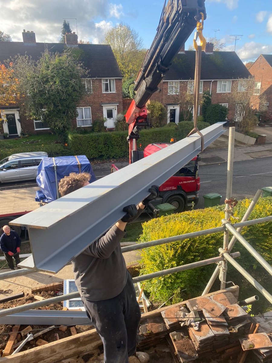

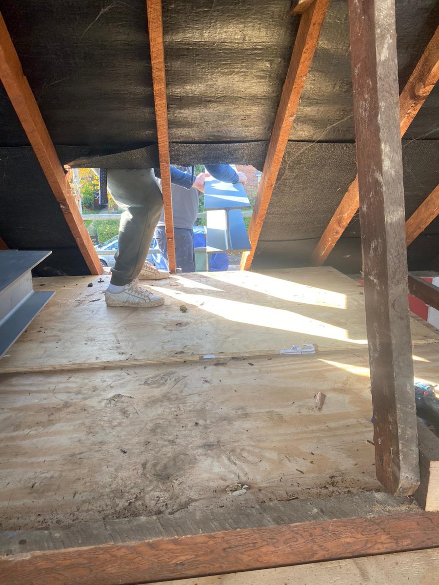

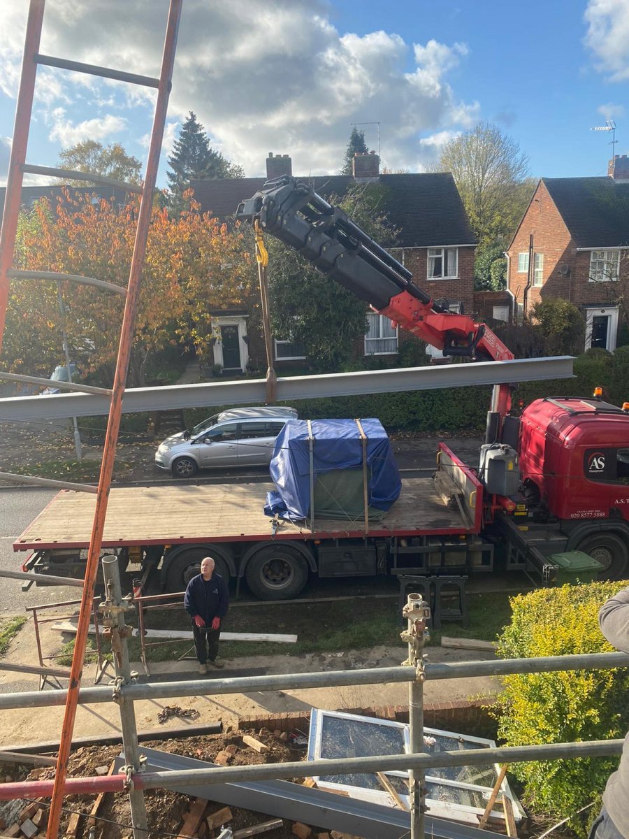

Phone cable and scaffold poles made it a bit tight, crane opwas bang on
