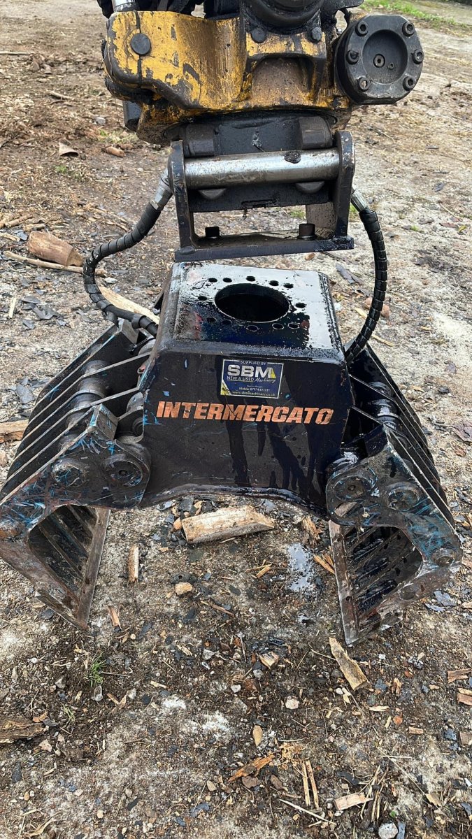

My Intermercato hitch came loose after a couple of hours use (I assumed stretched bolts). I dogged the life out of it and it’s never moved since.
8.8s or 12.9s? ... if the latter, more likely wear in the seating material ;)
Buff the paint off with a stripping disc, and use a decent size Allen key plus a spanner for leverage. And thread lock. Been fine and I’ve given it some stick!
