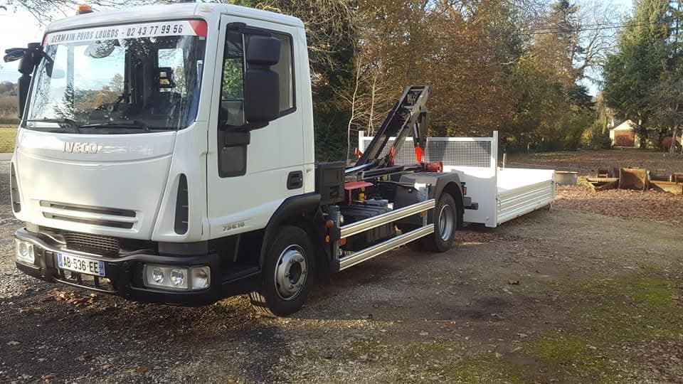

Short version, is there a better option between a 7.5t tipper or a Hook Trailer? It needs to move a mini digger at least at purchase/sale.
I'd like a truck to remove demolition waste from my bungalow as a one man band with no helper.
Trailer: Prefer not to have one
I have my driving licence from 1992 so have C1E with code 107 restriction, am allowed to drive 7.5t vehicle and I believe a max 8.25t GTW.
Is the hook loader is best for versatility of moving a digger, filling with waste, future collecting materials?
I feel a hook trailer certainly allows for more options ie leaving the bed to be filled and still using the truck, for situations of if I did ever use a helper or was asked to remove waste for others.
Does anyone have any thoughts on this?
If you want independence and maximum adaptability get a 12 foot Ifor williams tipper trailer and something that can legally tow 3.5 tonnes (an Iveco Daily tipper is a good option if you don’t need 4wd).
You’ll carry pretty much the same weight as a modern 7.5 tonner (probably more than a hook lift tbh), and they will happily carry a 2.7 tonne digger (but might be a touch overweight from a legal perspective).
In your situation a hook loader sounds ideal. I wouldn't buy a specific vehicle type just to move a digger the once when you buy it though- that's why transport companies exist! Buy the best vehicle for the job you have.

Unless you are going to buy multiple bins then a hook loader is a bit overkill. A set of ramps will load a digger on a 7.5t tipper and when it's done it will carry nearly 1t more. 7.5t hook loaders have very poor carrying capacity. 7.5t lorries in general have pretty poor carrying capacity.
A 7.2t iveco daily tipper will carry 1t more than a full blown lorry. Would also be lower to load and unload stuff.

absolutely ... the hassle is worth the 7.5t all day long ... no brainer TBH -- when I started I ran a SWB Ser. iii and trailer and couldn't get a 7.5 fast enough - comfort and no worries about stopping, looking right, etc. with plenty of guts, loaded
But in general over a single project having materials delivered and a grab lorry for muck away is going to work out cheaper. Especially when you take into account your own time doing transport related roles. How close is the place you want to take muck away and collect materials from? Half an hour each way very soon becomes half a day
If i had to choose between 7.5t hook or tipper id go hook - mine looked happy enough with 5t in tbh and much safer than pickup and trailer with 3.5t in it - but 5t was somewhat overloaded :)
hate pissing about with trailers after years of them but will prob go back to trailer in semi retirement as its handy to have a motor to run about in when your not needing to tow.
What's the capacity of the 7.5t Izuzu or Fuso think they are quite high?
They are only a couple hundred kilos lighter than a daf or iveco. From memory they can collect about 3.2t from the tarmac plant. As opposed to a daf lf 45 picking up as little as 2.7t depending on the body.

Well since my initial post, I think that I agree on the 72-180 Iveco Daily might just be perfect, I didn't know ramps would be a safe loading strategy though, so that help.
Have you any idea on the perfect length for an iveco daily, I wouldn't want these sliding off half way up, I presume they attach securely?

Most ramp manufacturer websites will have a length calculator on them that will give a length dependent on bed height. It will be somewhere around 3m. Make sure you drill the top of them and a hole in the bed so you can drop a bold through when in use as they can walk of the end of the bed otherwise as you use them. Not fun if you are halfway up.
