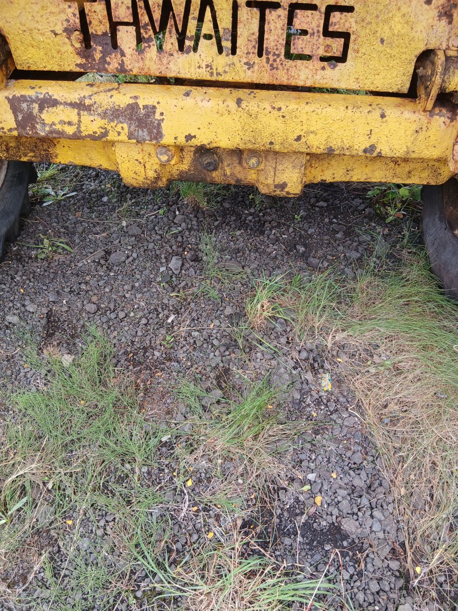

I am trying to sort out oil in the front axle. There are two hexagonal plugs and a slightly lower hex socket one. Am I correct in saying there are three separate sections, all to be filled level? Outer two with UTTO as it has wet brakes and the middle with EP80/90?

Thanks for the reply. All other car axles I have worked on are as you describe. If you look at the picture on this one you can see three plugs on much the same level in addition to the drain hidden underneath. Is the axle divided into three sections which have to be filled separately with these plugs also being level and fill?

I think you’ll find those bolts either side are locating bolts for the reduction gear in the cases, serial or Mach number would help

Sorry wrong dumper, yes the two bolt head bungs are the fillers the large grub screw with 14 mm hex is the level and obviously the bottom one the drain.

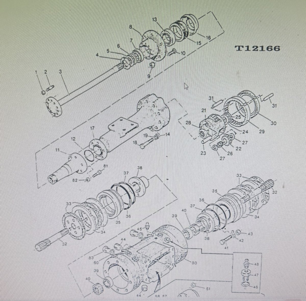

I think this might bee the parts drawing for your axle
Smithy
The drawing really helps thanks and I'm sure its the correct axle. I think the dumper is a 1992 going by the reg, will see if there is a plate on the axle. The rest seem to have corroded off. I don't understand why it would have two filler plugs unless the axles are sealed from the diff, are parts numbered 36 o rings?
Gecko
Gecko
I've never seen one, so just going off the drawing, but O-rings 36 & 37 are probably brake seals (?).
The main seals look to be 30.
Three fillers / chambers makes sense with a reduction box each side, but only one drain plug? Perhaps one of the bolts (18) doubles as a drain?
