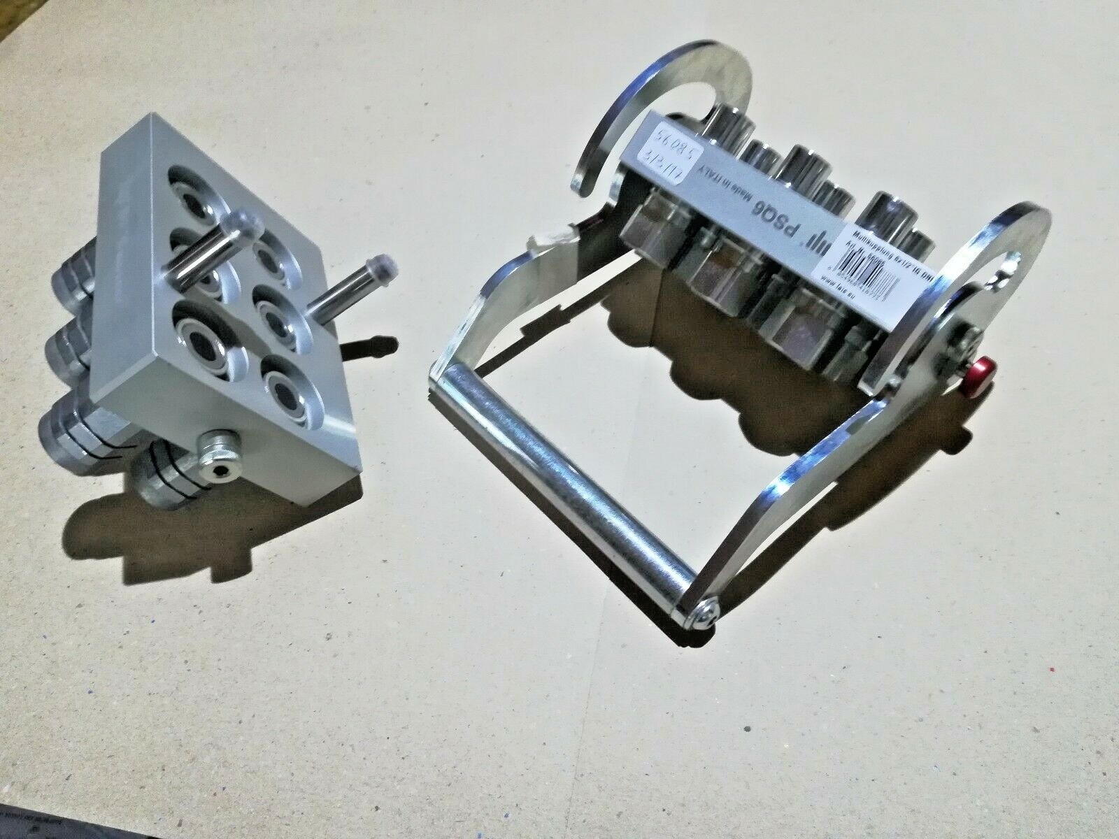

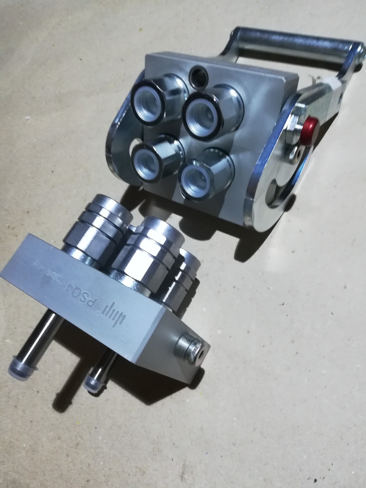

@CPS had a quick release block (similar as fitted to Avants) that you could plumb in to replace the flat face fittings on your machine - it joins multiple services together at the same time with a cammed lever. It would be good for regularly mounting/removing a tilty, but would need several setups fixed to your various attachments to really make the most of it (which I’d imagine would be expensive!).
and these are cheap ones :oops:
and single 'halves'
6 way jobby

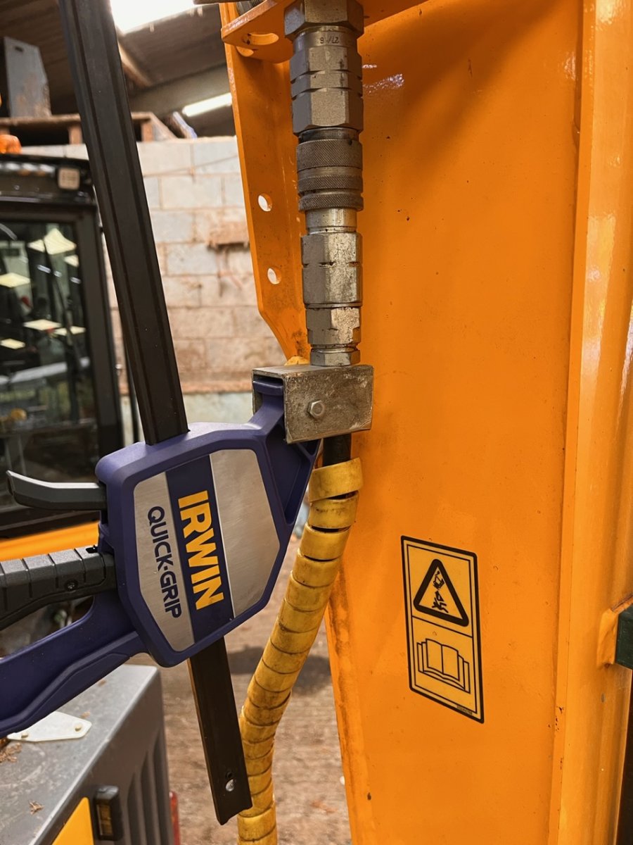

15 quid and a bit of thought
what size hose fittings do you use that on ... very neat ... I'd considered doing something similar, but as said - rarely have issues as the 'Drema'll dump pressure very easily ..... could do with that for lil' jake and the Haner's 1/4" FF couplings though... tight together and can't get your hand around them :rolleyes::(
We also use these Q/Rs with build in pressure eliminator. Seem to be a great job also.
ISO A,s rarely give pressure issues anyway ... it's the FF,s that're the bar stewards ... once you slide the collar back on the A,s those balls're gonna let go - end of
normal 1/2bsp flat face

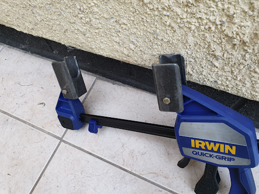

Well it works, could probably use a flat ‘U’ shape welded on the top one and just place it over the support bracket. Just need to cut back all the hose wrap on everything so it fits nicely .
I’ll await the official @V8Druid version he’s now going to make in the hundreds for everyone 🤗

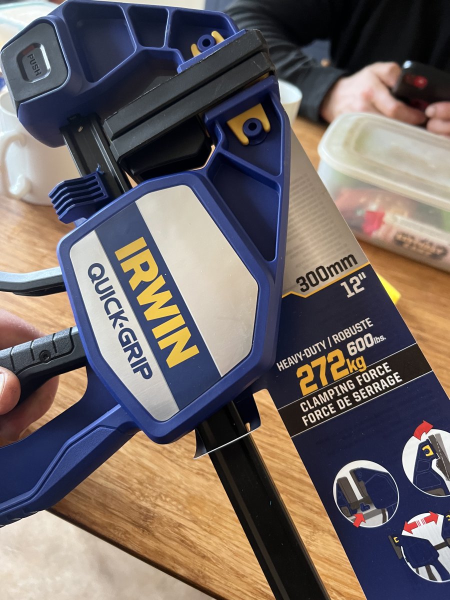

what's it like at coupling up under pressure ?
Not sure, it’s a 250kg clamp so they have some power behind them!
I tried it on the machine as it sat there for over a week, hadn’t been depressurised and it put them on no probs.
pretty sure the clamp I bought a while ago was the same .. will have a look later .... I do like your design ... simple and effective, as are all the best tools (y):cool:

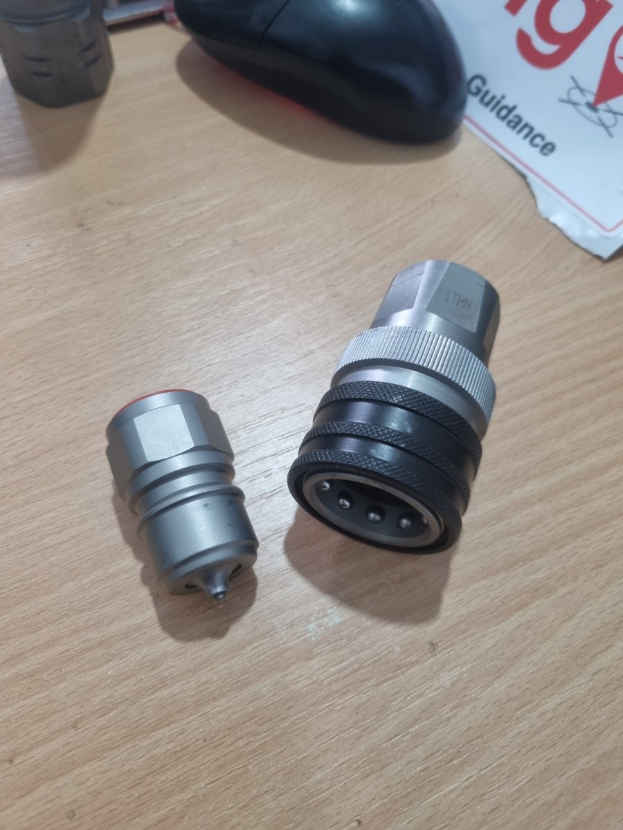

These aren't ISO A's;) they are the Nordic style couplers.
ISO A's Will give pressure problems too, you may be able to open them under pressure slightly better, but try getting them back on after the pressure is stuck in them?
These do away with the problem, so far so good
look for all the world like A,s .....
what's the difference??
and yeh a pressurised A is as much of a bitch as an F/F to couple up :(
