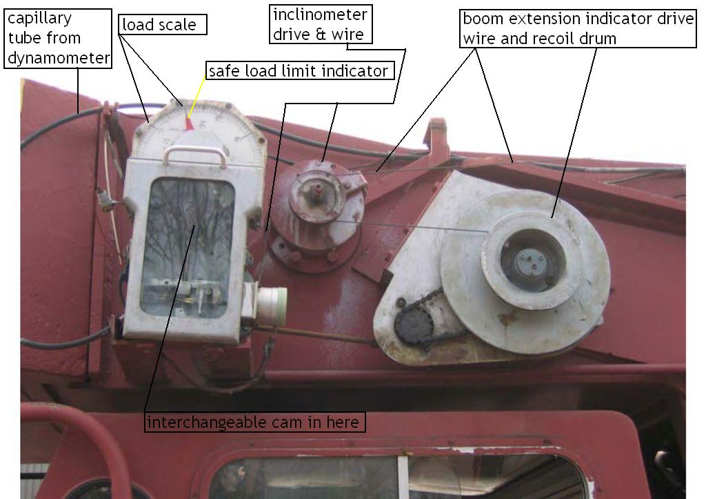

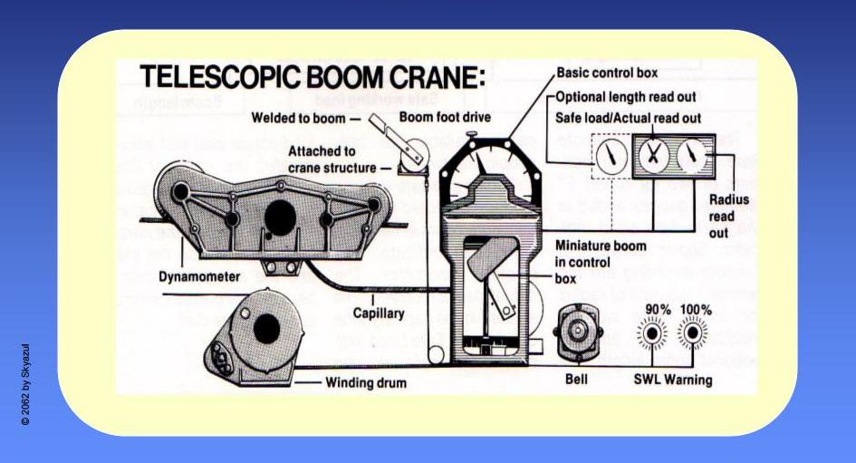

when you travel it, it will ride and grip much better with the boom to the rear and tail weight over the drive axle .... I have a LOT of experience with the Weighload systems and used to maintain and calibrate my own ... even to the extent of replenishing load cells with new bladders and meths ... the capillary tube is the usual cause of most faults .. they crack .... if the outer looks dodgy the inner will almost certainly be foobar-ed :cry: .. deep pockets required .. should have a full workshop manual for the Saphire ... somewhere .... perhaps two ;) .... will have to dig them out

Loadwise length on cable reel and boom angle sensor internal in reel apparently.
Thanks. Manuals really appreciated. I can scan and return with a pdf. copy via mail or CD or pigeon...
be a new one on me .... there's a sodding gert Zebbedee inside that reel ... angle sensor is usually a grooved disc at the pivot point of the boom and a cable transfering angle of dangle either direct to the Weighload display unit, or via a stiff bowden cable or ribbon and ball type cable (who's name I can never remember - could be Teleflex) type set up
the reel gives the degree of extension on the tele and the load cell in the dynamometer rollers is connected to the indicator by the capillary tube i mentioned previously ..... plus you need the right cam in the display unit .... will deffo have two, maybe more -- one for manual in and tele only ... one for manual out and tele ...... without the correct cam in place for the configuration it's as much used as balls on a nun
put some pix up and i'll see what you've got

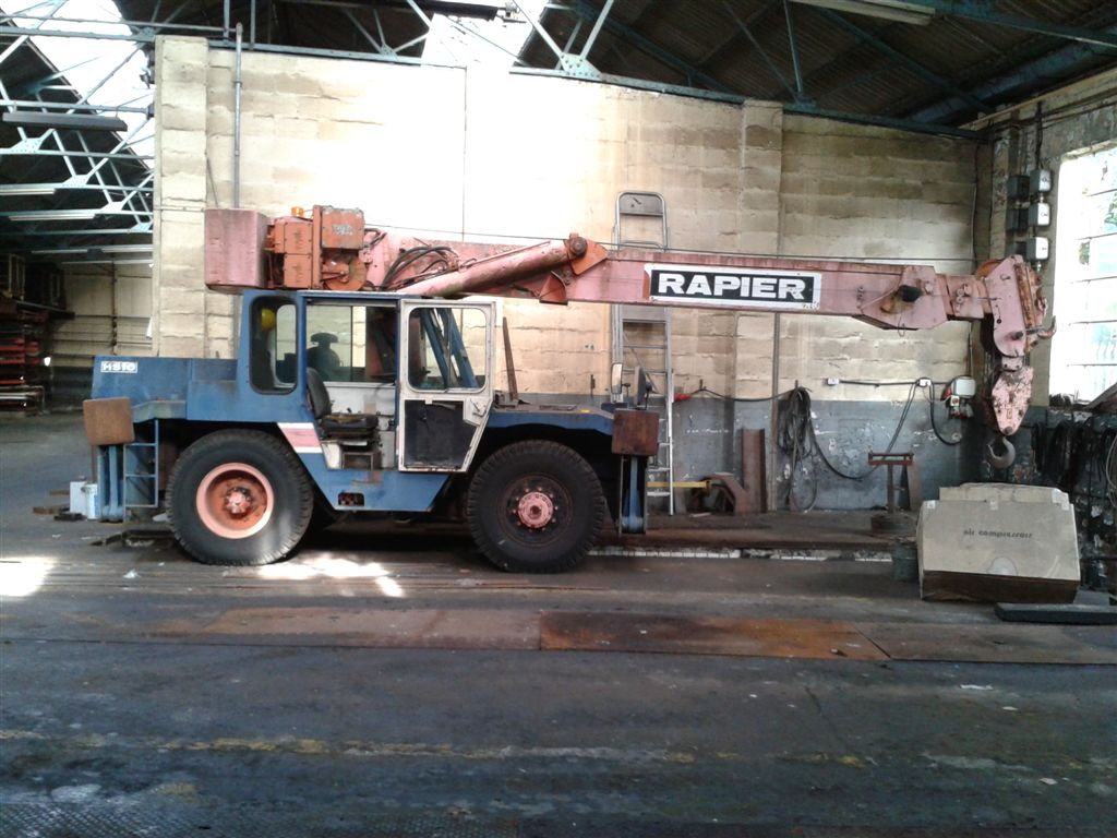

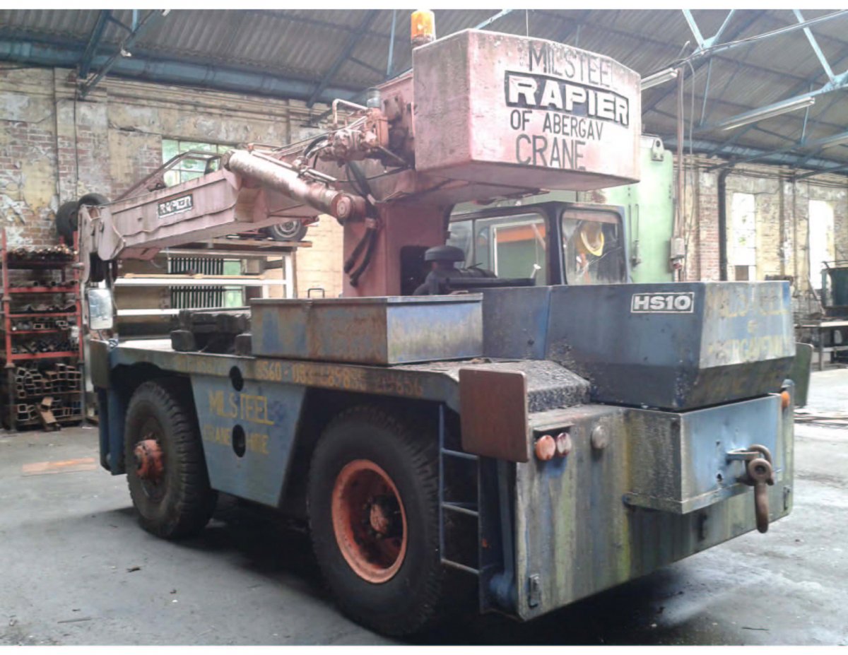

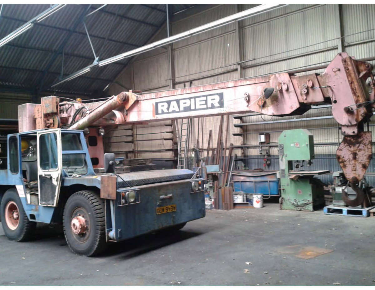

me Rapier had a Wylie system and that was a right sack of worms :oops: :( Weighload's much easier to sort

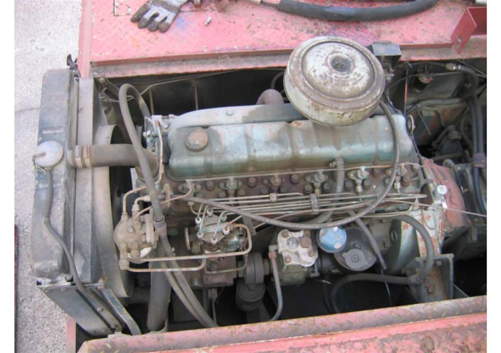

....... It's a 6 pot but embarrassingly haven't had time to check motor. Ex MOD, was expecting Ford but looks like a Perky picture I've seen, maybe even yours.
6354-NA Perky lovely motor

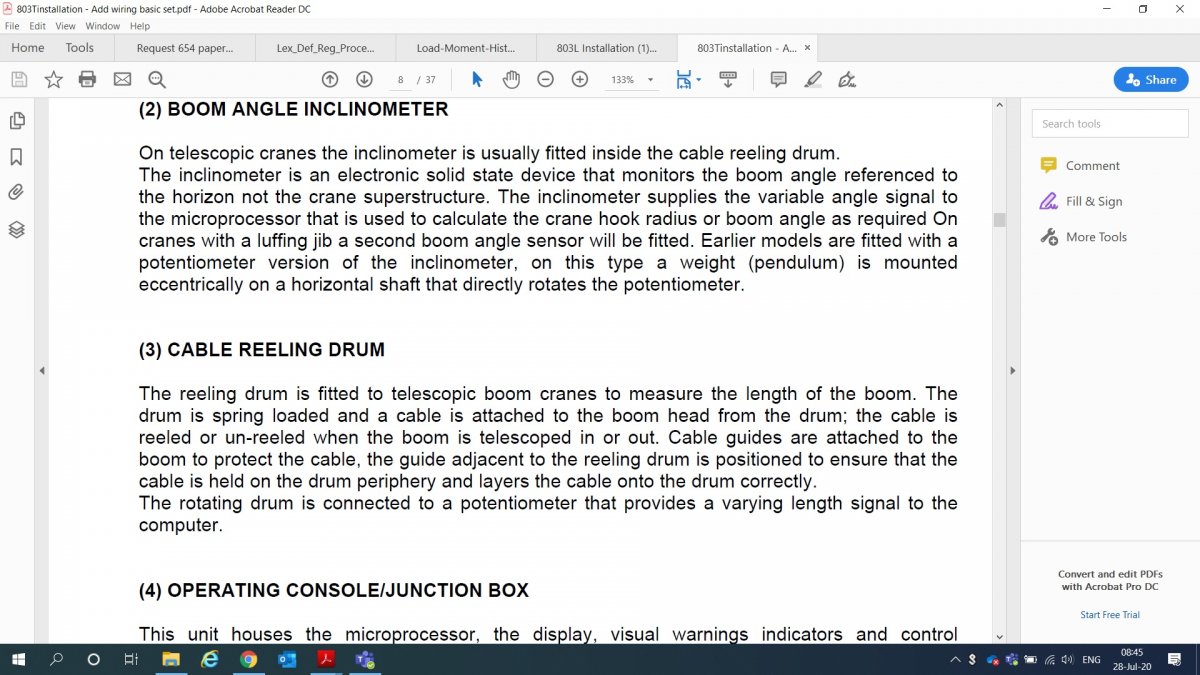

Loving the load moment history doc. Away from crane at the moment but have grabbed this from the Loadwise doc. I managed to get hold of
I will look at this when I get back to get some more photosView attachment 17084View attachment 17085

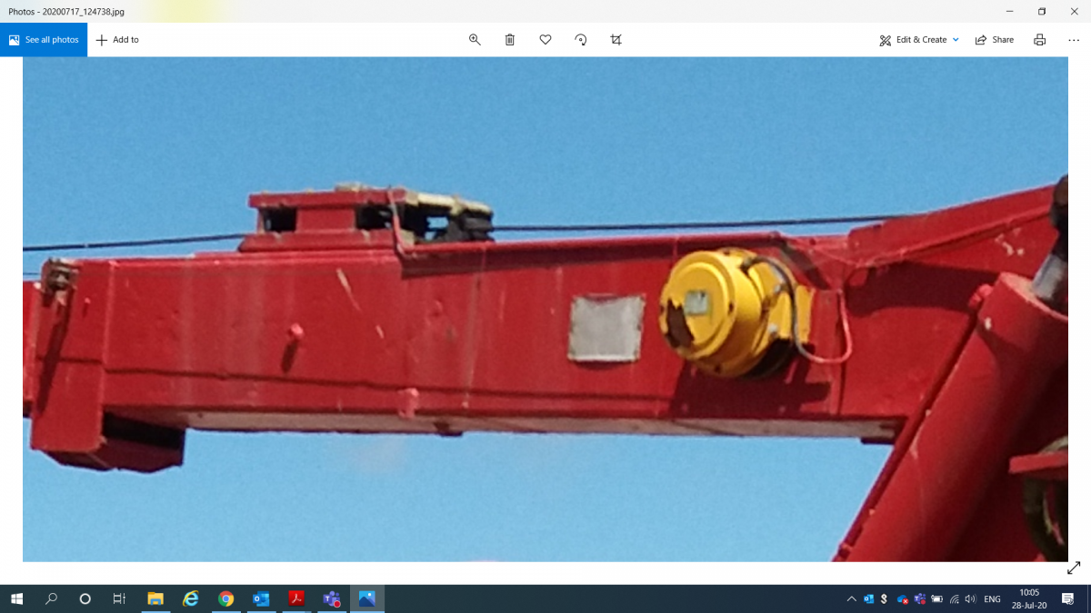

that's a modern solid state electronic unit ... not the old mechanical system ... they're on the boom base pin as per the pix last night and cable operated
