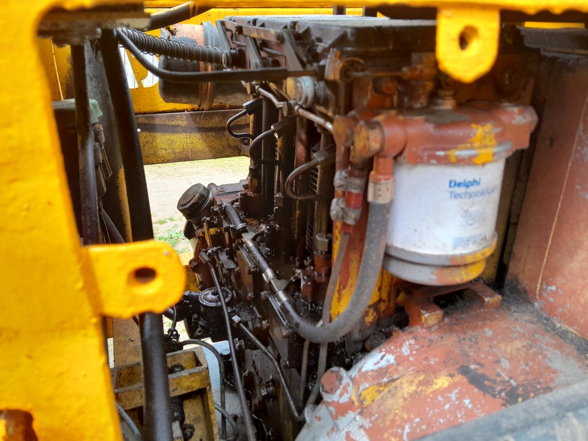

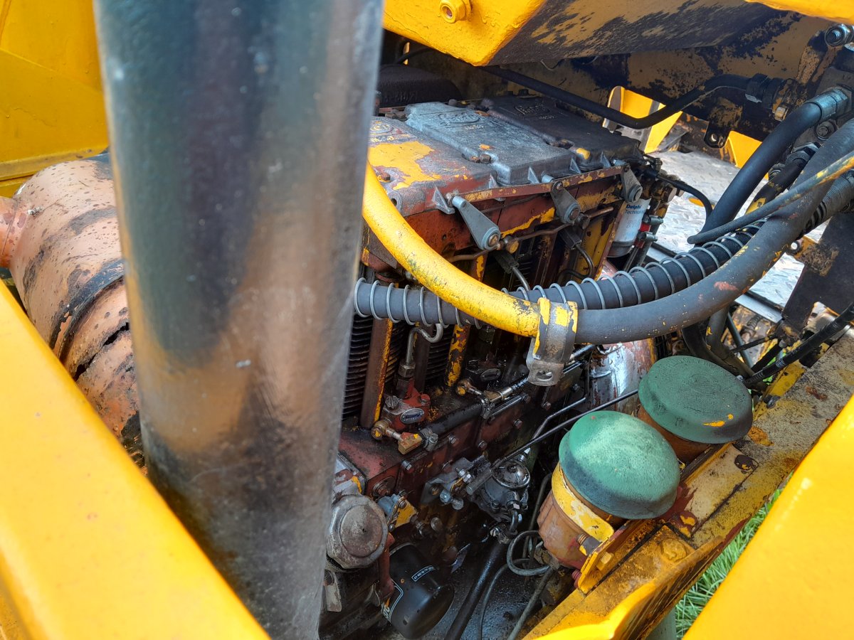

Hi To All. Whilst I`ve gleaned a great deal of information/advice from this forum over the years I`ve finally taken the plunge and am introducing myself here. I`ve always found forums to have been a fountain of knowledge readily provided to those in need. Whilst classic cars are my hobby I`ve also have a elderly Case 580K,a Bobcat 323 and Case 895 Tractor and and a Lamborghini 600 tractor all of which are/were used over the years in my building business and because I enjoy getting covered in grease and oil ( fellow members will understand this fetish I`m sure!!!) Anyway so "flannel" over I need help with a Benford 3 ton dumper I`ve acquired. It`s got a Lister 3 cylinder engine which is throwing out oil from a pushrod tube in the middle pot. My questions are where do I start, what manual is available and finally is it an inevitable can of worms?? Hoping for help.

How old is the dumper, which engine? Photos? If it’s the engine I think it’s not a bad job, just orings

Hi Mick. It's 1985
Air cooled 3 cylinder, there are o rings on the push rod tubes, the centre pot always gets hotter and over time the o rings get brittle and leak, you can removed heads separately to replace the o rings but probably better to do all three!
