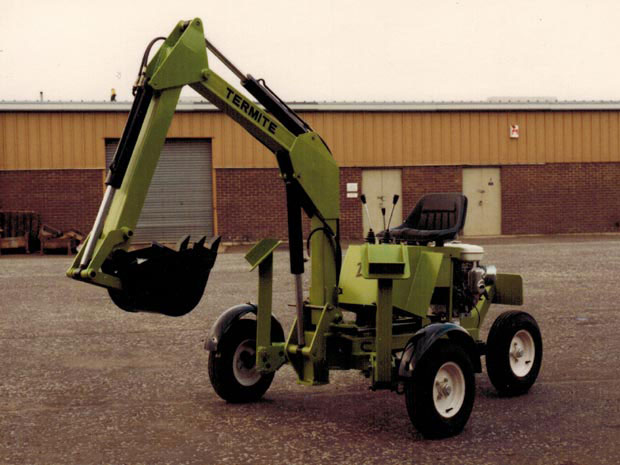

Yes Termite is pretty when new, not that I got it new, had it over 25 years now and and still going strong. Needed frame welded up and reinforced as was cracking, and pin breakages have been a problem, but is really simple and with 5 identical rams for the actions, it is as easy to fix things as you can get. Has a plug in towbar so can be pulled by a family car, but as everything is just pinned together, there is so much play that anything over 25mph is asking for the thing to start dancing. Fortunately it fits my box trailer.

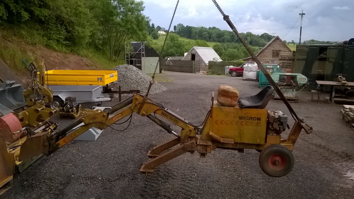

the little walkers are quite amazing at what they'll do ... mine has moved some stuff over the years ... have had it since '92 and gotten through some pins and bushes in that time .. in the wrong hands it wouldn't last long ..
same as yours .. all rams identical
very powerful for its size
quickest way to move it ... pick it up and chuck it about :ROFLMAO:

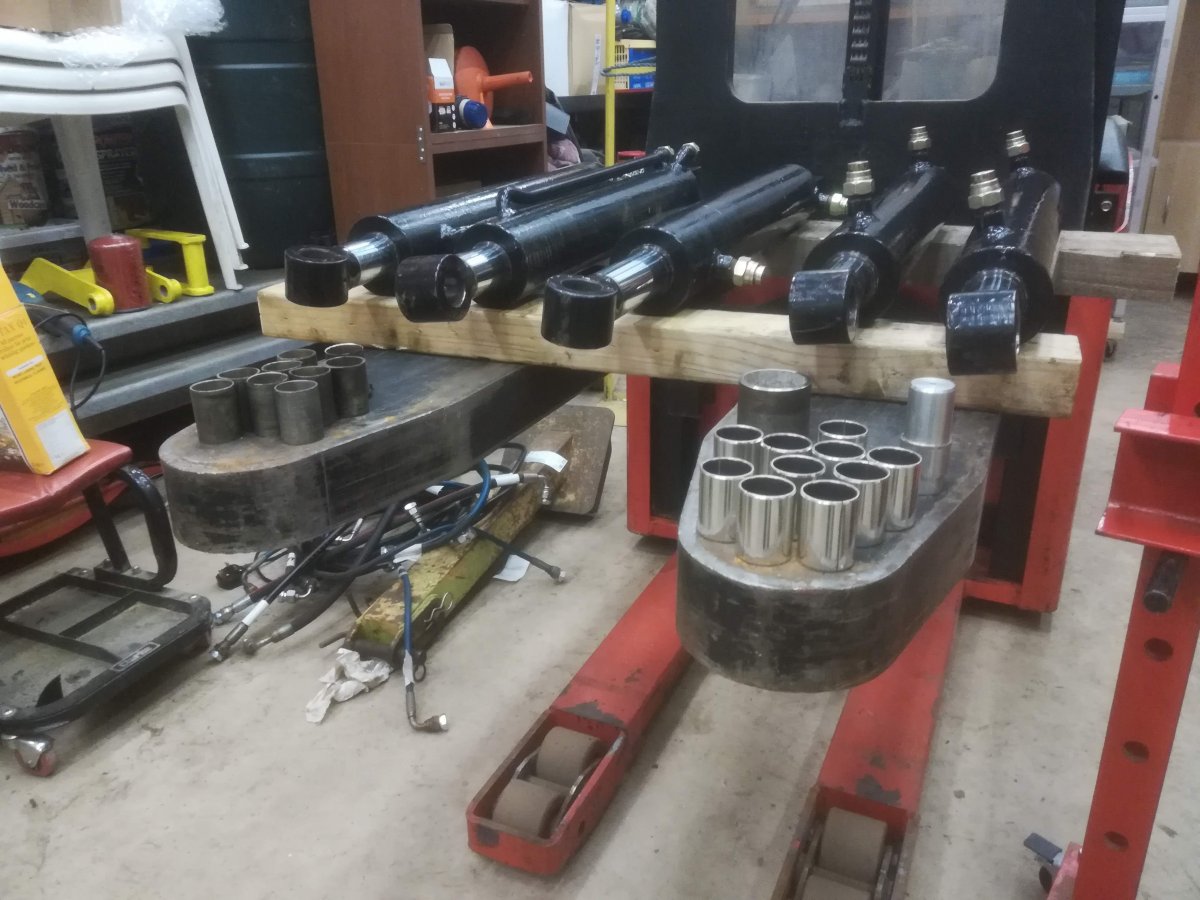

Agree with pin problems. I had all out in 2018 and re-bushed everything. Also came with a Hyd PTO and a breaker. Breaker is HEAVY for one guy to hold but is effective when working. Sadly it is a bit reluctant to work all the time.

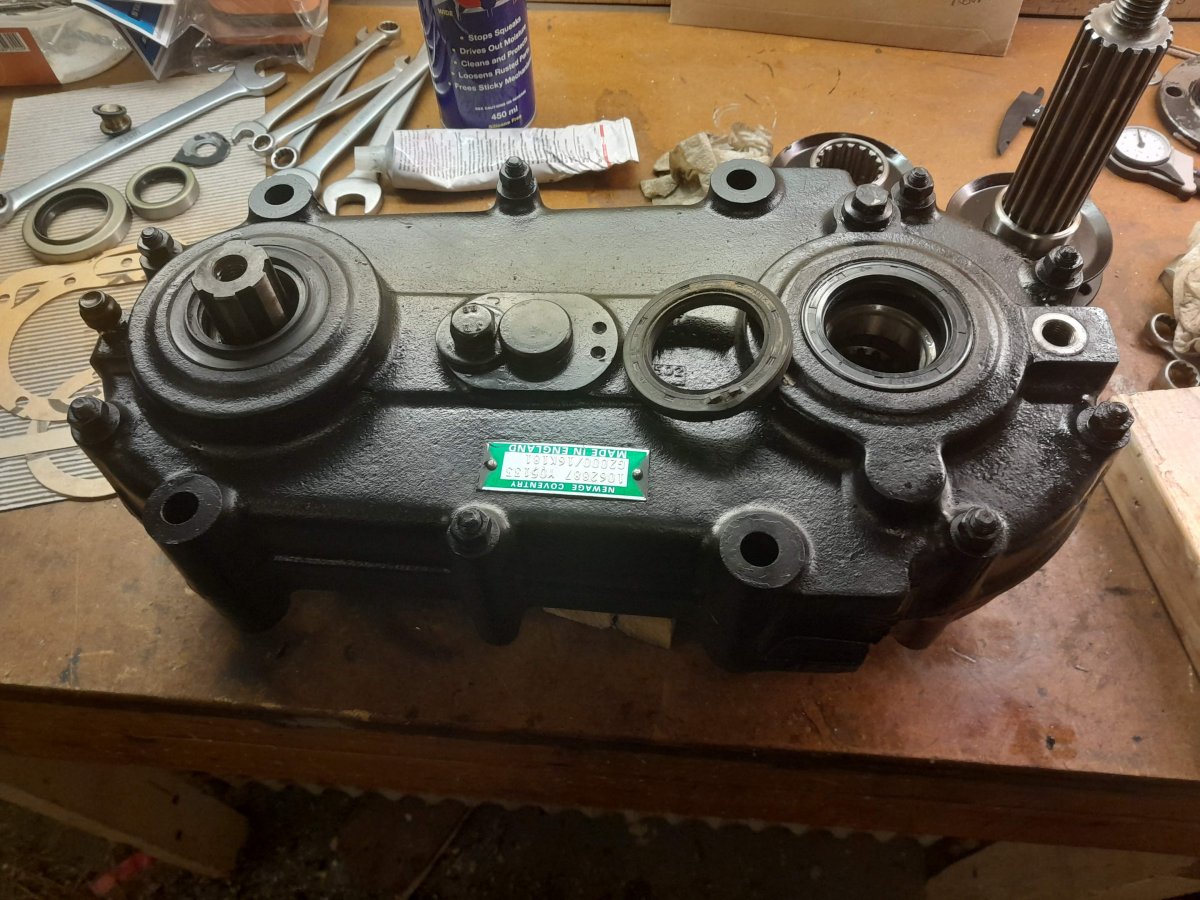

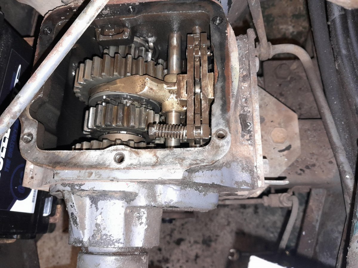

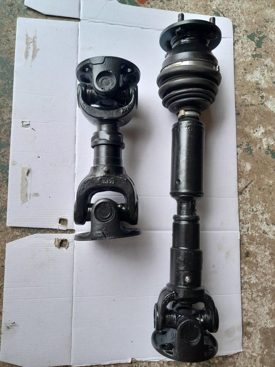

Hi again,
I suppose old machines need more care, and what started out as oil changes has grown legs.
Gearbox needed new output seal and I discovered a new interlock plate and gearstick lock plate. Dropbox had a weeping seal, so that's all of them done now. Serviced the propshafts while they were off, and am currently in the middle of renewing all the axle / brake drum seals. Stupid bleedin' design that is.

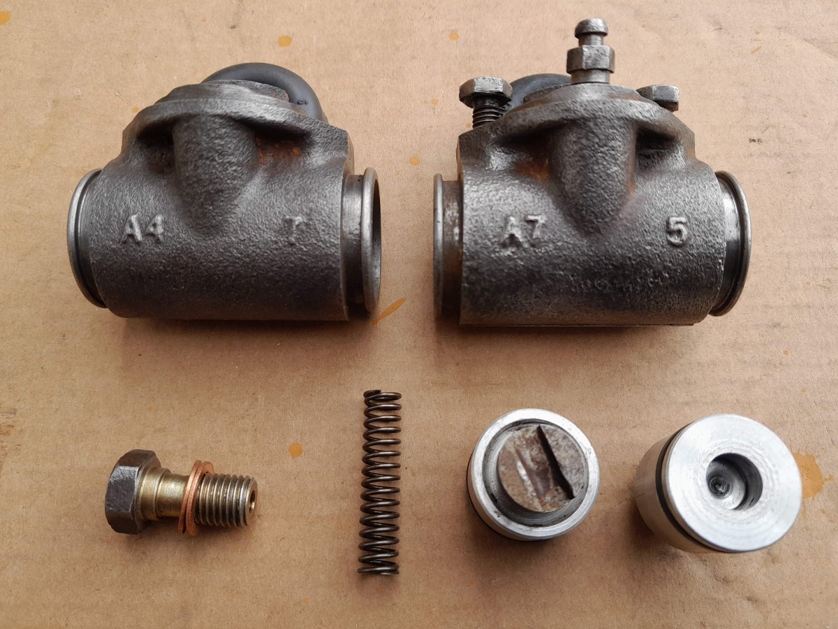

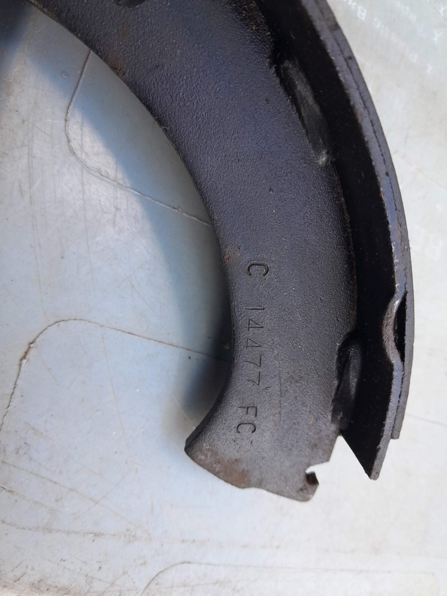

Am really struggling with the brakes. Being French, I think that would have just used something standard off a Renault or Citroen or something, but I can't find anything anywhere. I can always get the shoes relined, (Shoes have the code C 14477 FC stamped on them,) problem is the wheel cylinders. I could do with seal kits for them all. Costs have gone way past what I had initially considered so I'm trying to get things at a reasonable price to complete the work. I've posted some photos of things and a pdf of the cylinder parts with sizes.
If anyone can point me in the right direction I'd appreciate it. (If anyone wants details of seal sizes used so far, let me know..)
Cheers Cam
