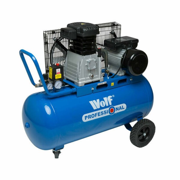

I have the same thing from SGS- it's been good, belt drive is a bit quieter than direct. Previously I had two direct drive Wolf compressors and joined them as you suggest- however the belt drive runs to a higher pressure, so regulated down again from storage pressure you get a lot more usable air. So think I'll stick with one and a secondary reservior as needed.
absolutely .... the direct drive are much noisier and if the motor dies, a PITA to replace ... belt drive is / always was, much better (and runs cooler generally) .... and can be wound up to 150PSI quite happily

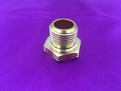

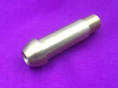

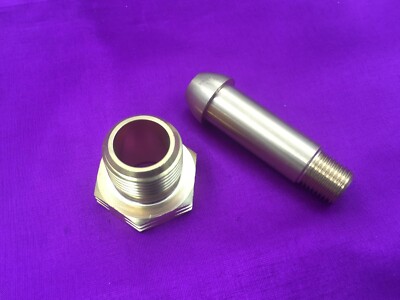

to connect them simply use a LH threaded std stem nut and stem with a PCL attached to the stem ... male to male lines will let you plug as many as you want into your system (and enable you to take the tank with you to site if required - seem to recall you already do that with a B o cee tank ;):giggle:) ... job did (y)
