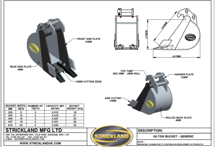

I got a 600mm Strickland bucket and It does seam a lot better made than the rhinox ones.
I hardly use the smaller buckets now it's either the grader or the 600.

Hmmm the only bit specced for the e10 is pins at the top you could argue bucket size is up to you to decide. To be fair they should advise and know which you'd need
Yes, but there’s a big difference between a 50-something(iirc) kg bucket and a 32kg bucket at reach on a micro. Maybe was my fault for not asking the weight🤷🏻‍♂️

It Looks like Strickland or bmc might be the way forward then! Anybody had any experience of digbits stuff for the micro? Cheers.

the e10/dx10 and also the tb210r should easily handle a 50kg bucket, mine handles the 900mm dx19 bucket over the tracks at full reach with no issues, there is a pic on another thread somewhere.
With all the stick that whites get, the buckets seem well made, as mine have had zero issues, no dents/bends or broken teeth
It handles it but it’s bloody cumbersome. It’s not about how manly your digger is lifting buckets a size to big for it, it’s about being precise, neat and efficient for me.
You say no issues, but the issue is that it’s working twice as hard as it needs to and it’s far harder to be precise. Uncurling into a dumper is more of a pain too, with the longer bucket lip- it’s a chore as it is with the e10s limited lift without making it worse.
It’s worse when actually digging though (foundations in clay in my case)
It's not just that i often find with micro digger you're tight for room, perched on an edge or somewhere not exactly guaranteed stable and as doob says loading something small extra unnecessary weight is best avoided.

I sent my new set down the road with the old mini, and the new mini is still running the five year old Strickland set.
Strickland used to make JCB buckets I believe 🤔 I used to sell quite a few sets of strickland buckets over here .... not sure they manufacture their own any more ?

I've seen some pics recently of Strickland buckets for 13ton 360 and bigger and looking at some of the welds they won't get my money.
