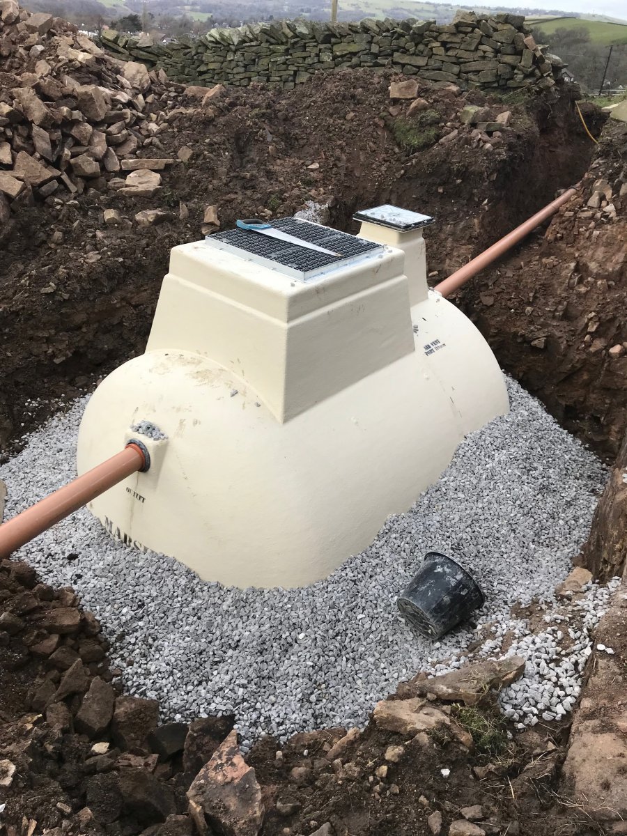

Replaced loads of them! I’m guessing this is a in-tank version? If the condensation doesn’t kill them it will be when the soakaway backs up in heavy rain , filling the tank up and obviously ruining the motor! All the new marsh tanks finally have a external compressor.
Only takes foul this, roofs go to 10k litre rain water harvester and surface to another big tank that settles then cross feeds into rain water or overflows, complicated 3 distinct sets of pipes and chambers but could be condensation. Separate blower wasn’t option on this as in field with horses and didn’t want fencing
Yeah always a separate system, but with the rain we’ve been having lately I’ve seen many tanks filling up backwards via the soakaways which are flooded out.. the only real solution is to get the compressor out of the ground and fence it in, or they will have to accept a new compressor every few years..

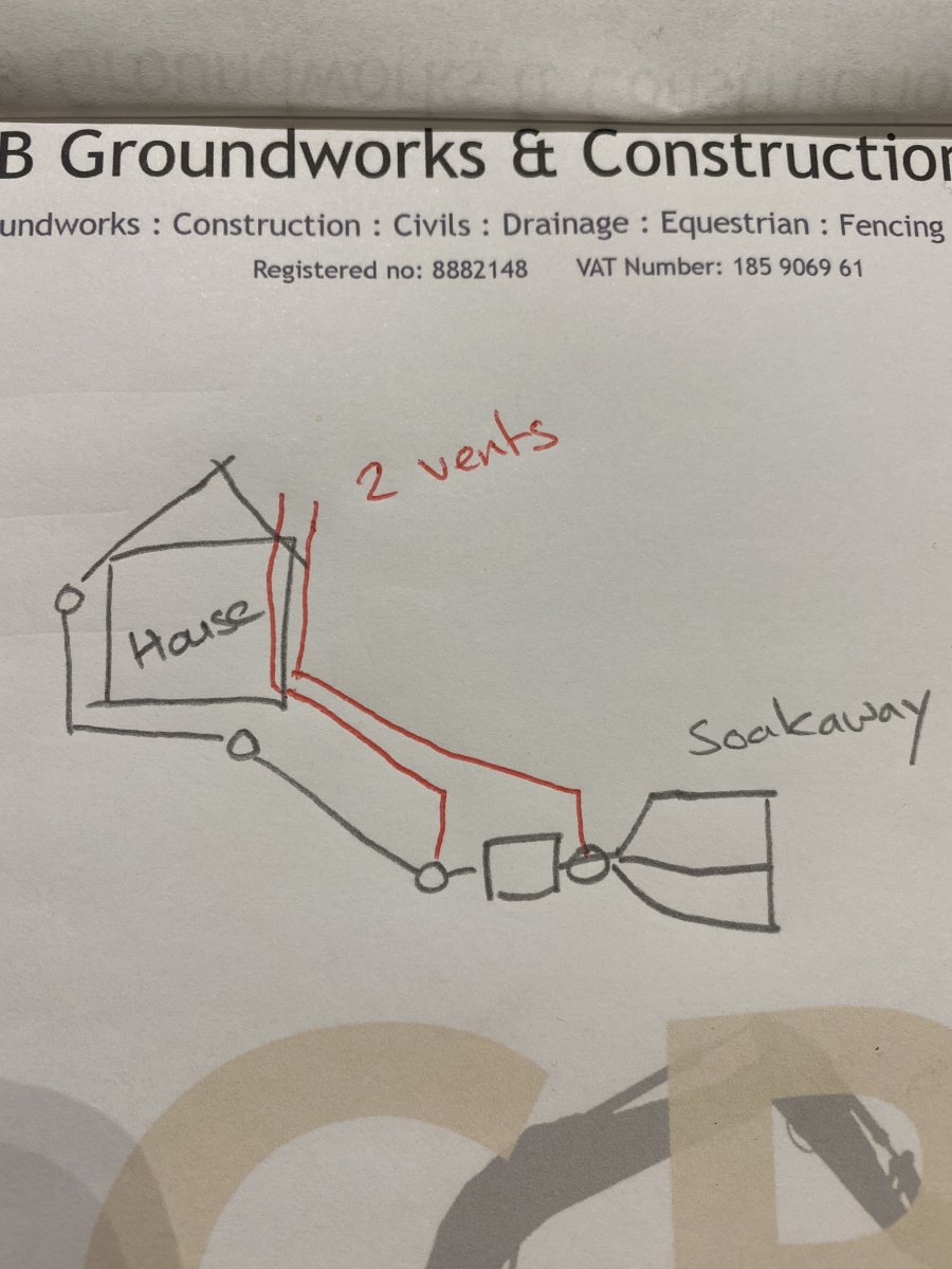

Like this?

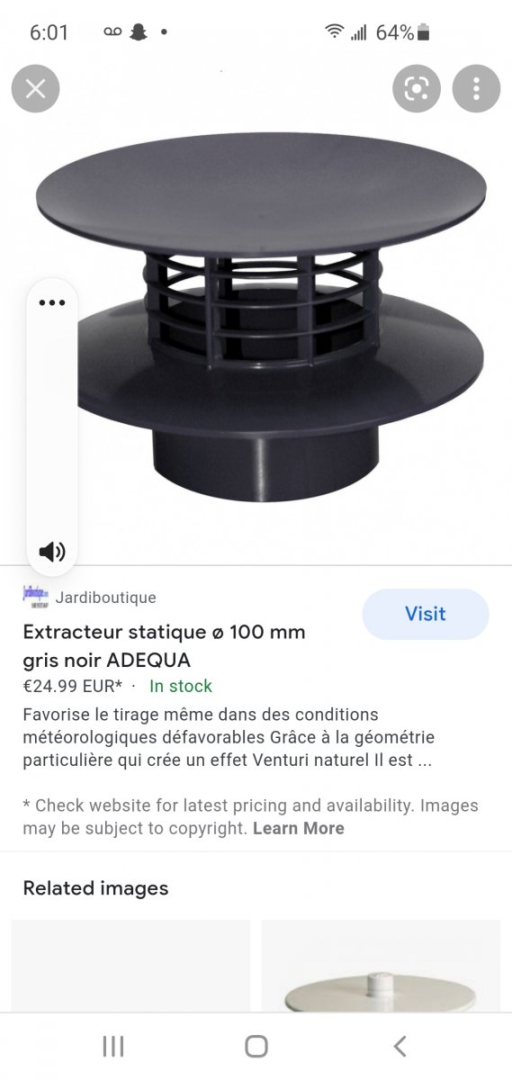

Yes like that ,with the house side of vent as close to house as possible - lots of houses already have a vent on internal pipework, existing through roof and with a mushroom on or on a soil stack,but if there isnt one then we always add one to ensure à Circulation of air so the system performs better with less odour, if its a concrete tank or system it helps prevent the premature rotting out of the concrete.... I've seen them rotted out in a few years if they are not vented.
House side gets à mushroom and after tank we put a top on like below .... acts like à chimney to draw air down first vent house side, through system and out the second vent.
