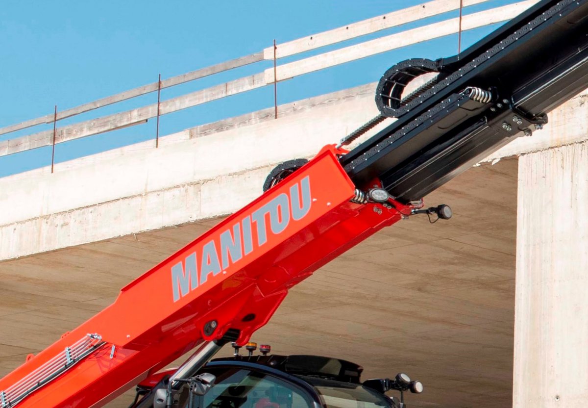

Do you mean for the aux hoses to extend like these here?

Not sure whether you mean the plastic hose carriers as mentioned above or the large metal chains that pull the middle section of the booms out.
I'd guess he means the lacing chain above the hose chains @Giles ... commonly used on mobile cranes too

Yeah I've seen it on many machines but thought it was an old idea until I seen the new Manitou MT1840 machines. Thanks for that guys. Very helpful 👌
