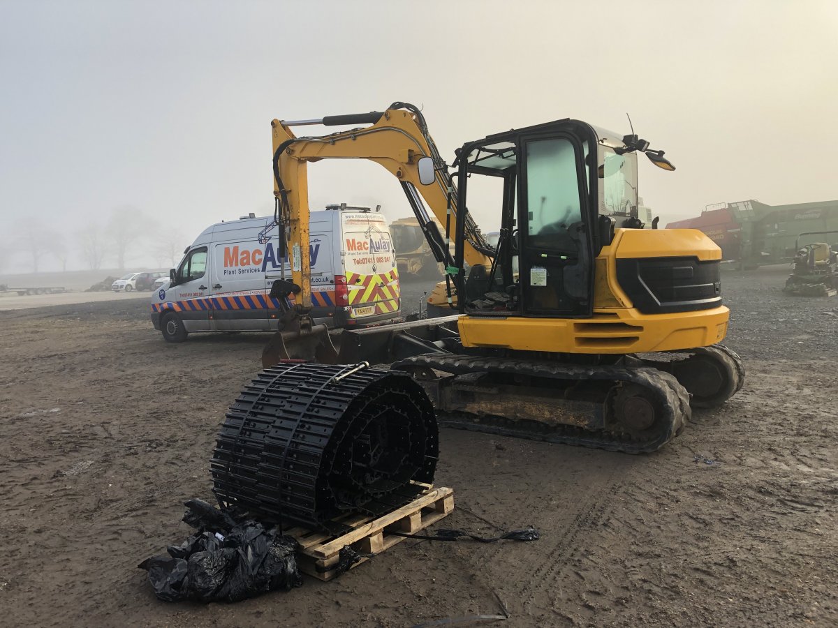

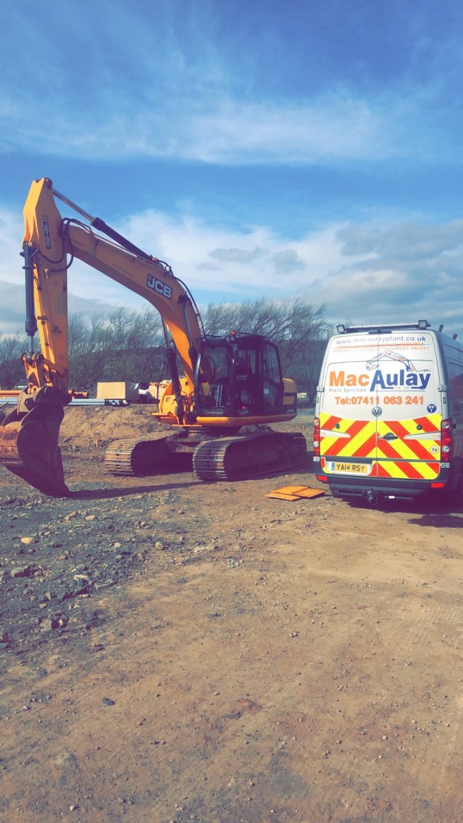

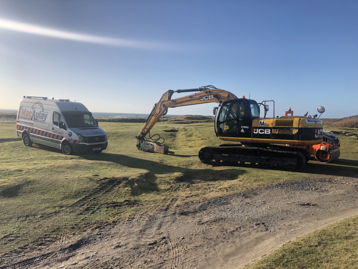

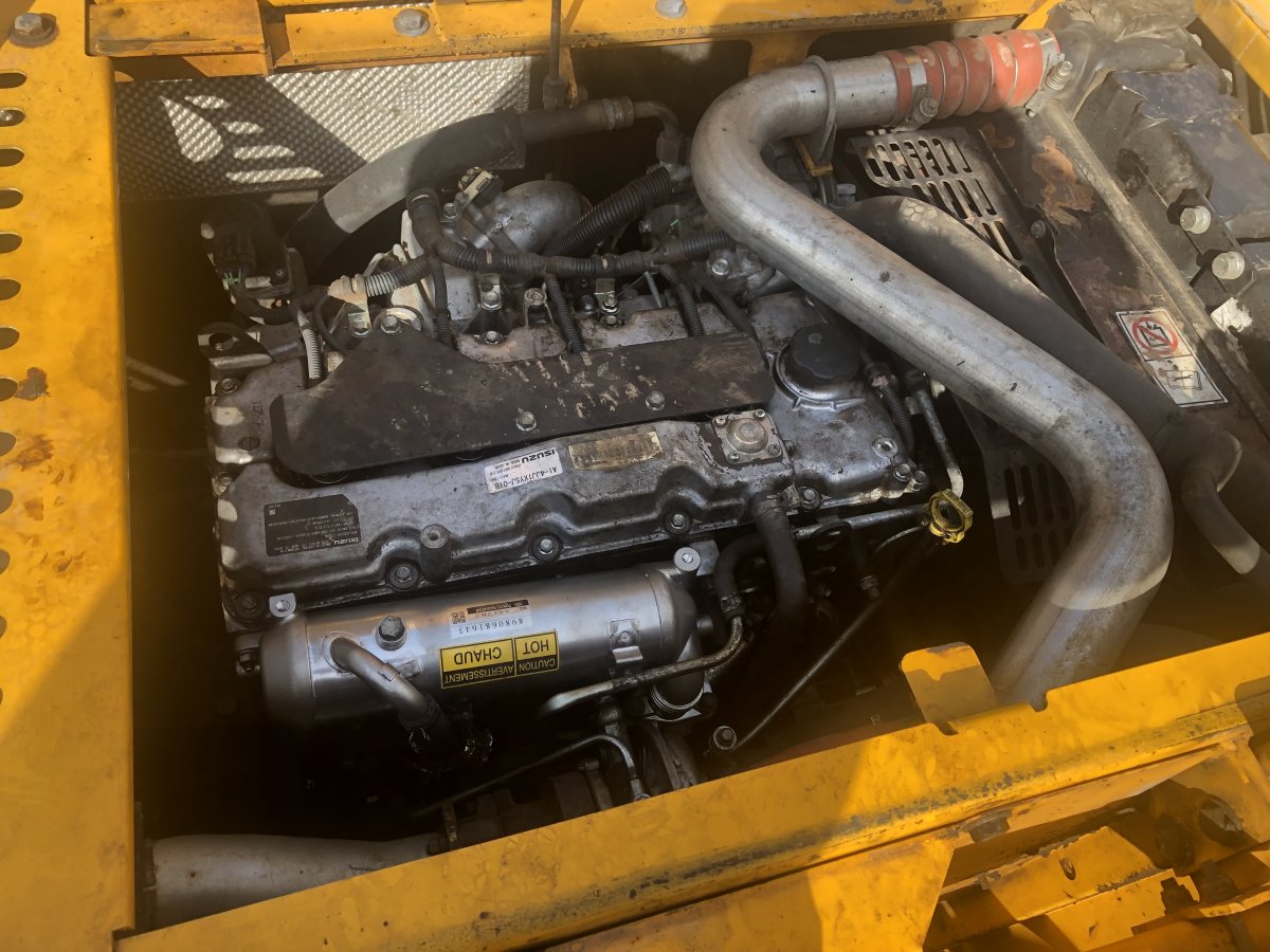

Day trip to Sanna Bay for my uncles Js220, non start fault, had to get jcb out and plug laptop in, think it’s time for some JCB diagnostics

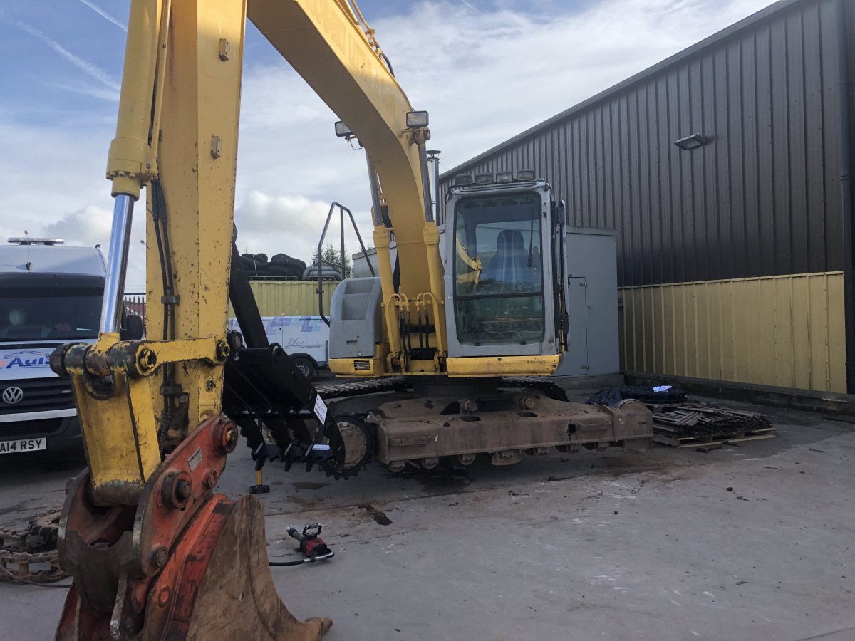

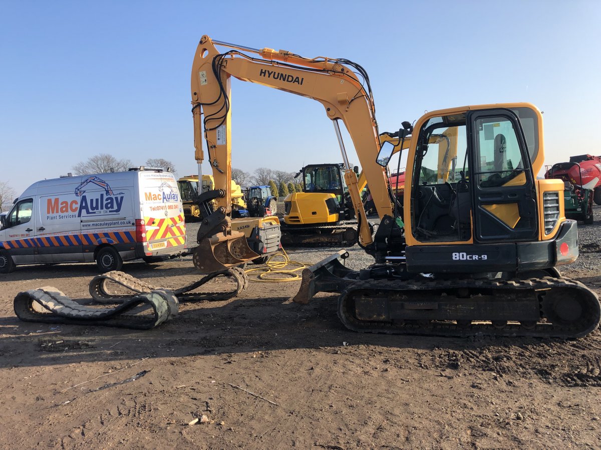

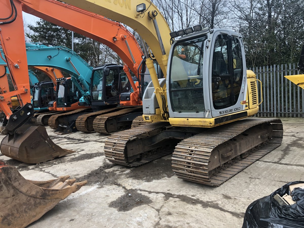

Another bunch of machines in for undercarriage swaps

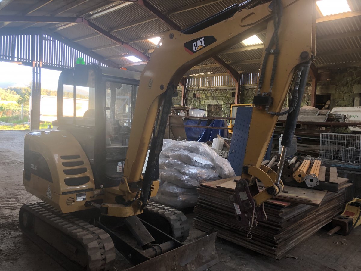

Quick check over make sure everything’s working, and new hoses and sold to Bournemouth

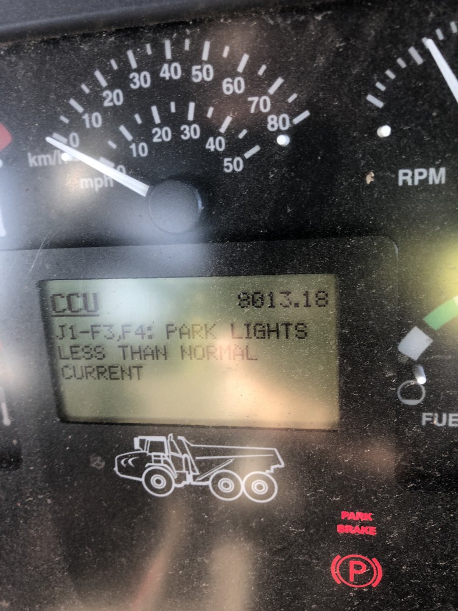

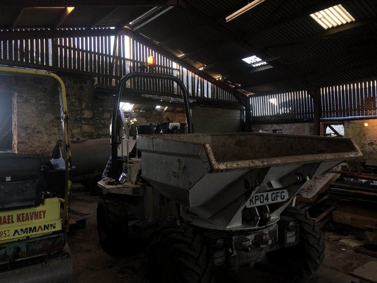

Bell dumped with electric gremlins, burst bulbs causing it lose its brakes 🙈

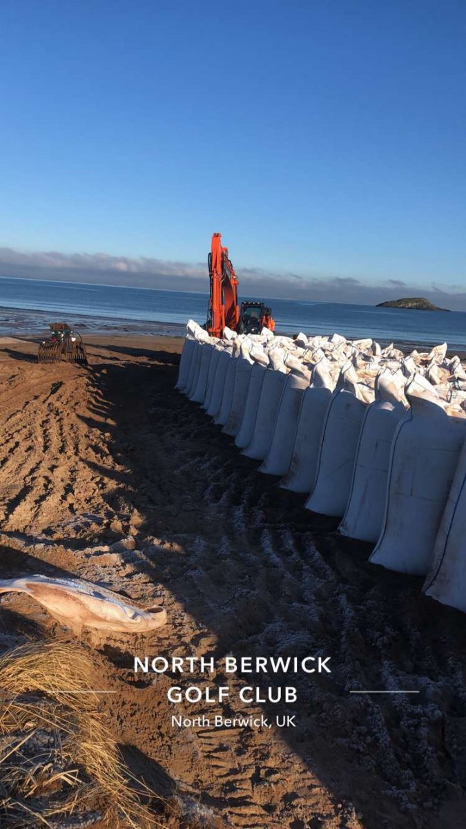

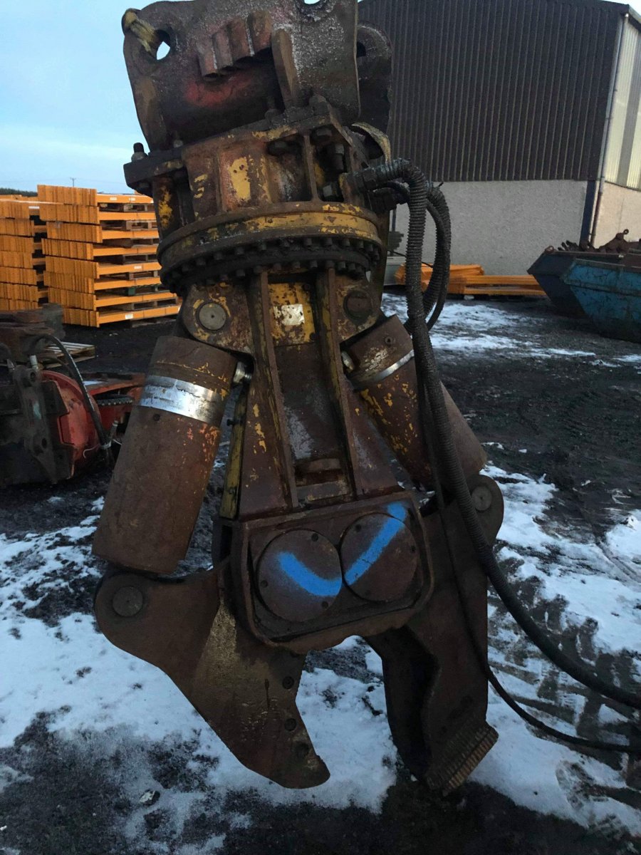

Grab inspections for a customer in north Berwick, grab condemned and removed from suit and returned to supplying retailer!

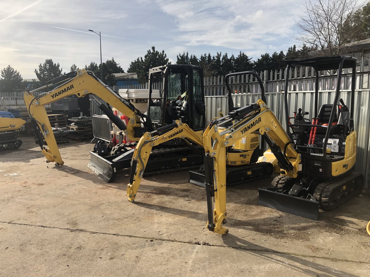

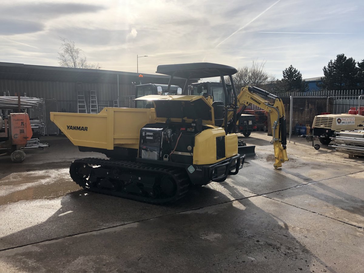

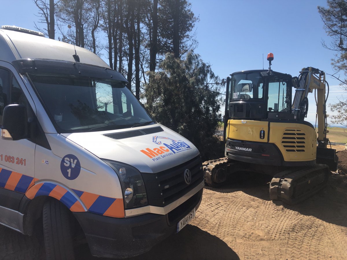

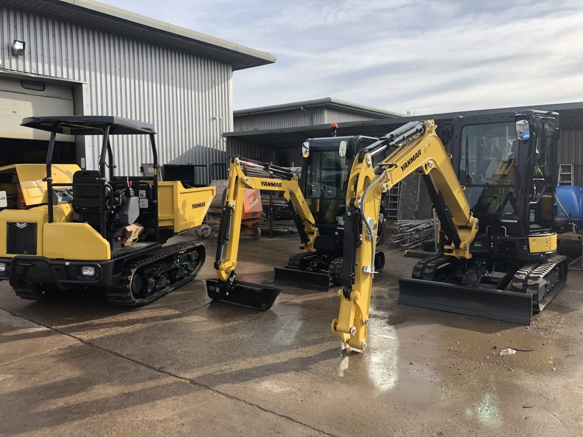

Couple of days down at Phoenix hire in Cardiff having some technical training on these Yanmar machines.
These are some nice under rated bits of kit! Very little to go wrong on these!
wee_gus
wee_gus
What do you reckon to the SV 26 Gus? Been thinking about getting one.
To be honest mate they seem to be one of the best sellers along with the vio 33, vio57!
These are ideal for the guy who likes his equipment simple! There is hardly any electronics on these machines! Everything is pretty much manual!
2 year warranty also as long as you change the hydraulic oil at 1 year old.
I would buy in a heartbeat

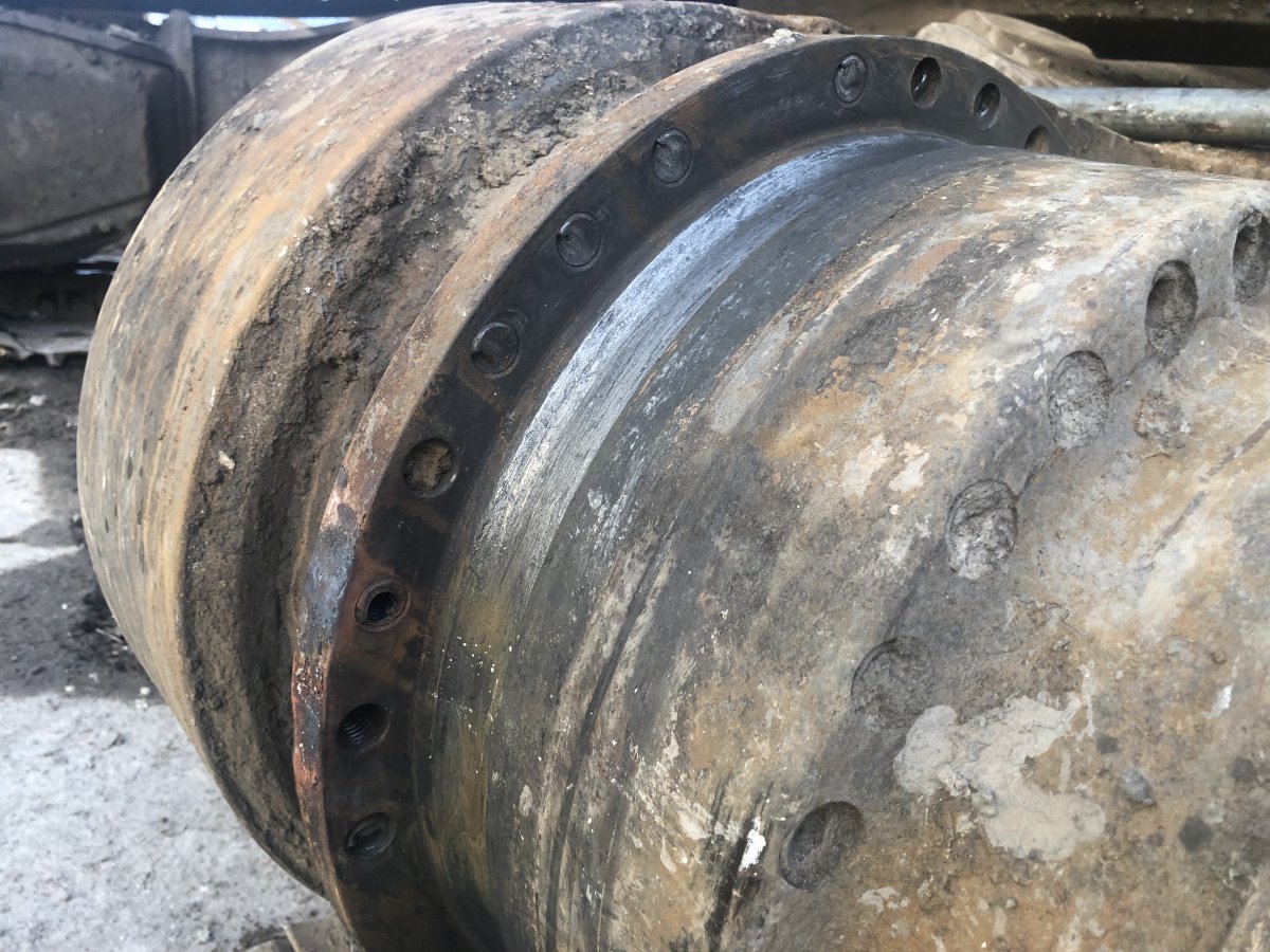

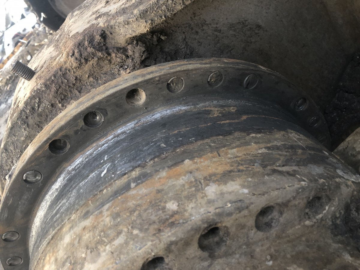

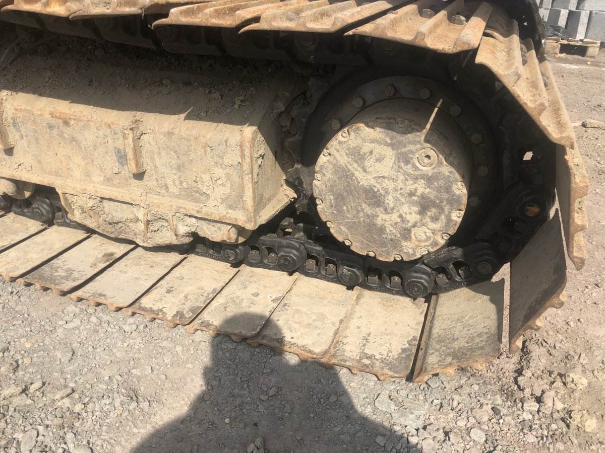

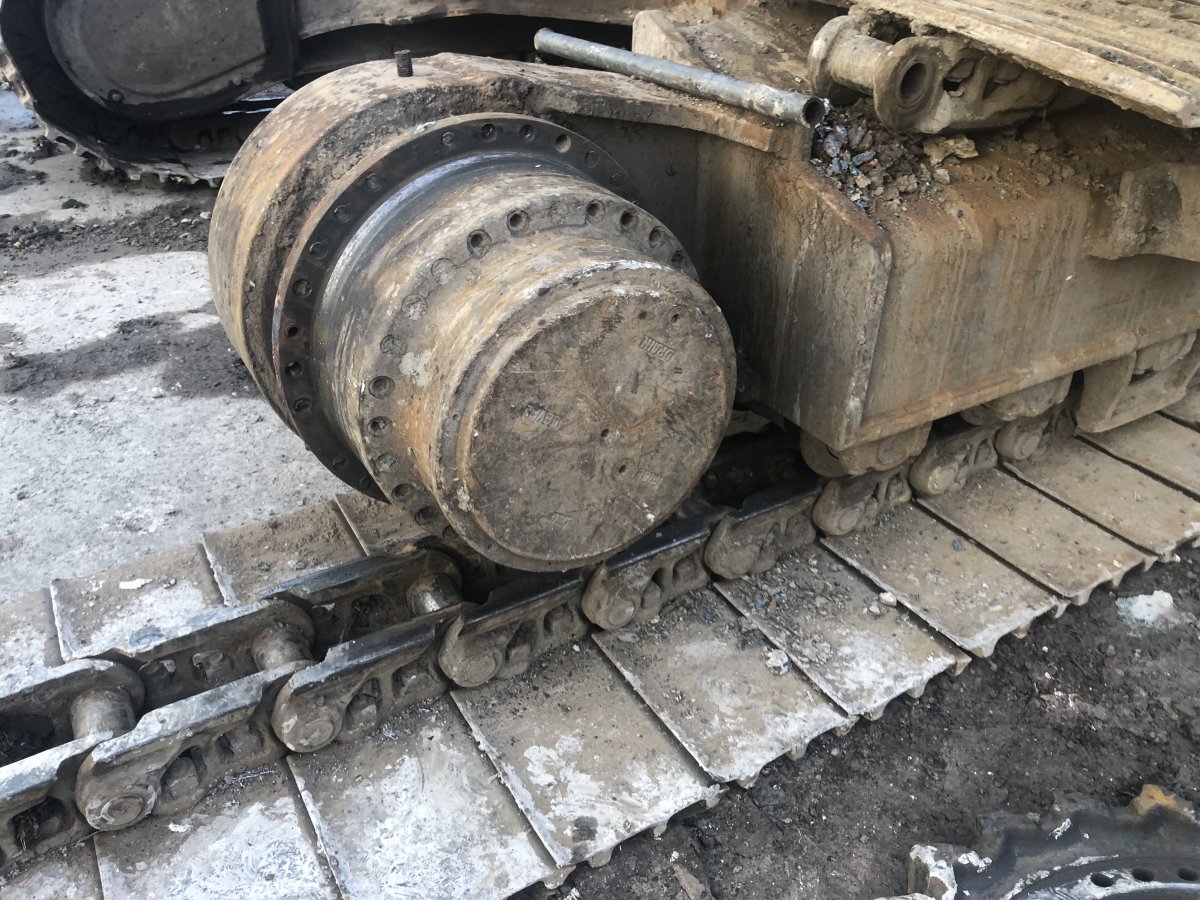

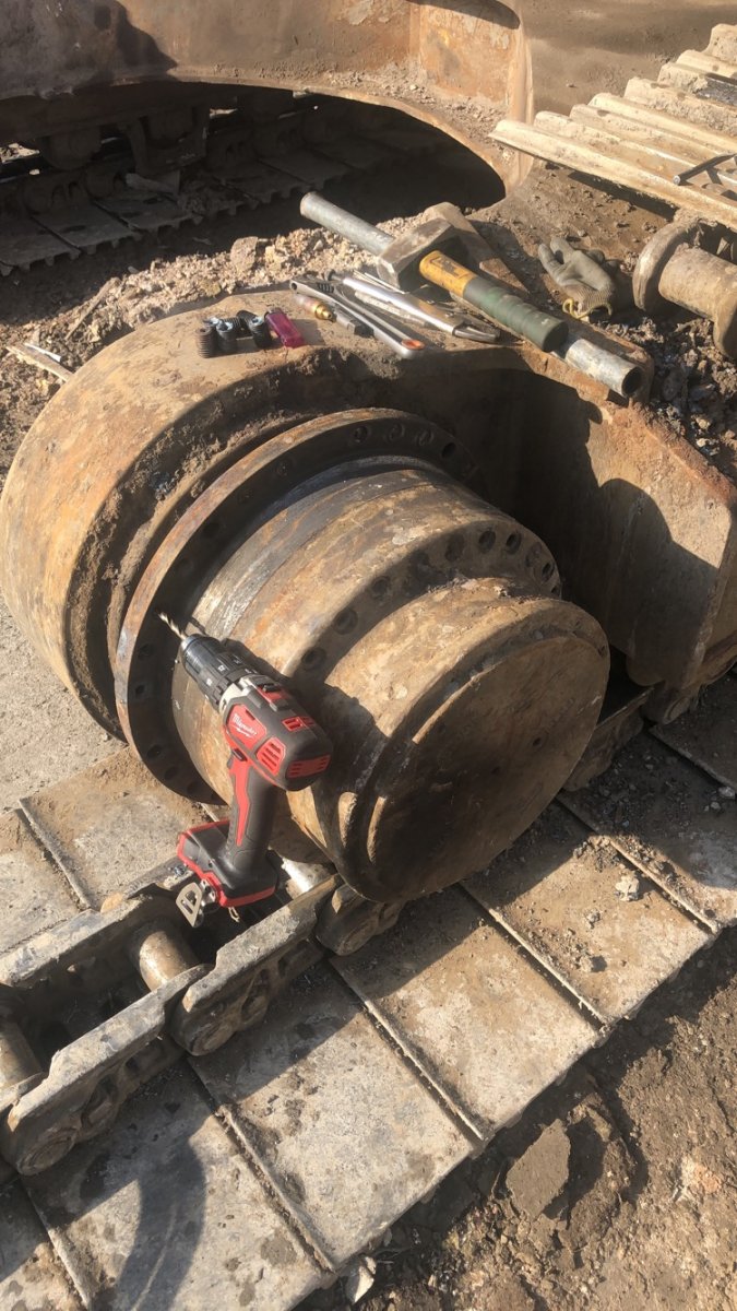

An absolute pig of a job, every single sprocket bolt snapped, tried the usual welding a bolt on trick, no joy, tried it with heat also, no joy. Last resort, drill out, easy out and a little heat and they came out apart from 2. Very time consuming

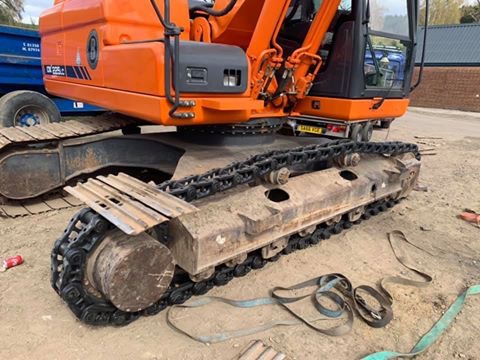

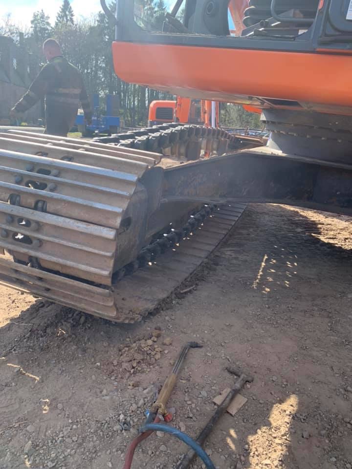

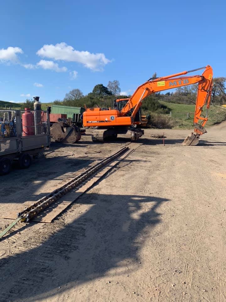

Track swap on this dx225

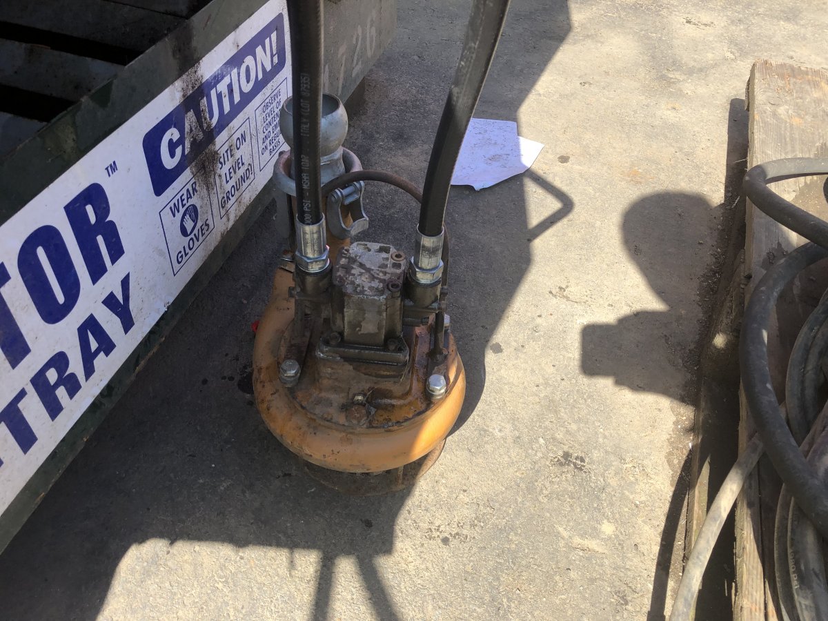

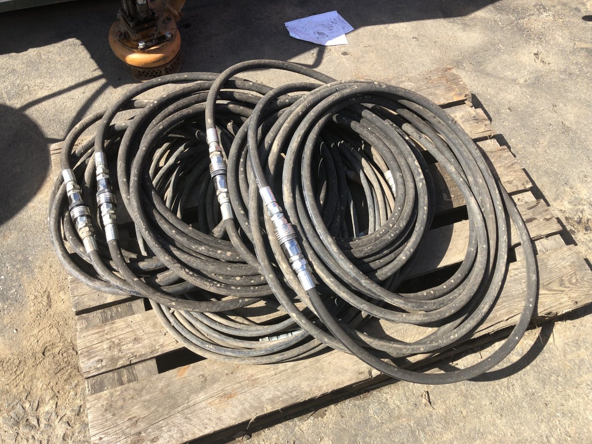

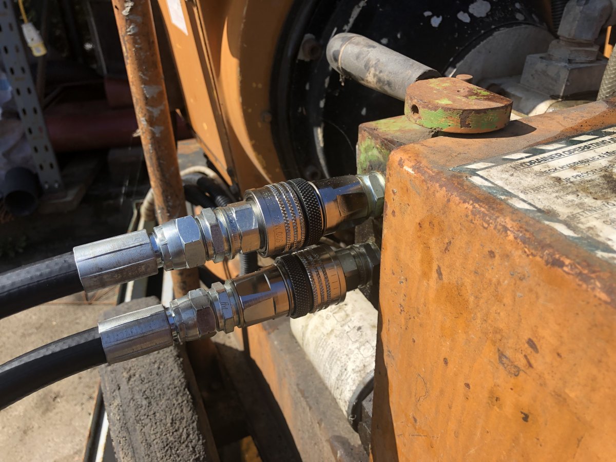

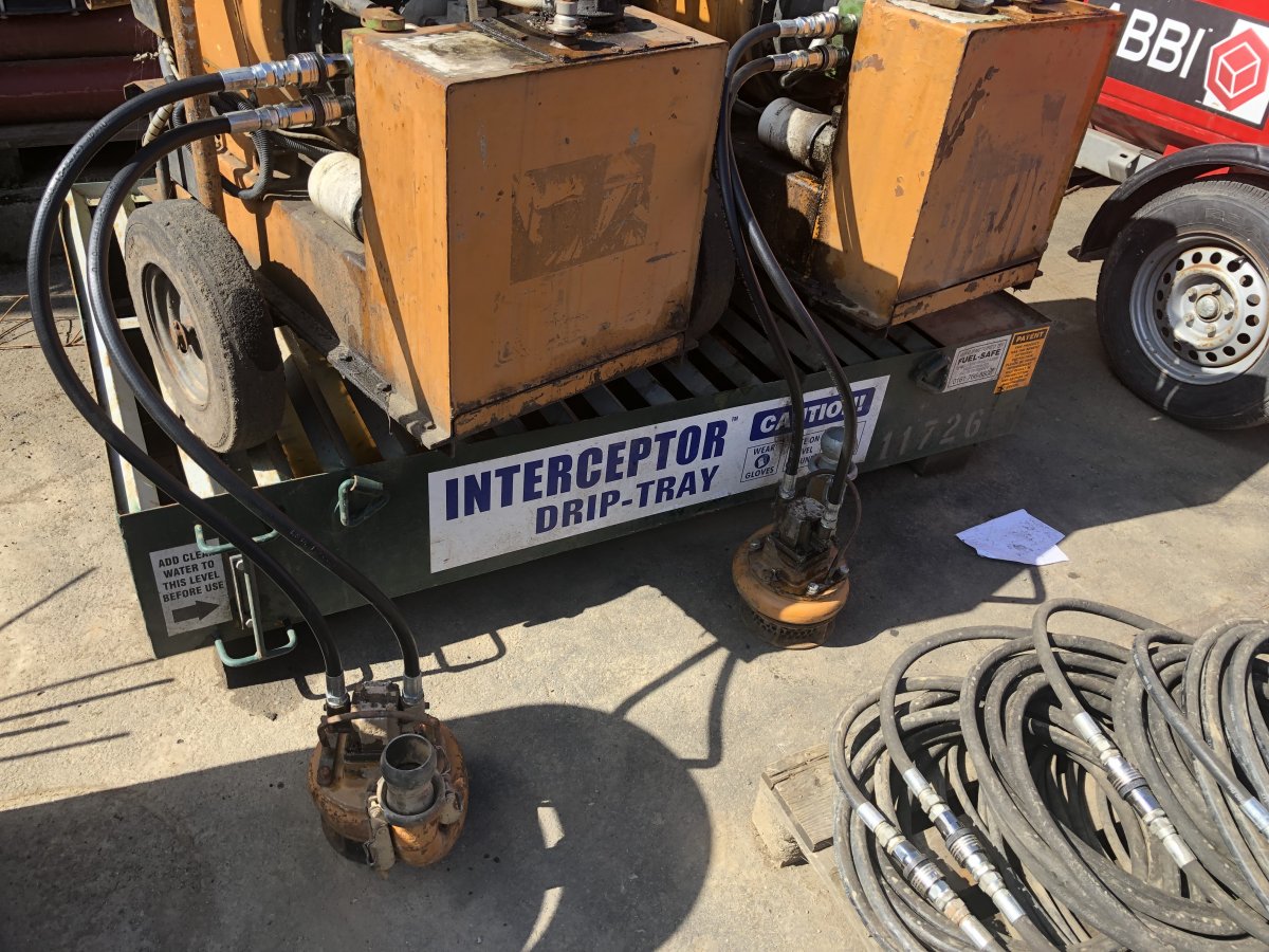

Team couplings sourced and fitted to these pump

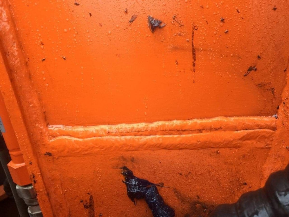

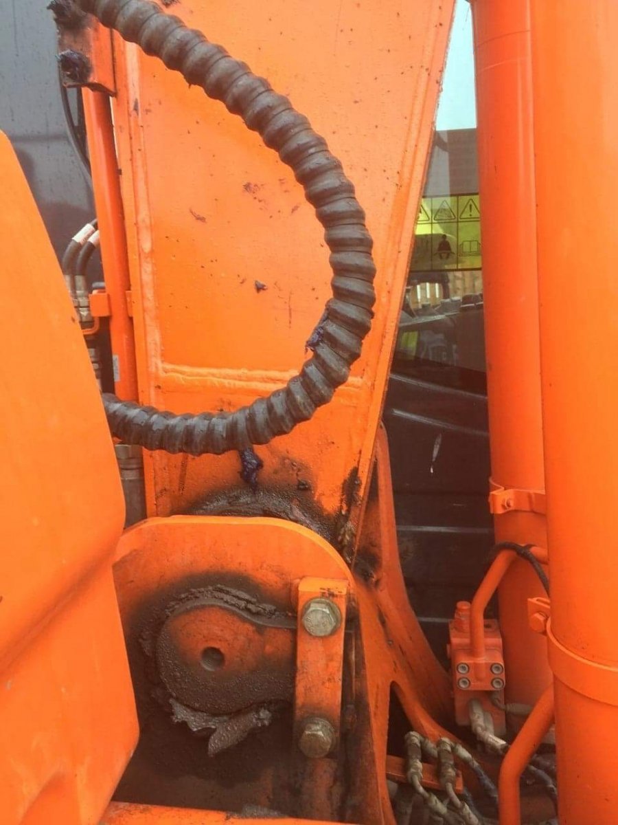

A typical doosan with the Chocolate booms, repaired photos to come later

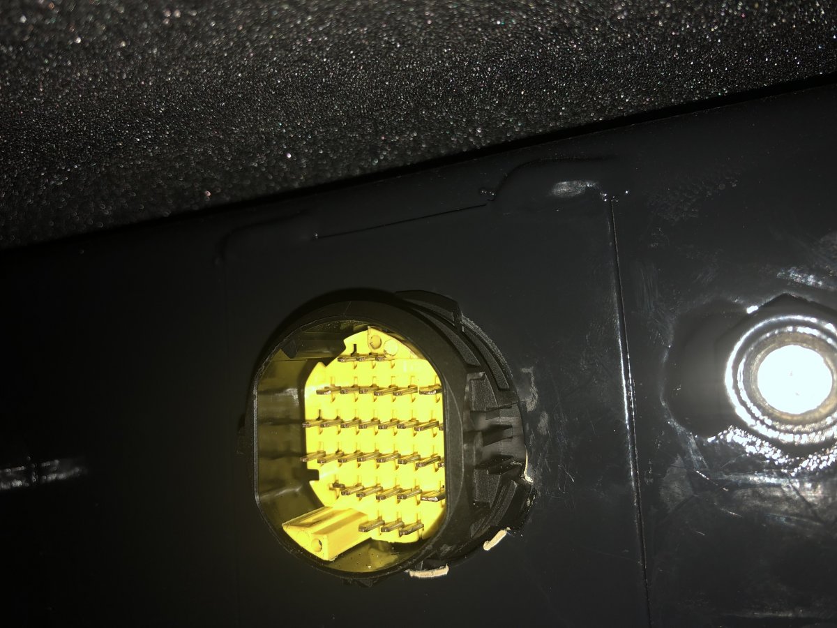

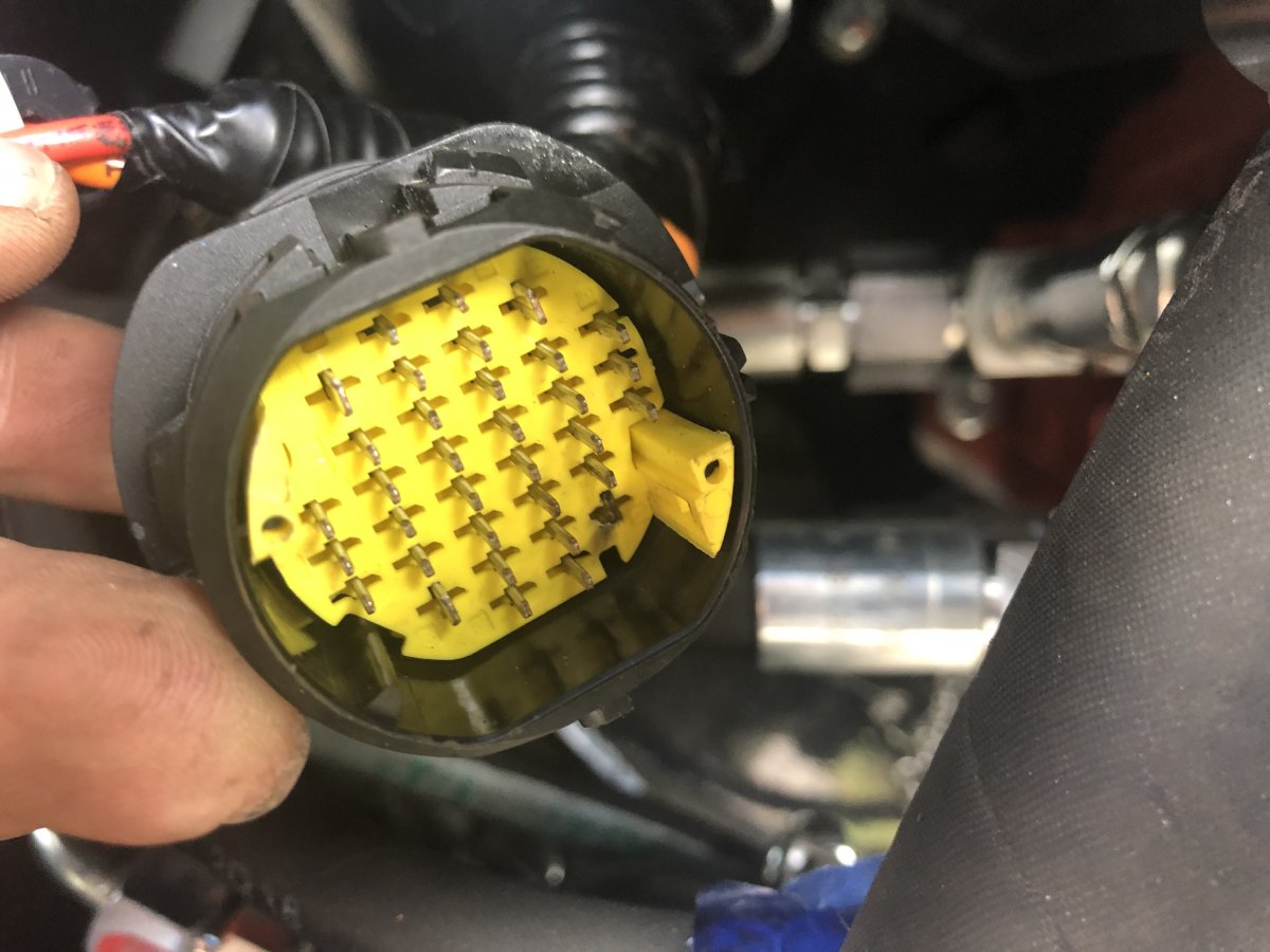

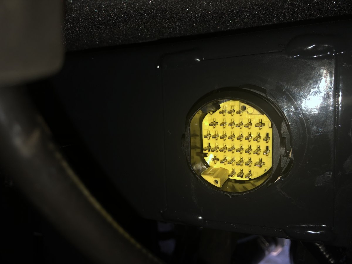

Brand new machine with an electrical issue, was a little hard to find as was intermittent

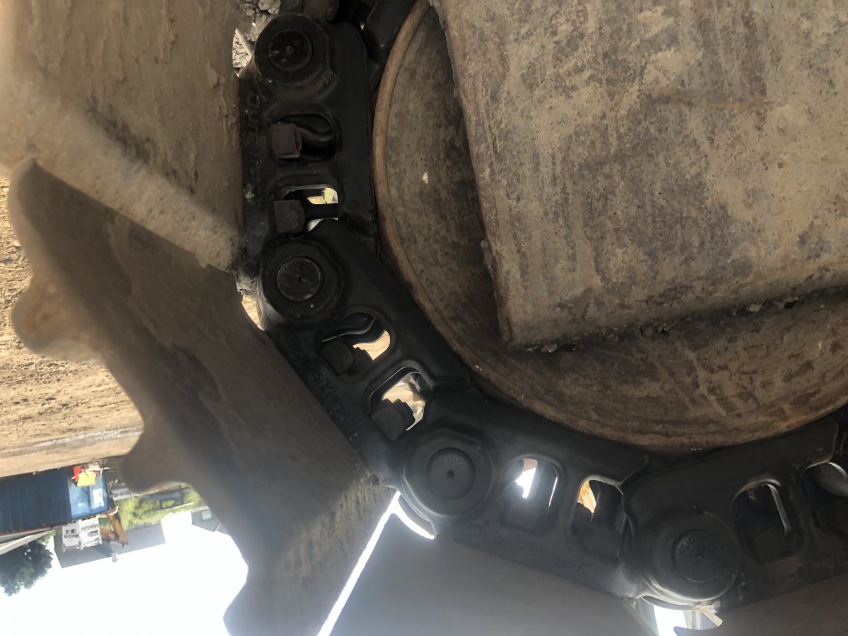

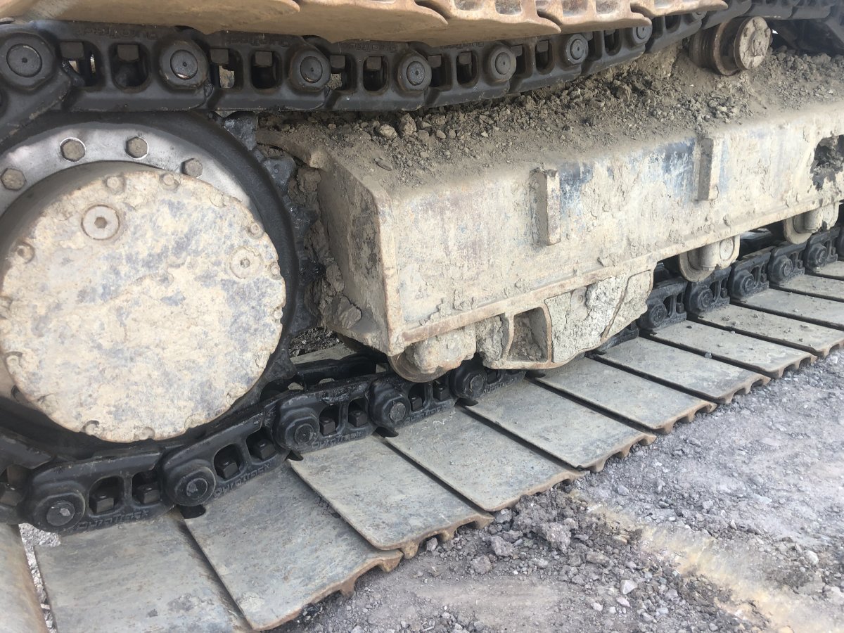

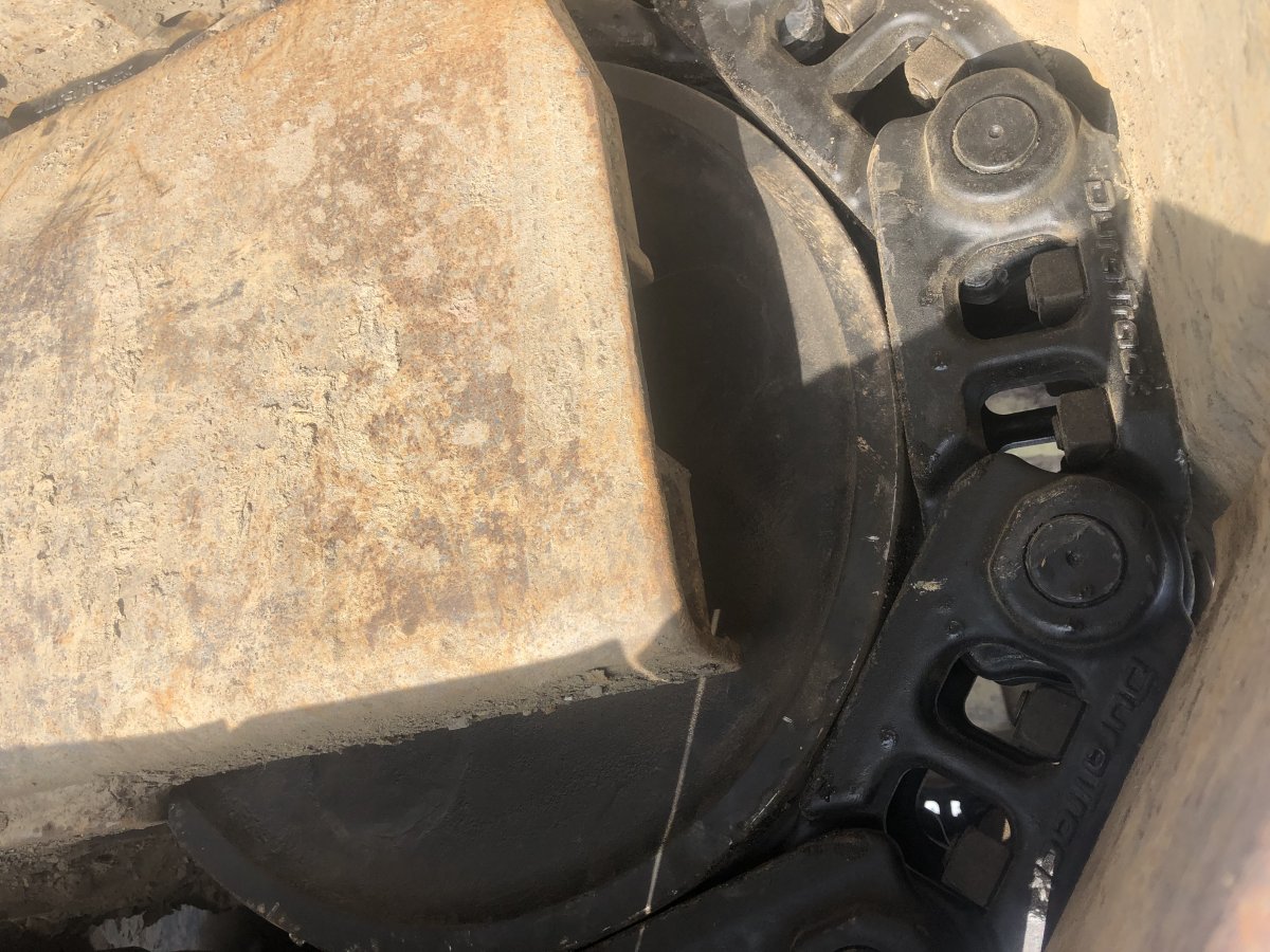

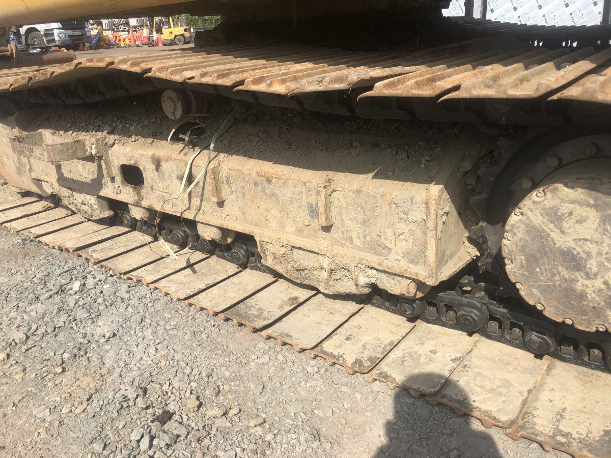

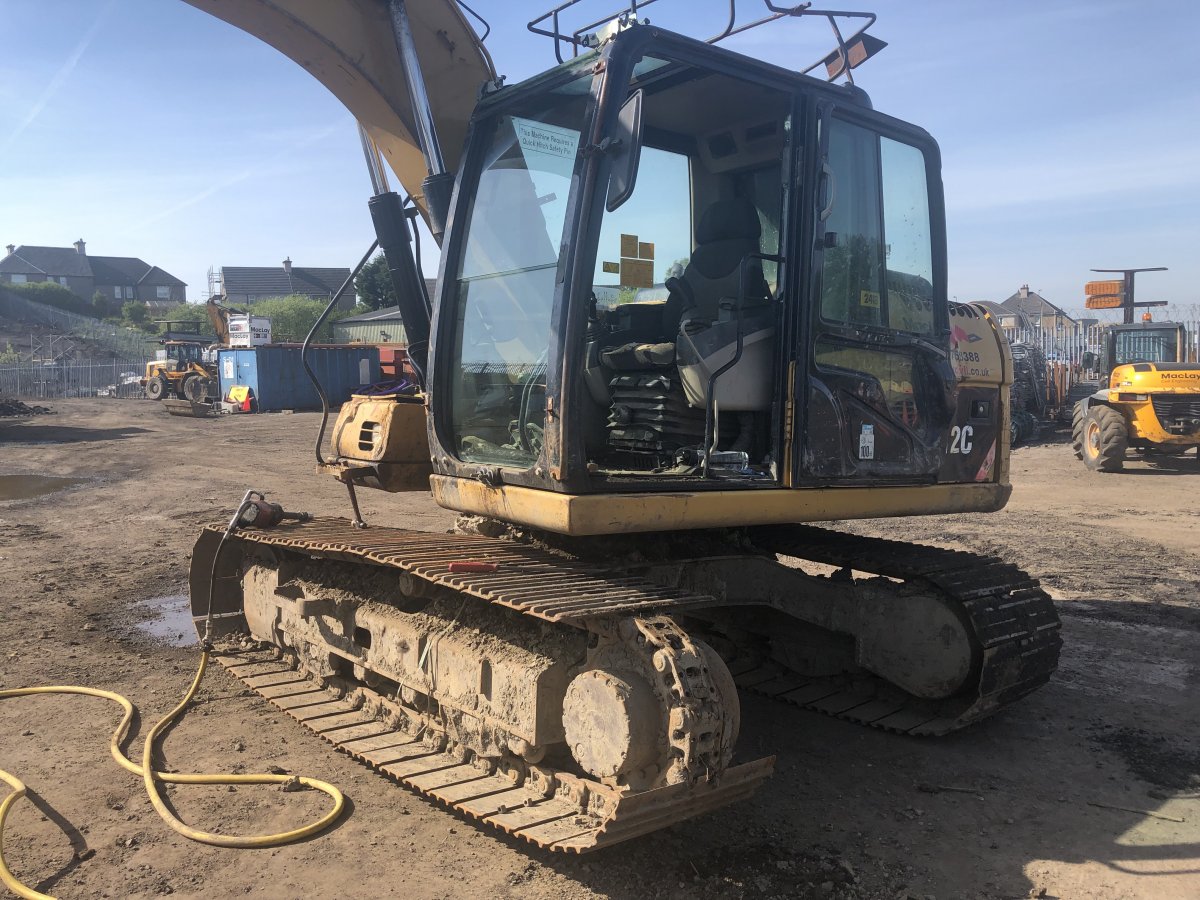

Cat 312 in for its first track swap at 7750 hrs, busted recoil ment we had to come back the following day to install, it’s amazing the amount of damage a busted recoil can cause to the idler

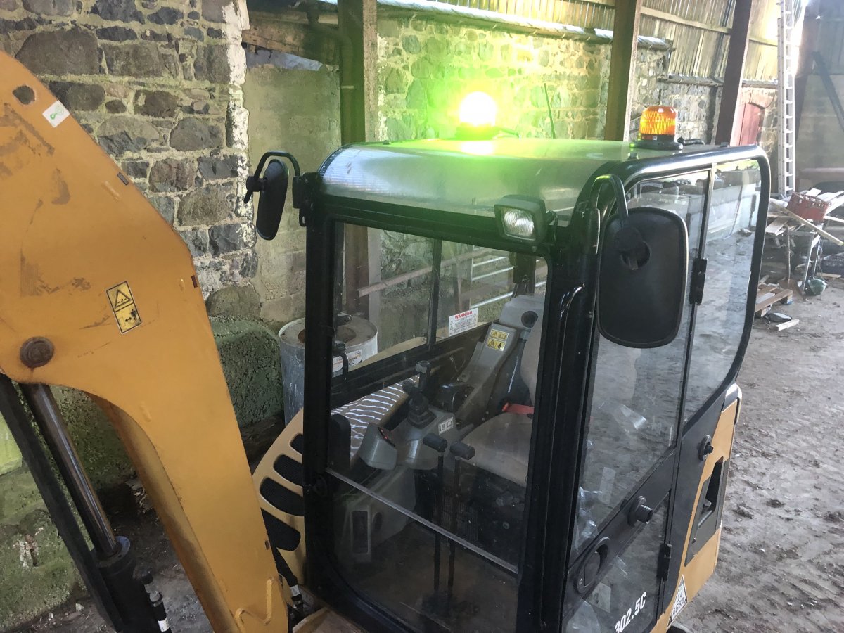

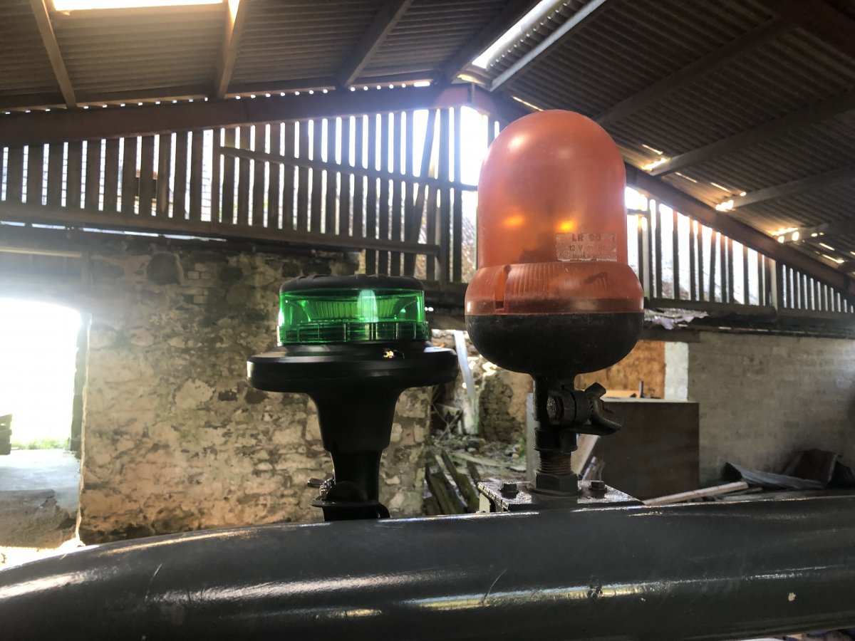

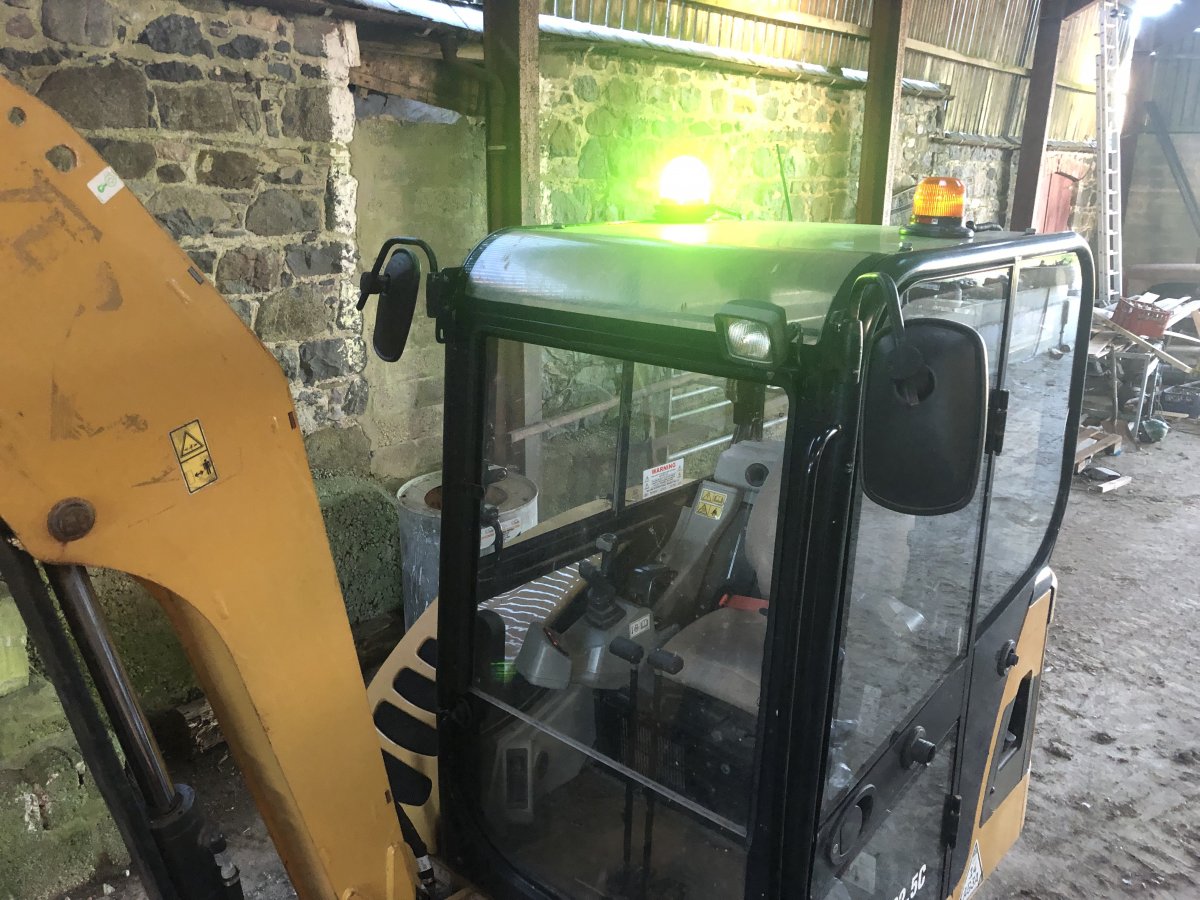

A couple of green seat belt kits installed

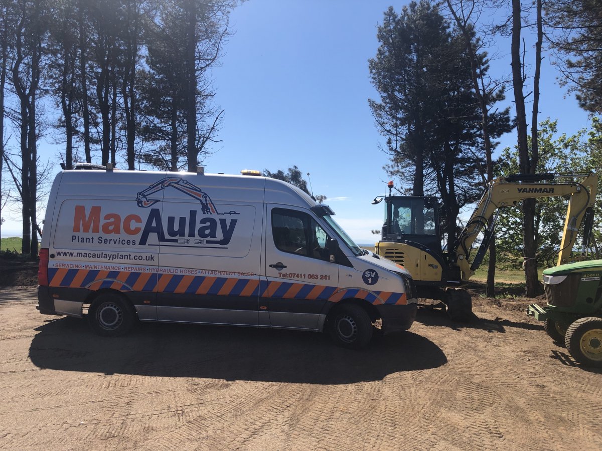

Carrying out a warranty repair under our agreement to act as Yanmar After sales support covering central and southern Scotland via the dealer network of Chris Knight Plant Sales & Stevie Walker Plant Sales
