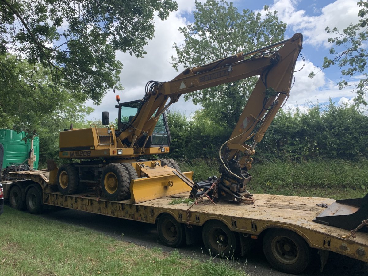

Don’t forget the implied load on the tractor - it can be upto 3 tonnes I think? I’ve got a similar twin axle low-loader trailer that is apparently 19 tonne capacity - part of the 19 tonnes includes the hitch loading. I’ll take a pic of the plate later if I remember.

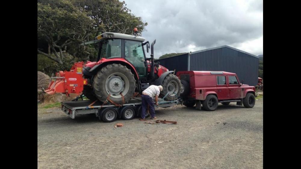

Tractors have evolved massively but their legal towing weights have remained relatively low. Something as pictured above (if well maintained) is operating well within its limits and doesn't pose any particularly great risk to other road users etc (providing the load is secured properly of course!).
Yeah, 2x 8 tonne axles and 3 tonnes on the tractor.
15 tonne capacity.
19t gross, less 4t of the trailer.
A js145 + hitch + buckets(s) would be tight.

15 tonne capacity.
Thinking about this a bit more, A few years back they put the gross train weight up to 31tonne, but the maximum weight of the trailer+load stayed at 18.29 tonne. So that JS145 and a 4 tonne trailer, it would be over.
But this then leads into the same arguments, tandem v`s tri axle as 3500kgs trailers, looking at @Monkeybusiness trailer plate, is about as good as it gets in keeping the weights legal, a tri axle would eat into the payload.
