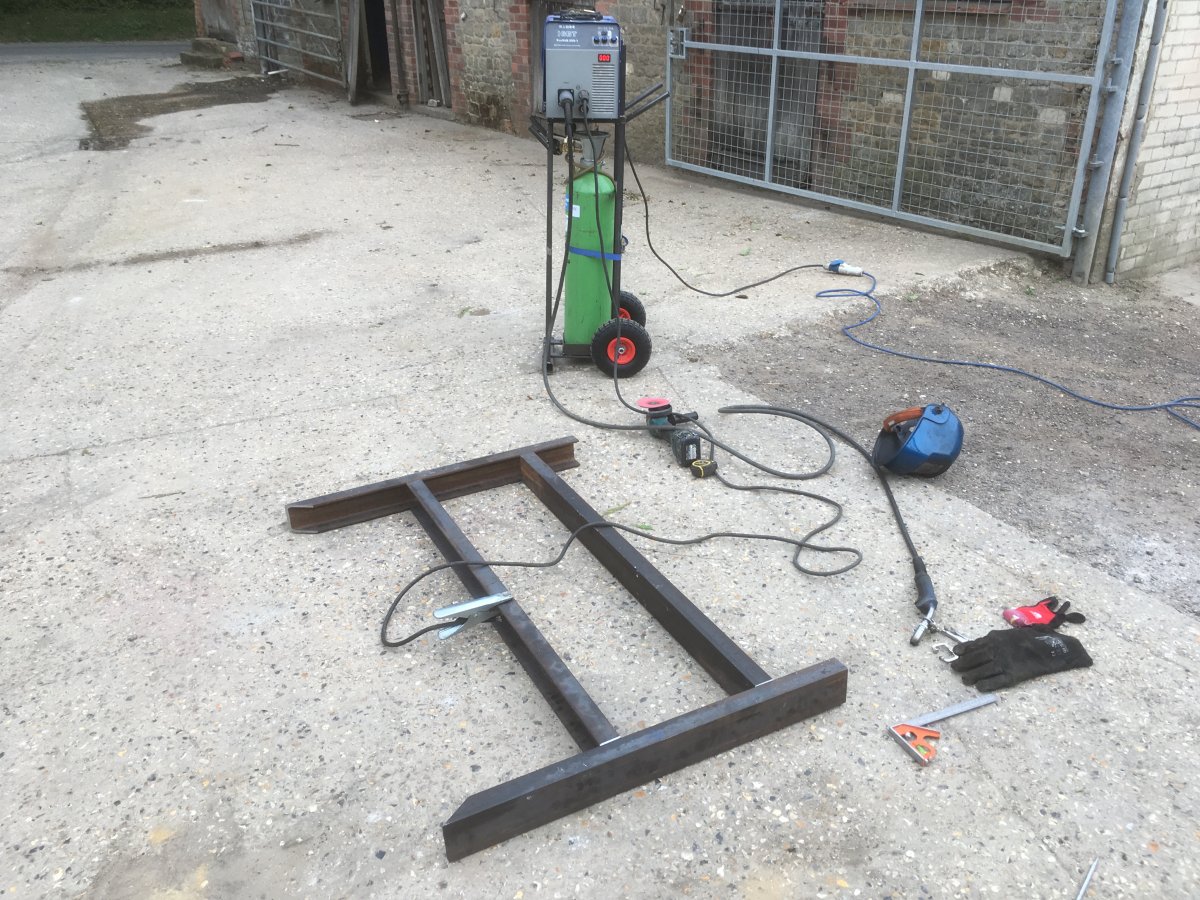

His bench maybe flat but not as big as yoursYes, I know Druid's fab bench is better than mine. When you retire, Grah......View attachment 1327
Yeah, but only a bit of mine is actually flatHis bench maybe flat but not as big as yours![]()

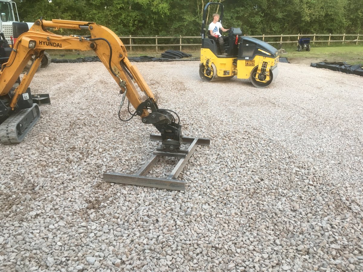

can you turn your Helac around in the QH, as a temporary measure Ruben ... it's not helping being the opposite angle to what you need to start withWell as the ***** at Days left us waiting till four for the last two lorries, I decided we needed to spread it quicker to be ready for sand tomorrow. So welded a hitch onto the grading beam. f***ed it up a bit, I was in a right rush. Cheeks are a bit wonky but bosses squarethere was nowhere to really put a square against.
Took half an hour to get used to it, but a major improvement on a bucket I'd say. Hitch needs to be jigged a bit to allow more pull back to machine so it's a good job it's not fully welded apart from the bosses.
I think it is one of those things that you don't appreciate how big a time saving (and in my case improvement in quality) can be made until you have one. Then you'll wonder why you never made one earlier.Well I was s**t scared of using it to level out the menage sand, what with those sharp edges, my lack of experience with it and the membrane 125mm belowbut it went bloody well. It cost me maybe £180 in steel and kit form hitch plate to make and probabl;y three hours to put it together. I can honestly say it paid for itself in time savings on that one job.
