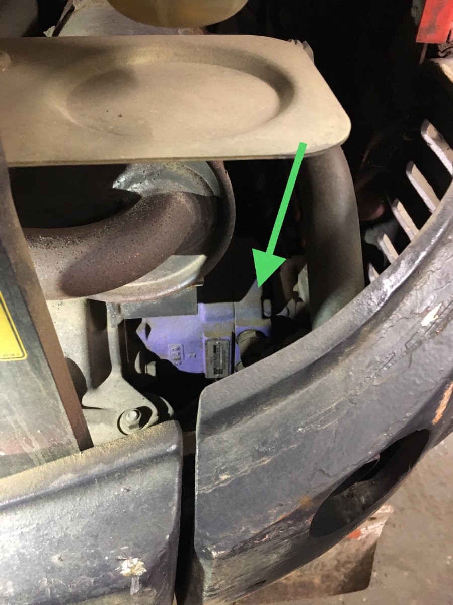

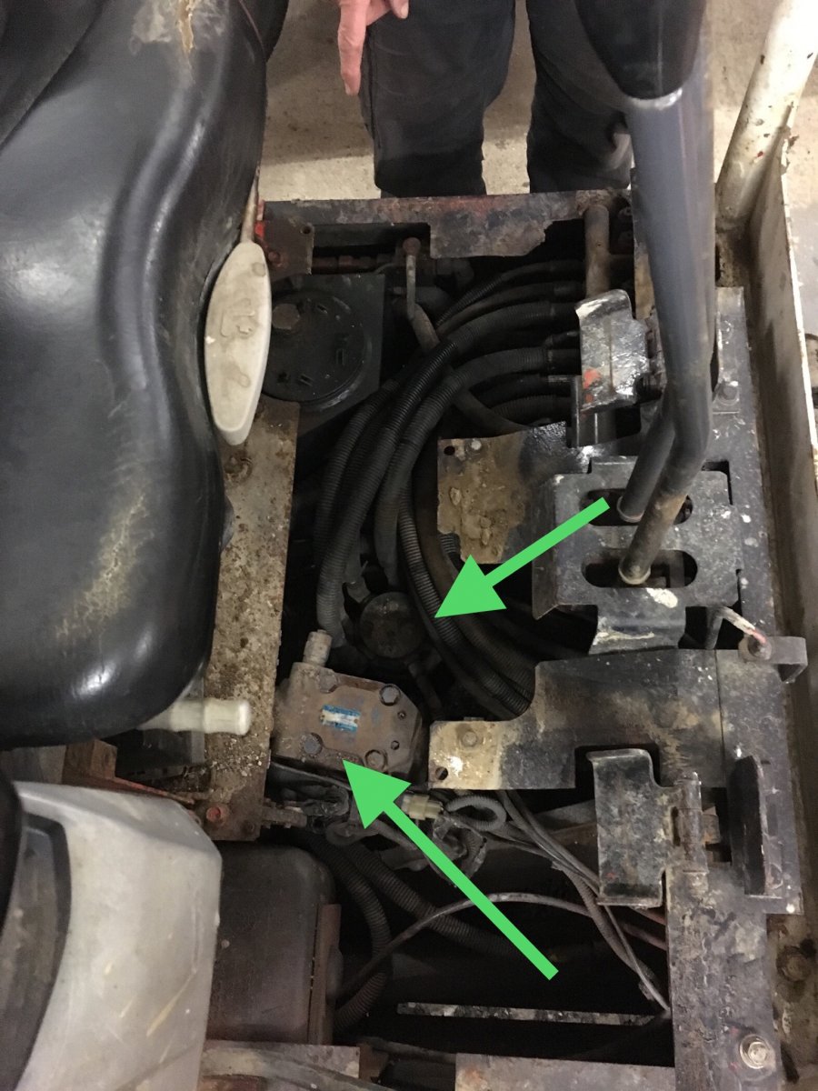

????? The pumps are on the end of the engine surly :unsure:
Sorry id assumed these were all pumps !
Been trying to get hold of the workshop manual but not got one yet

Thats the slew motor under the seat. The others are the pumps. Have you checked all the linkages and pipes.
Pump is on the engine looks like a single swash plate to me, under the floor is the slew motor and the rotary coupling
So reading your first post it maybe the seals in the rotary coupling (that will be the one right in the center of the slew ring) the slew motor will be just off centre
What he said(y):LOL:
Could check the motor case drain lines also to see if there is excess leakage.
But also as DJ says, check the linkages on the track paddles too, one may not be pulling fully.
was gonna say ...... looks like a a VDP :cool:
