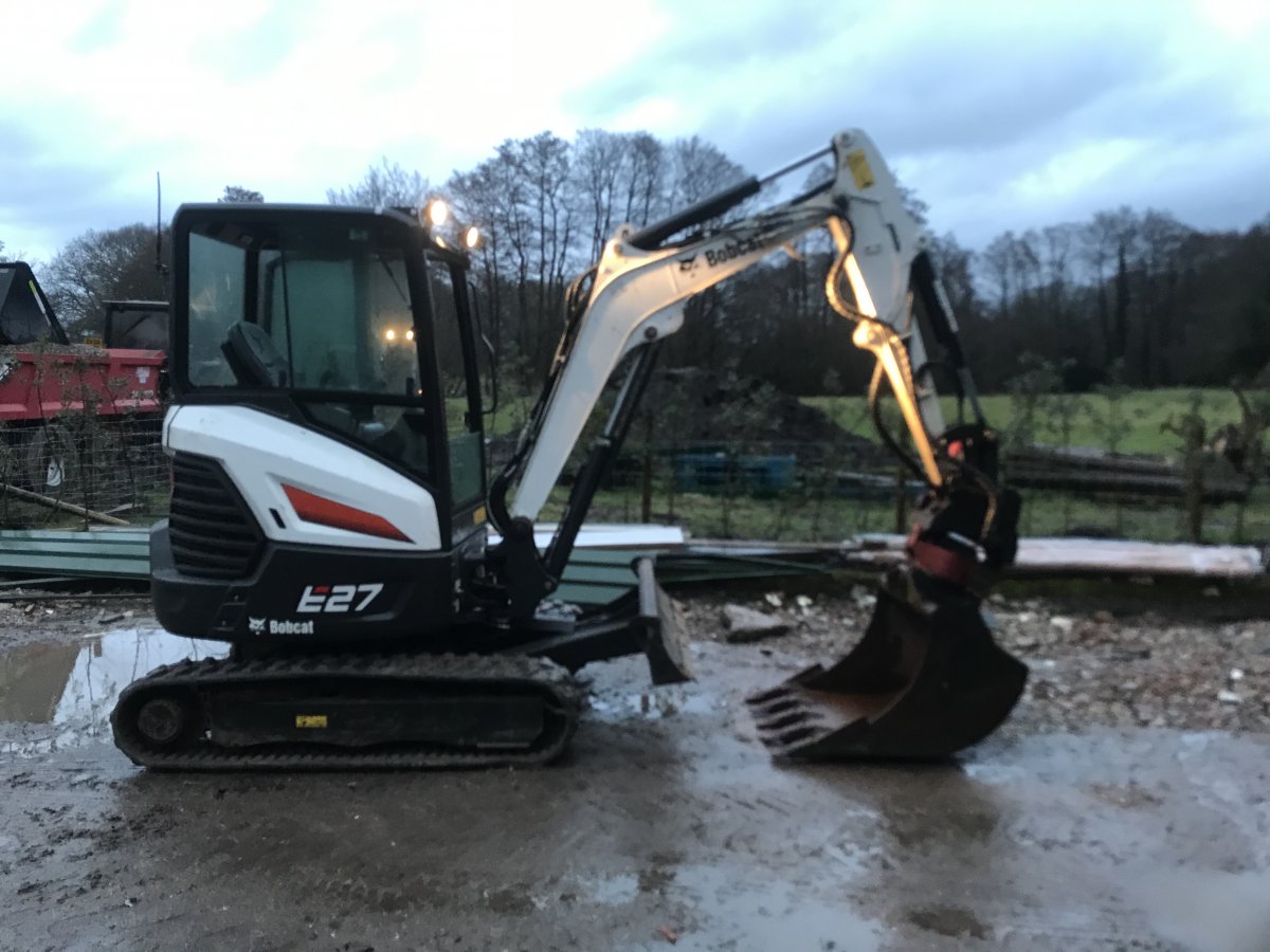

900mm digging bucket or you are just wasting diesel!

I'm thinking 750mm isn't big enough, but I'm a greedy bastard. What harm could i do do if i went bigger. Only me using it, a professional operater thats held a citb ticket since 1988.

Can't do that much damage several hire firms round here have 900's
Although they are fitted with teeth which I find a bit pointless as they can only be used digging in the lightest soil otherwise you just drag the machine around
But if loading stone from a stockpile they are perfect

Yeah. It wouldn't be used for hard digger, that's what the 2' is for. I'll have to go and look damage Dan sheep shagger man's 900mm.

Ive used the 900 on both the 2.6t Hitachi and 2.7t Kubota zero tail don't know if they are any bigger than the volvo
