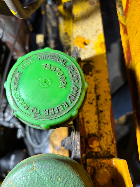

Another question if I may, I’d like to change the clutch/brake fluid as I don’t know when/ if it’s been done.
What’s the spec, I take it’s not your standard car type fluid?
What dumper is it? and how old?

Here you go
