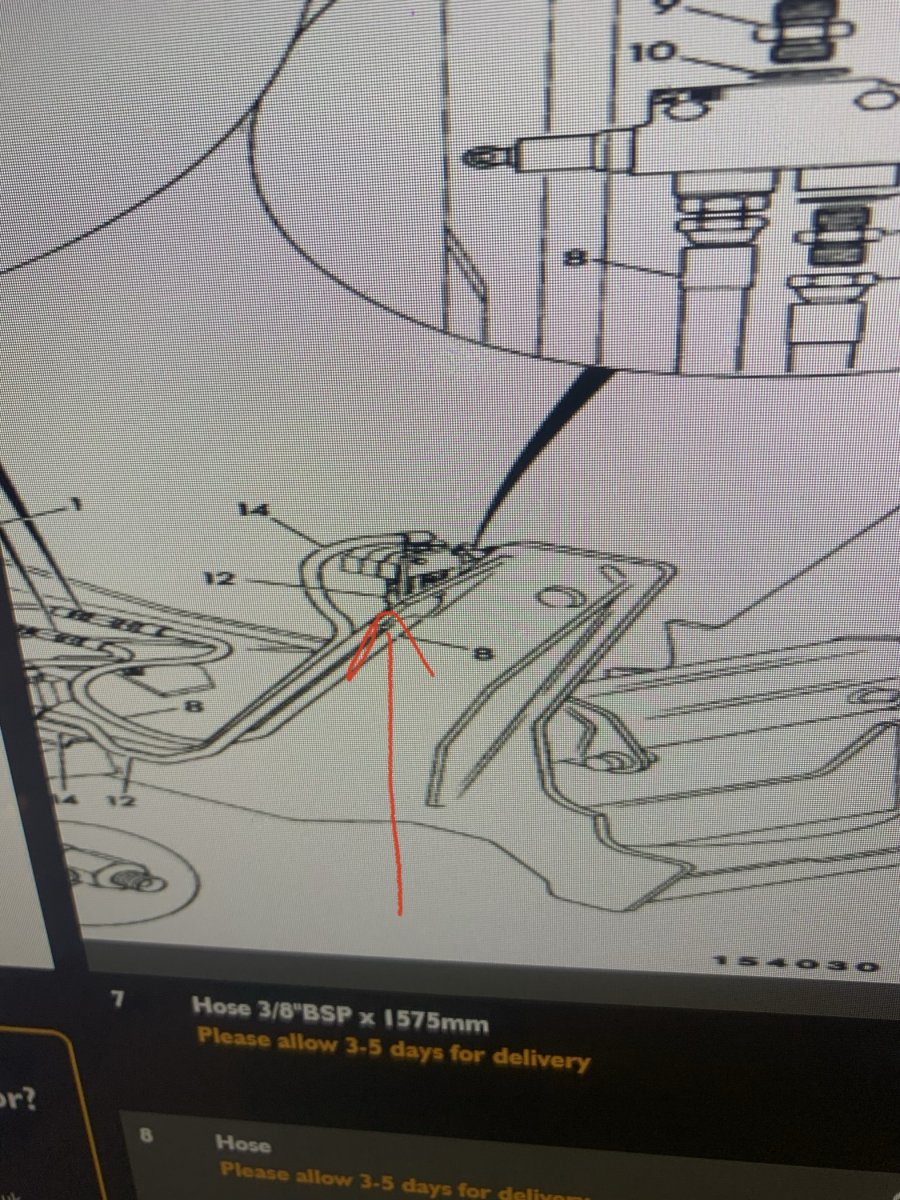

ThanksMechanical limit valves on a machine that age. Plunger operated job, as electric wasn't common on that age of machine. I'd bet one of the plungers is stuck. A tap on valve and some lubrication job should be a good'en. One for each leg, hence the fact one is still operational.
Thanks for thatHere is a picture showing valve location. I’d start there make sure the oil is being allowed through the valve.

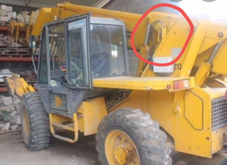

Sorry bear with me can’t make out where that is on machine is it on the stabilising legHere is a picture showing valve location. I’d start there make sure the oil is being allowed through the valve.

Exactly thisthey are located near the boom hinge point behind the cab. Sometimes the little roller bearing breaks causing this.View attachment 12549
