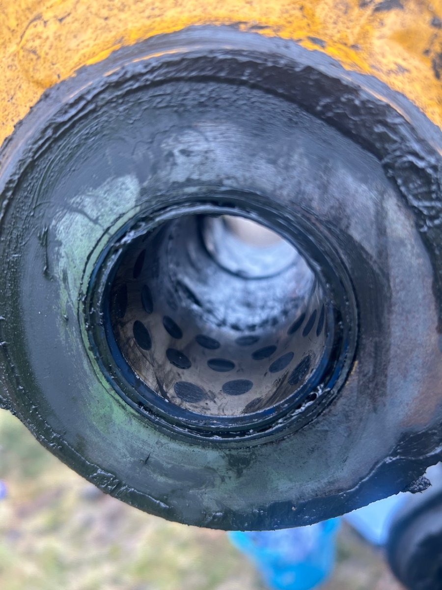

These type. Brass with delrin studs by the look of it. Gave it a few taps but I’ll just end up chewing it up.
What’s the best way to remove? And anyone got a link to replacements? Bought some spring fit steel ones off eBay but these look a better design. IMG_6612.jpeg
Brass will cut out easy enough? I think these are the optional extra ‘long life’ bushes.. not sure why they haven’t lasted very long on your machine though?
What’s the best way to remove? And anyone got a link to replacements? Bought some spring fit steel ones off eBay but these look a better design. View attachment 68929
machine a stepped drift ?
