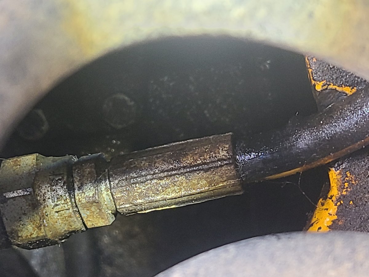

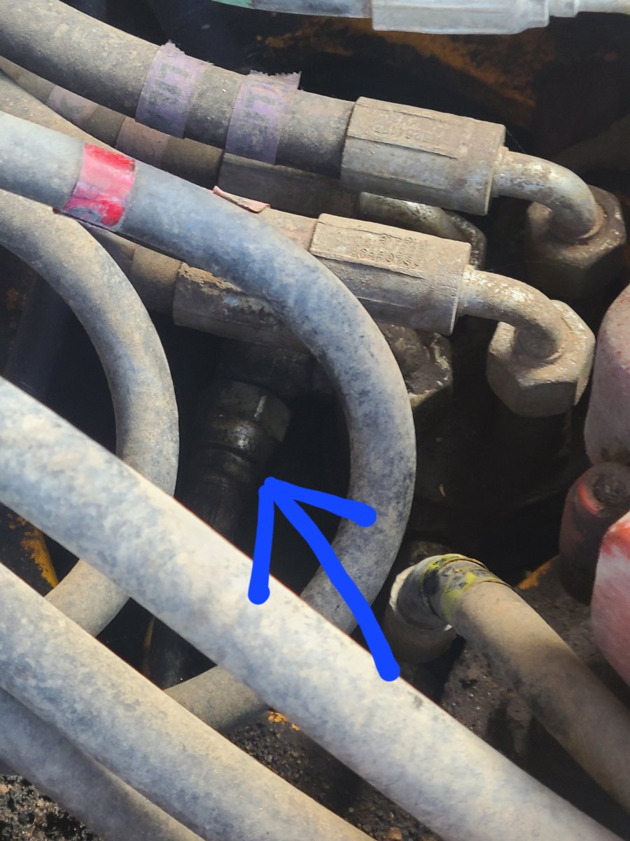

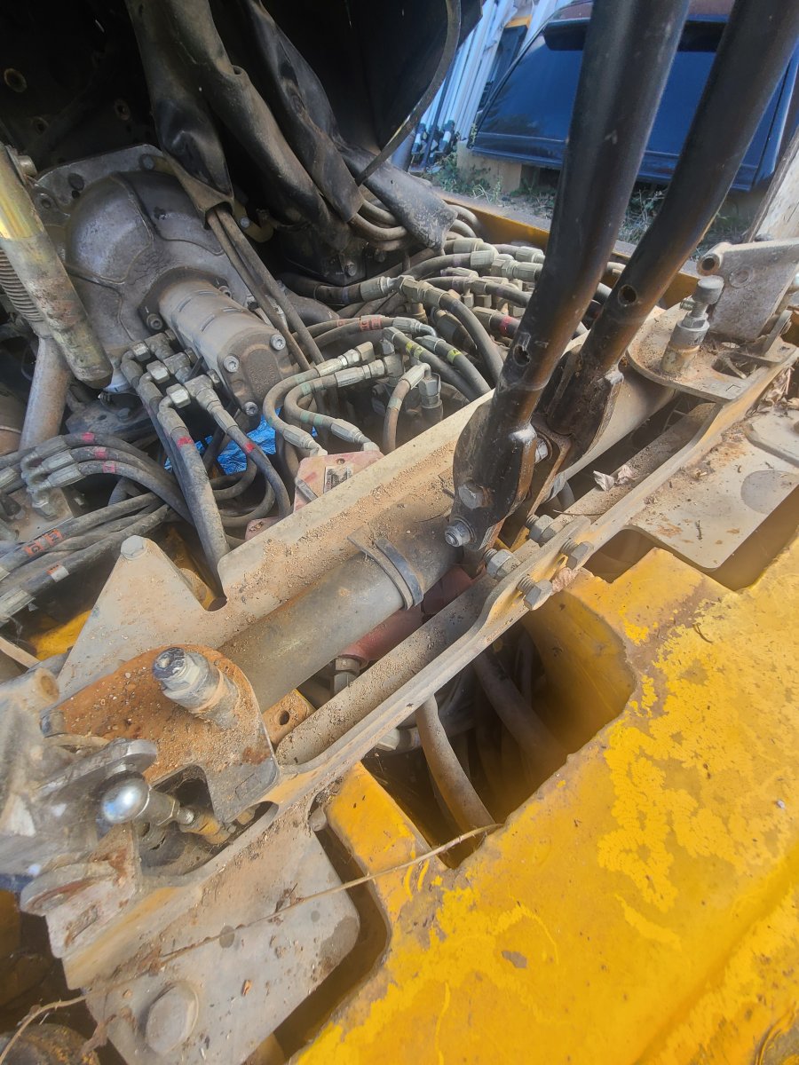

JCB 8014CTS (2015) Hydraulic fluid leak
jd6820
jd6820

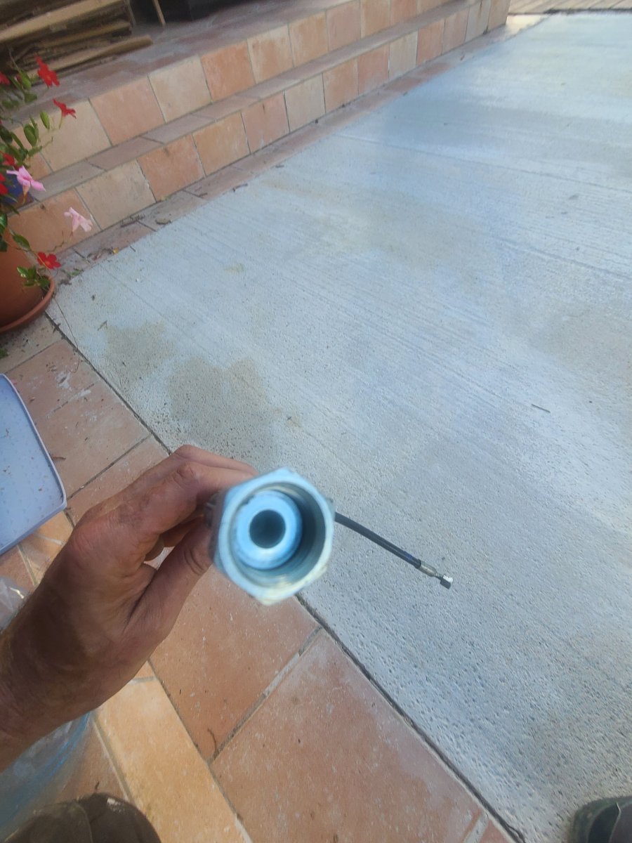

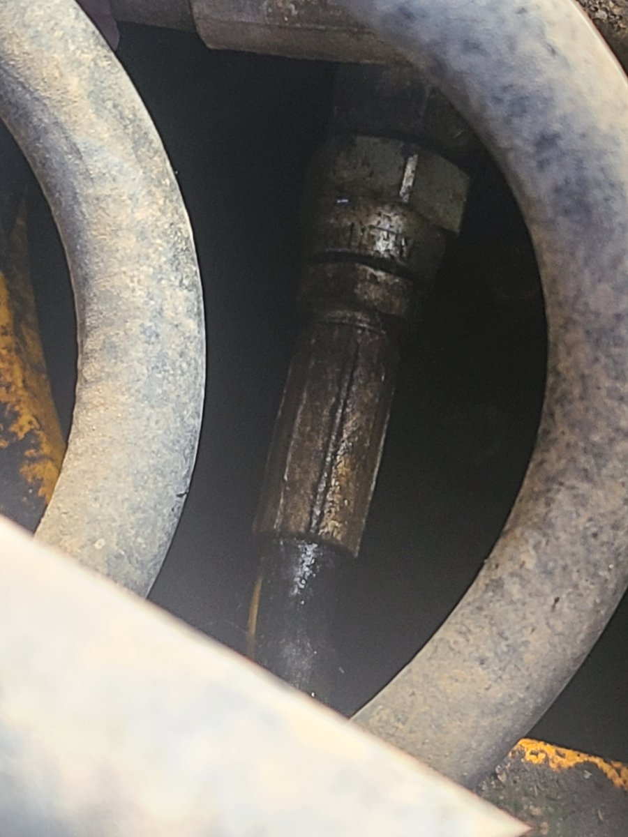

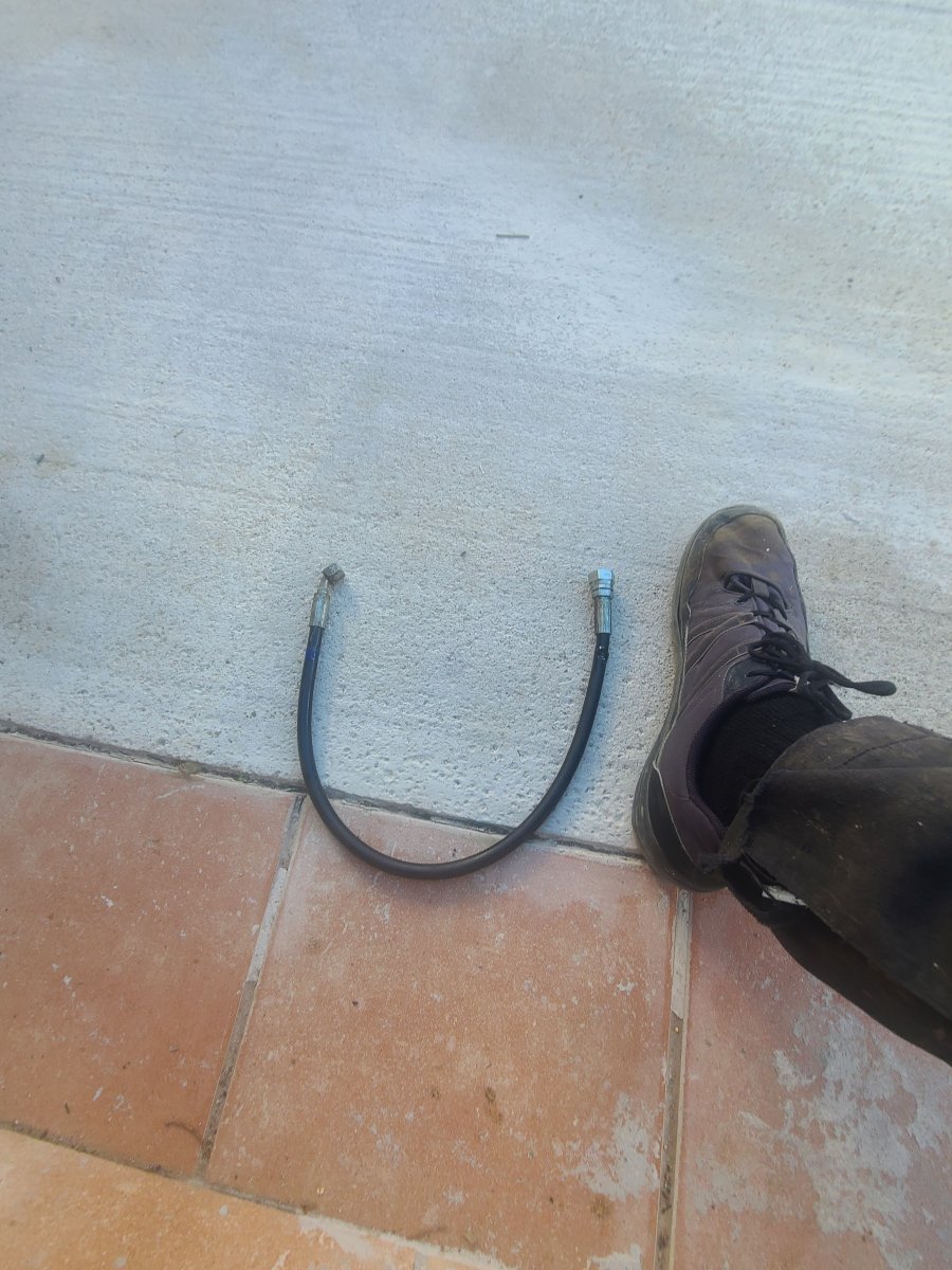

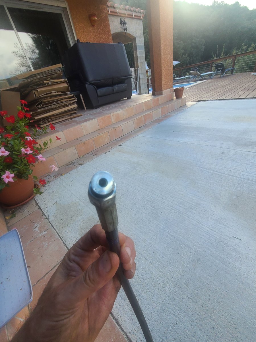

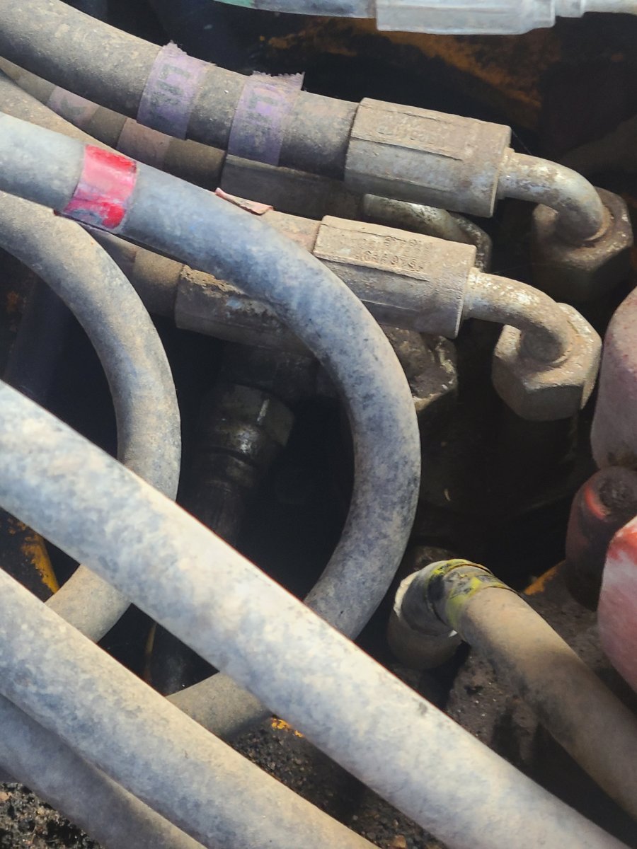

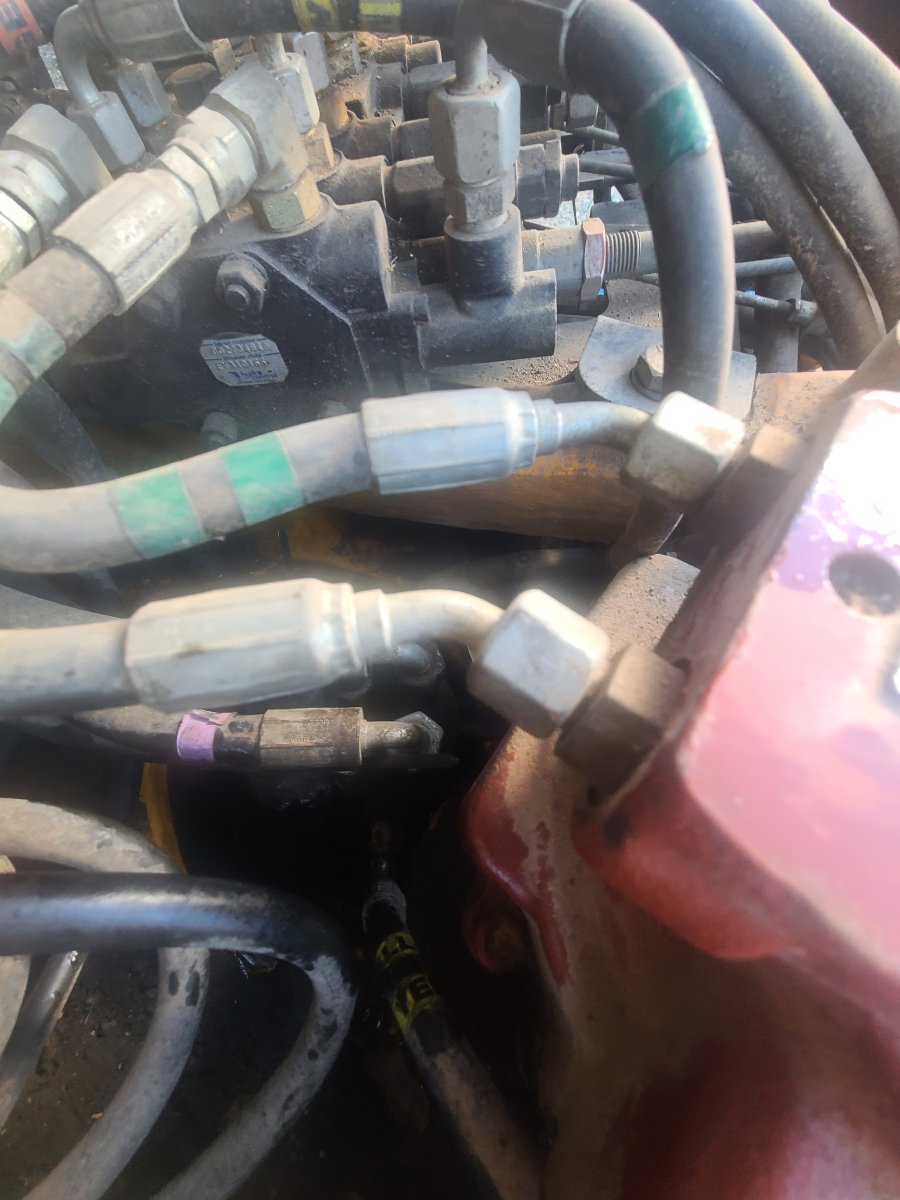

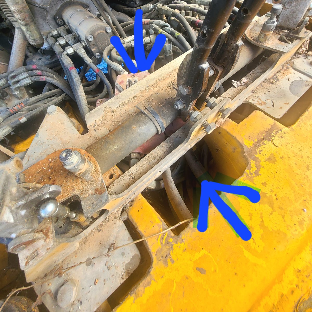

i think its the one that comes out of no. 12 ? 6 looks right but at the other end , it goes into its own fitting not a "T" fitting like the diagram.

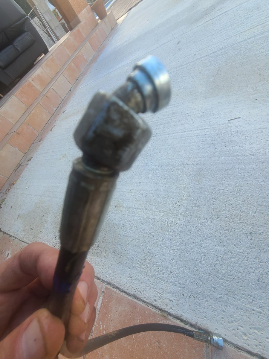

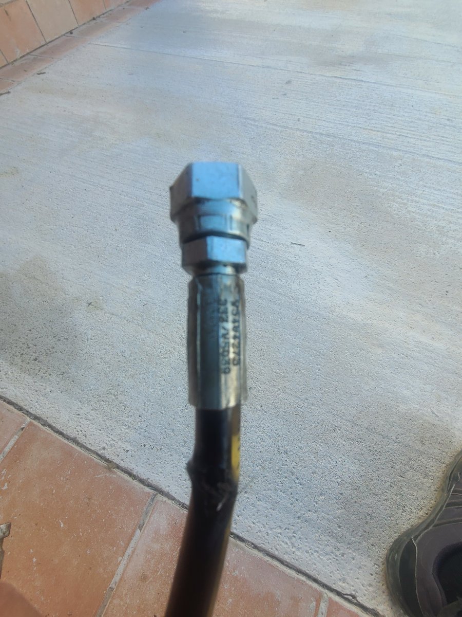

If you have a look at the hose you removed it has a part number stamped on the ferrule. This matches the number I have attached. That's what lead me to that particular hose. :)
Deanofire

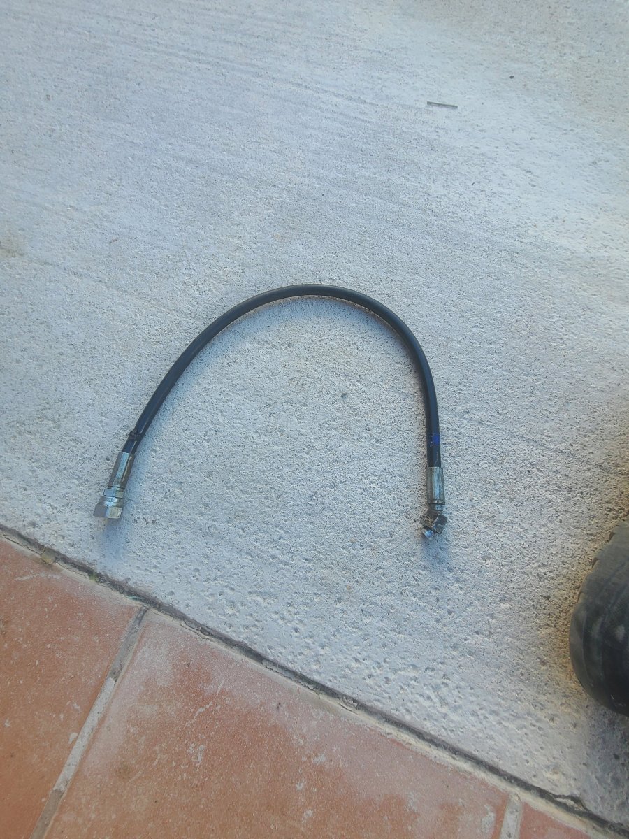

OK thanks. It's at the shop now who are making g me a new one ,but when I get the old one back I will look it up. Cheers
Deanofire

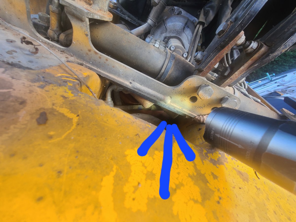

Hi all. Just an update to let you all know i managed to fit the new pipe and am back up and running again ,thanks to all the help from you guys.
I really appreciate the help, comments and suggestions from everyone involved.
I hope you all have a great Christmas and i am sure i will be back soon asking for help lol.
Thanks once again
