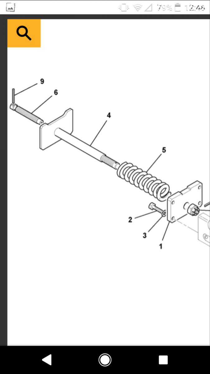

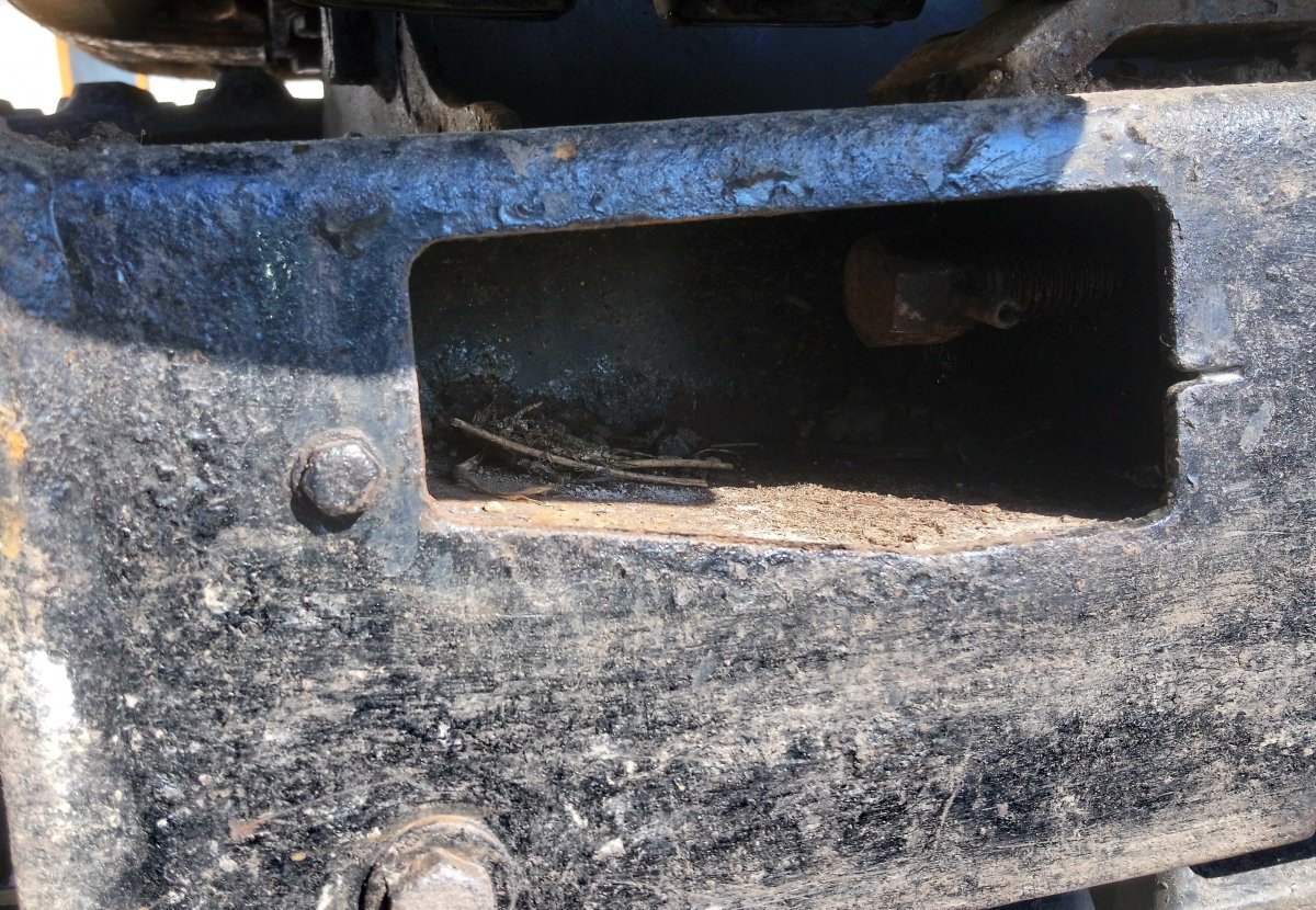

looking at your drawing and this is pure speculation, i'd say that item 6 screws in/out of item 4 (or a threaded plate, not shown, in the carrier frame, pushing the machined step on the end of 6) into 4 increasing the loading on the spring (5) .. I assume plate 1 is fitted to the rear of the idler carrier with 4no. bolts (2) and washers (3) ..... the castellated nut with securing split pin on the end of 4 keeps everything attached to plate 1 ...... presumably item 6 needs to have something to bear against in order to preload spring 5 with the plate at the end of item 4, which i'd assume is shaped thus to prevent it turning and slides in some sort of guide.
as said pin 9 is presumably secured by something attached to the cover plate to stop it free rotating
But .... WTF does 6's bolt head bear against, if 6 isn't threaded into a plate in the track frame??:unsure:
I think bolt 6 (the adjuster) runs through a thread in the track frame to push against 4 but it's been a long time since I've had to bother with 801 tracks. Either way doesn't matter 6 is the adjuster which is all he needs to know.

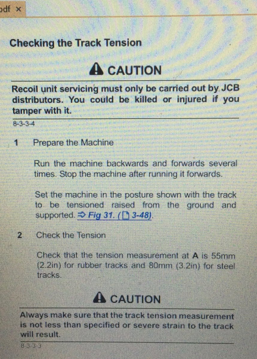

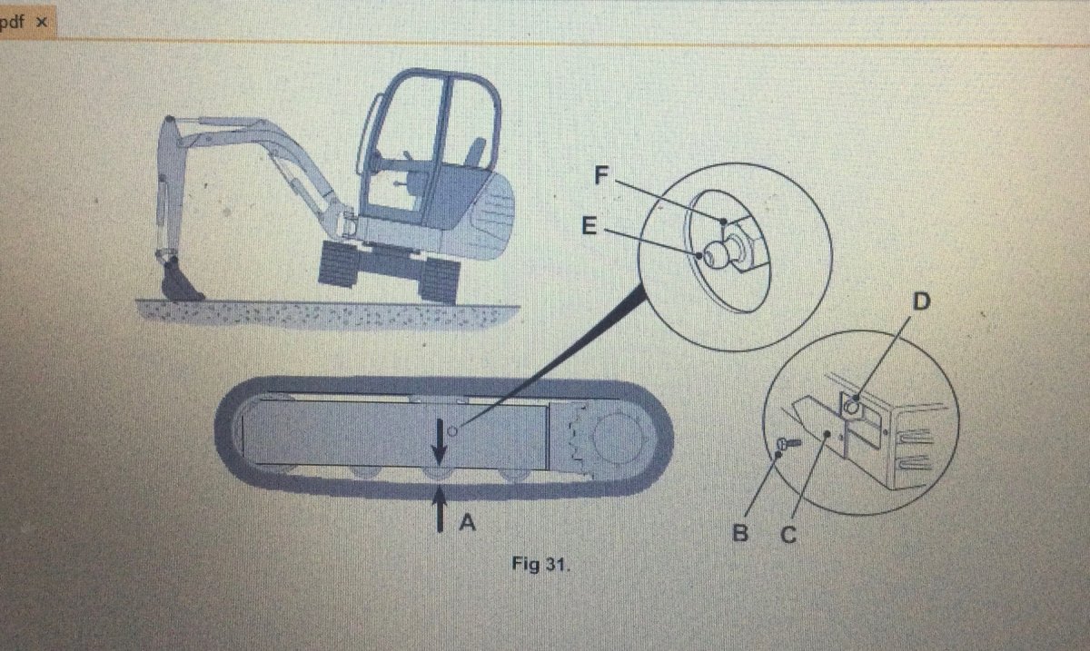

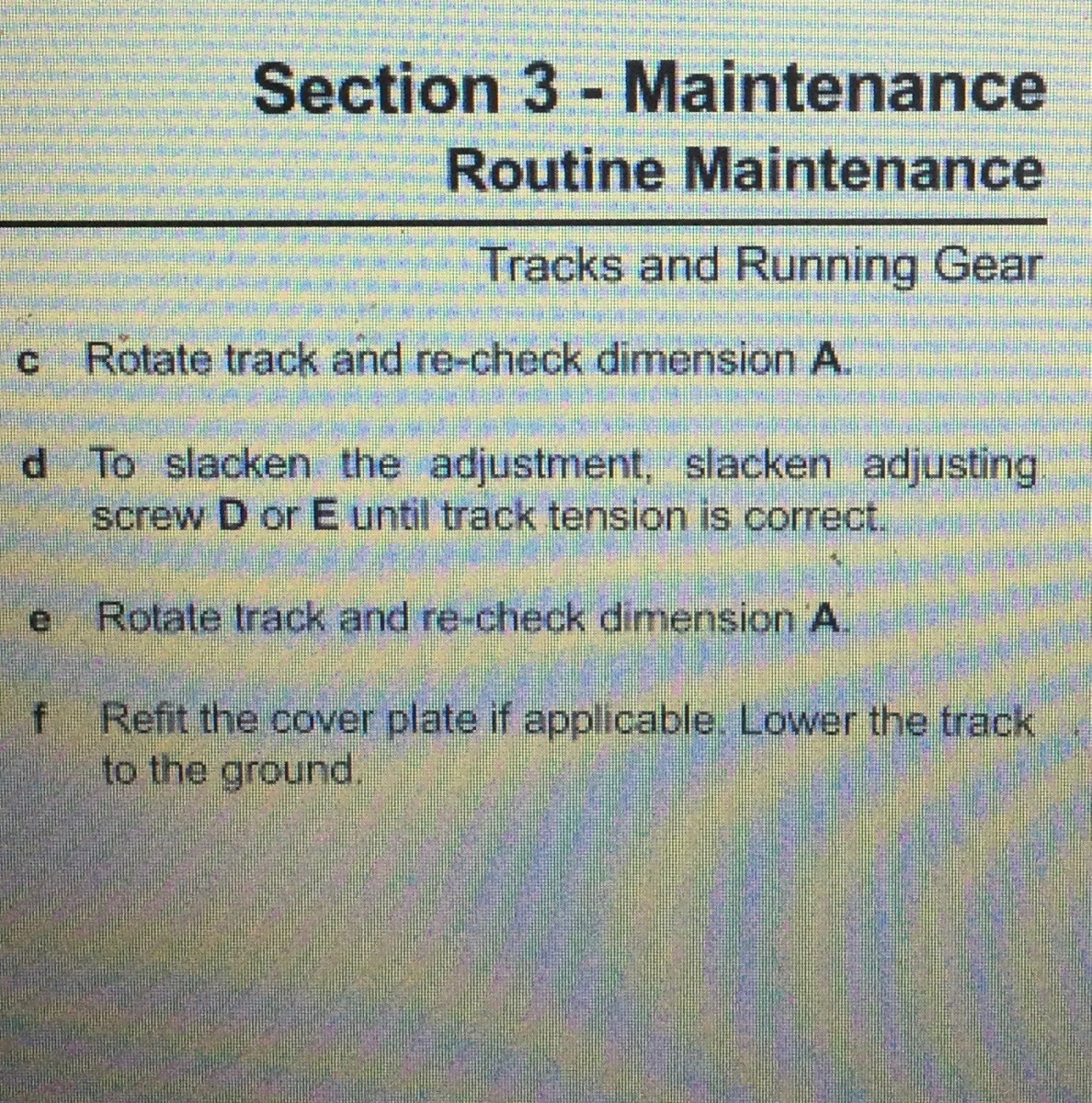

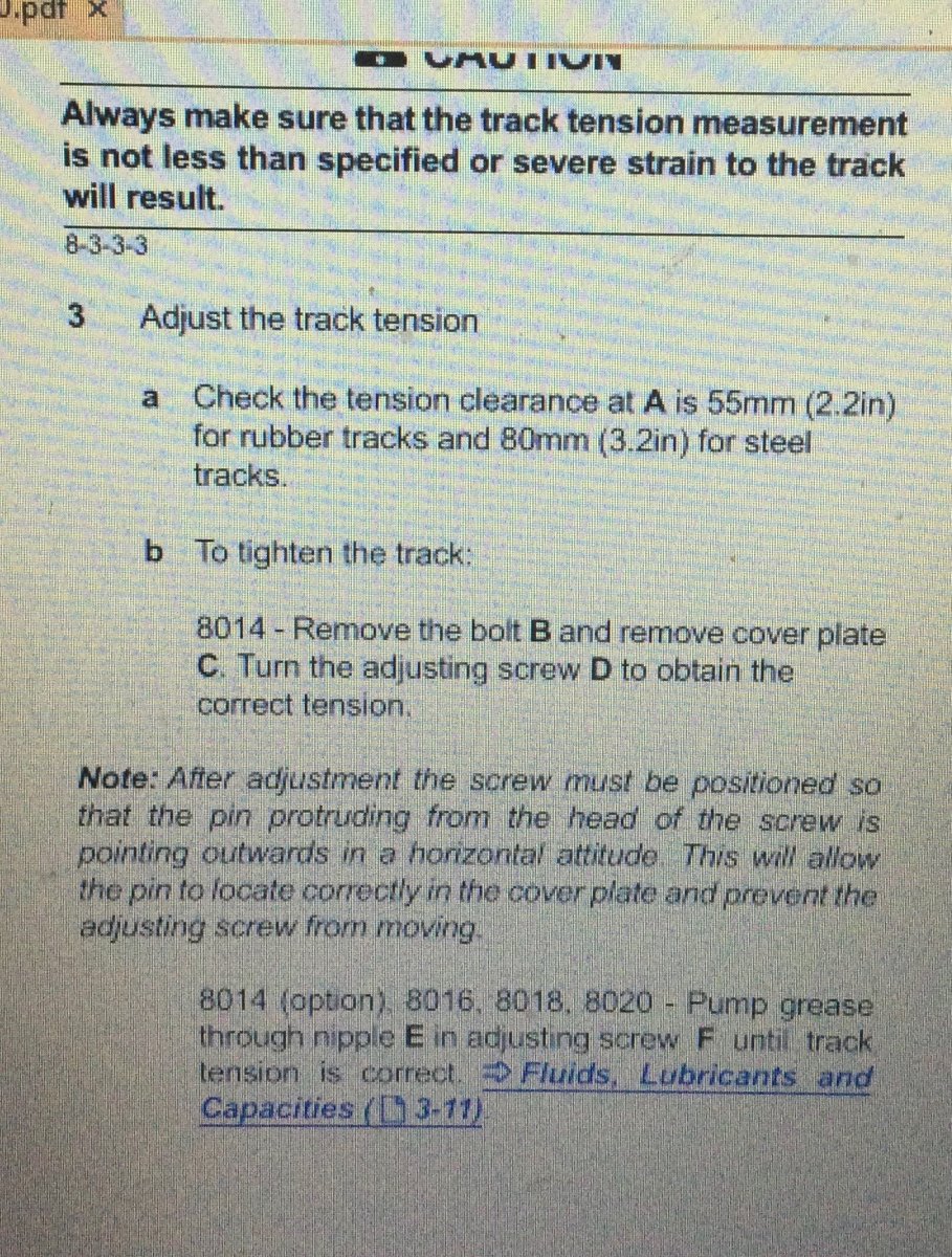

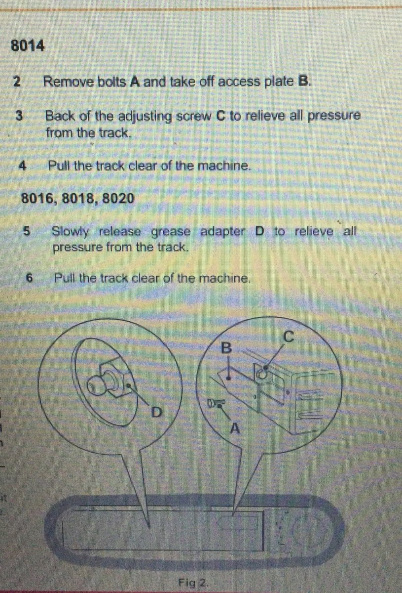

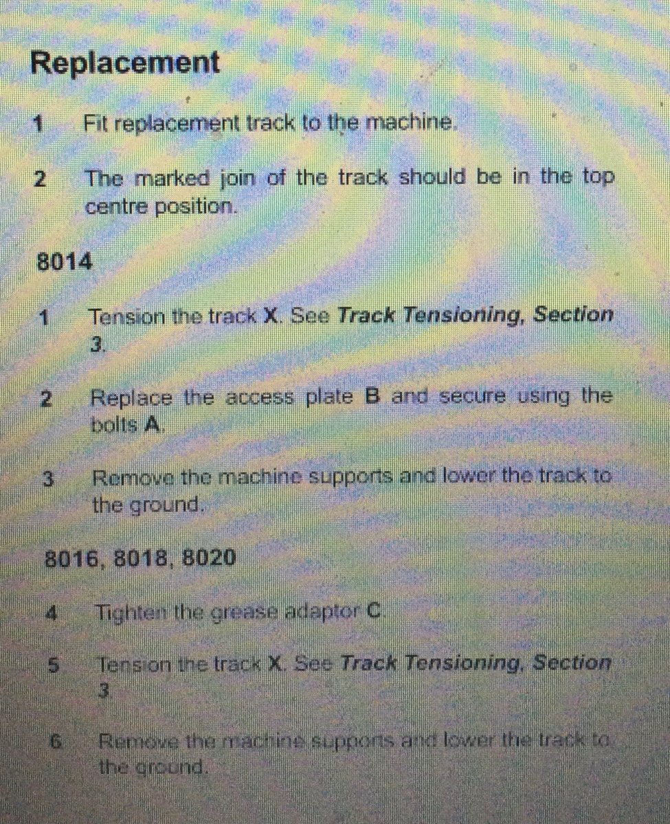

8014 track adjustment, the hex head bolt with the pin through is the adjuster, it would tighten clockwise and loosen anti clockwise, if the spring is full of clay it will leave the track tight even when de- adjusting, the front idler bearings need to be checked as they do regularly collapse and leave the track loose, tightening them will just cause further damage, if all is ok, lift the track to be tightened off the ground, turn the track to roughly where it is at a tight spot, rest a 14mm/ 9/16” head bolt on the track beneath the nearest bottom roller to the middle of the track, tighten the bolt clockwise until the bolt touches both track and roller. The pin on the rod was a lock pin and once it would have corresponded with a cover plate with a slot on the inside, the cover plates were sometimes left off. Hope this helps.
