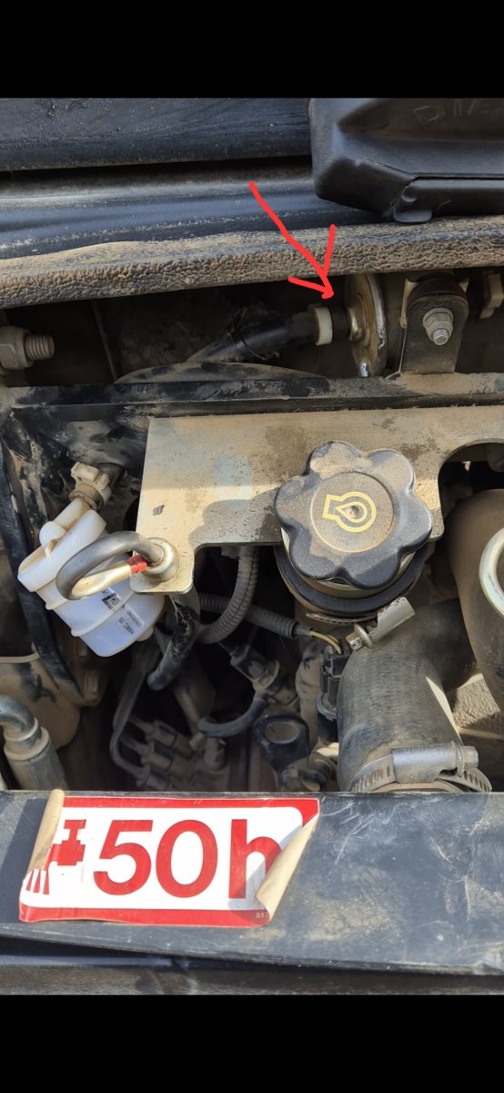

Electric fuel pump, the wires to it just out of view at the bottom, take left hand hose off and turn on ignition!
Could this be the problem ? i hear the pump noise but obviously cant be 100% it is working efficiently ? is it worth replacing that and the lift pump ?
That is the lift pump basically, unless it’s an addition, it might have a failed mechanical pump on the engine, but if this is the case you could bypass it and use only the electric pump!

I am over in the uk at this moment and so i can cheaply pick up a new lift pump and the mechanical pump on top of the diesel filter, do you think its worth buying and replacing both ?

do you mean the white plastic filter at the top of my phot on page 1 ? i have bought 2 of these ?

In the green circle is the inline filter, the red arrow points to the electric pump

Yes thats what i have bought, the white platic inline filter, will try that and if no luck will try the electric inline pump (red arrow)
