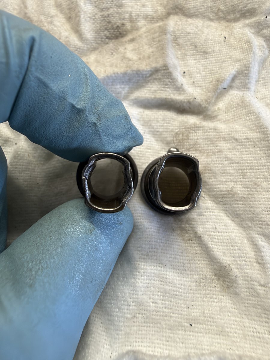

Photos when it’s in bits helps!
rossandson
Waiting for some bits but I believe this is my issues.
Mick-the-fitter
Mick-the-fitter
It’s what I do!
Pump element parts! Not supposed to be like that, one jammed they all jam👍🏻
