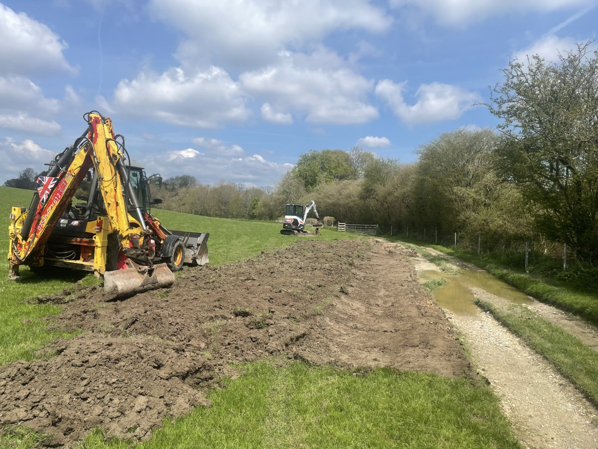

Ok, this is embarrassing but…
I’m really struggling with this backhoe loader. The machine is spot on, leads of power, all tight except one slew ram bush which I haven’t got around to yet. I just can’t use it effectively.
The other day I was trying to take from a ditch on one side of a track and place on the other. So from 90 degrees on the right to 90 degrees on the left. It just kept trying to tip the machine over. I swear my three tonner would have had no problem.
The front bucket doesn’t seem to hold any more than my Multione- the front edge is so short. It’s standard, wear edge all intact.
It grades lovely but only to halfway back/ I’m using the extendahoe and the boom at the same time. I guess this is because of the straight boom design?
Basically every time I take it out it puts a smile on my face until I start trying to actually operate it. It seems I can never have it set just right for the job in hand, and it needs so much space to manoeuvre even with the independent brakes.
I know practice and getting the hours in is key, but can anyone give me some more tips? It’s a great spec machine, with servo controls, soft ride, 40kph and a hydraulic hitch to the rear. I’ve changed all the oils and filters, it drives lovely and I don’t want to give up yet 😞 but it never seems the right tool for the job compared to my 2.7t and Multione loader.

for starters you want to get its feet in the air - properly airborne, so all the base weight is suspended on the jacks and the front edge - ish
have to say it looks a heavier boom than a Jake's, but if you're going 180 then park it centrally so it all happens the same on both sides ... and learn how far you can push it :LOL: Having a leg in the air over the side is par for the course - it's how much 'air' you have under it is the trick :giggle: .... Pam used to panic, watching me working over the side grading the side of our drive :ROFLMAO:
and fair play to you for putting this up .... there'll be loads of other more qualified advice I'm sure
Not sure I agree with getting it up in the air, the front bucket needs to be fully down flat with lift rams fully retracted but the back legs really only need to kiss the ground imo, my tyres only ever came off the ground on uneven ground! Then to reposition it was only a 2 second grab of the leg levers as your spinning the seat around to reposition.

know what you mean, but you really do need to have the weight suspended IMHDO, otherwise you've not got the full counterbalance available and it'll always hop about (same as a crane - it's full counterbalance is only available with all wheels suspended)
I've worked mine FOW, but it sure wobbles about :giggle:

I agree with dave on the legs. I never had them jacked high.
Sometimes side over if it was a quick bucket full you can use just one leg.
If grabbing a bucket full out of a transit tipper side over its leg free.
You've to remember your sat upon it. So movment feels massive.
Similar to when I first started with the grab lorry. You can soon have a leg in the air but when stood up there movement feels worse.

I didn't say you needed a foot under the wheels ... just get 'em off the floor so the whole m/c weight is suspended properly ... and yeh they're workable FOW as and when needs must .. but a lot more exciting

Alot also depends on floor your putting pressure on.
I remember one day, bit of a slope, it felt like it needed abit more leg down. Pushed legs and nothing happened. It was that soft I'd already pushed them all the way down.
