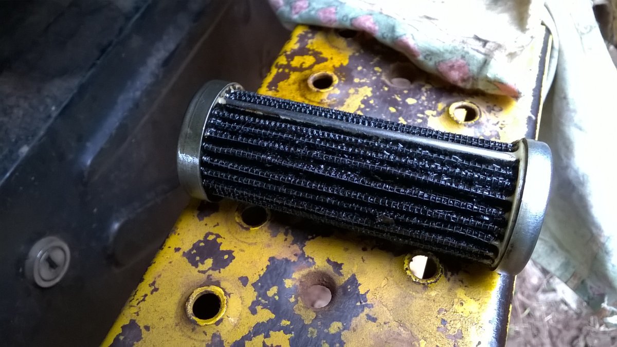

Have you checked servo filters in the hose line to the levers P ports on the underside of the levers
there may also be a filter in the servo control solenoid block/valve too (which is operated/controlled by the deadman switch)

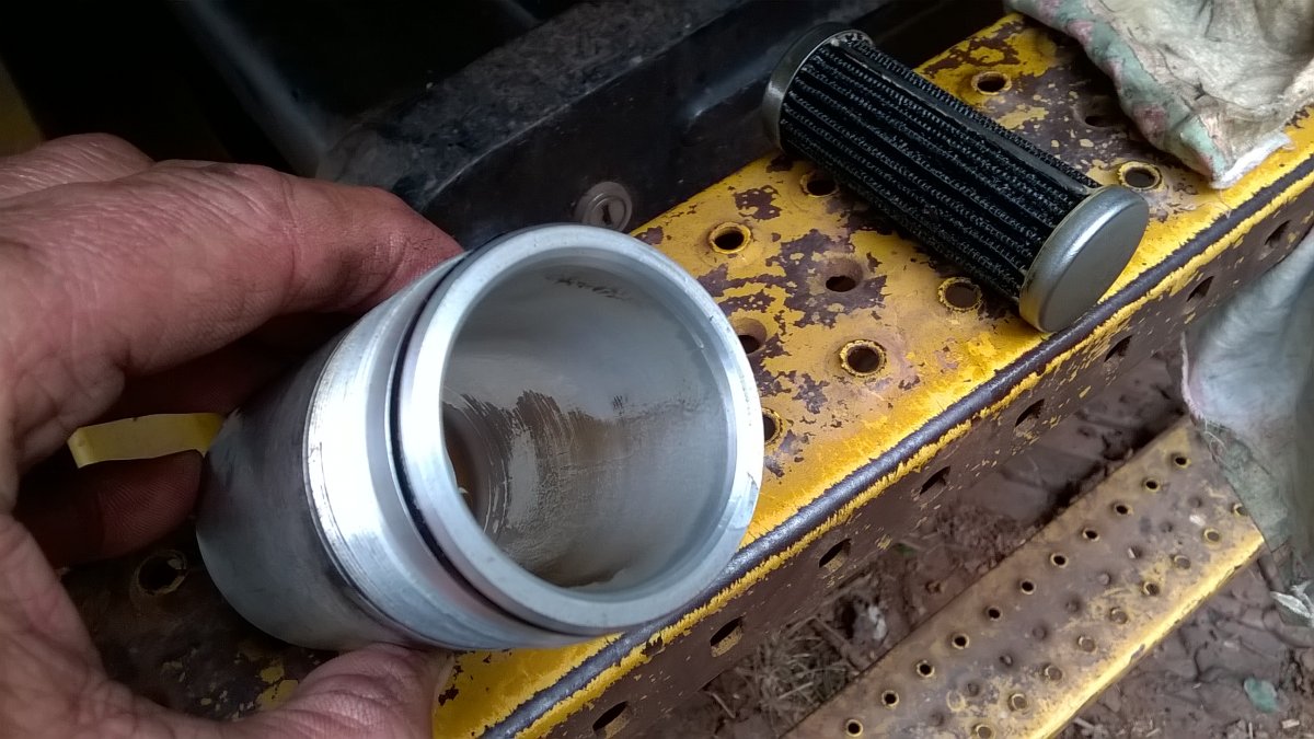

My 'Drema has a sizeable filter in this location
this filter housing screws into the valve block body which the servo cut off solenoid is mounted in, in mine ... may well be a separate filter housing in the servo circuit somewhere ?
don't have a pic of the valve block, sorry
That filter would normally be light grey, she might be a bit blocked
