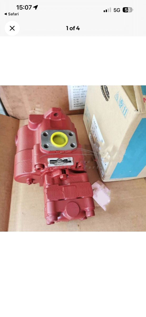

Photo of the pump please
is that a generic piccy?
or
you had the pump rebuilt by a third party ??
if the latter - chuck it back at them as there is obviously an issue

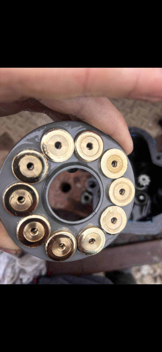

stripped pump down tonight and found out the retainer ring is cracked and bent and a few of the slippers are worn down… I see a lot of brass filings in the oil so going to have to flush that all out 🥺
What do we reckon now ? Why has this happened
above Q.s still stand
or

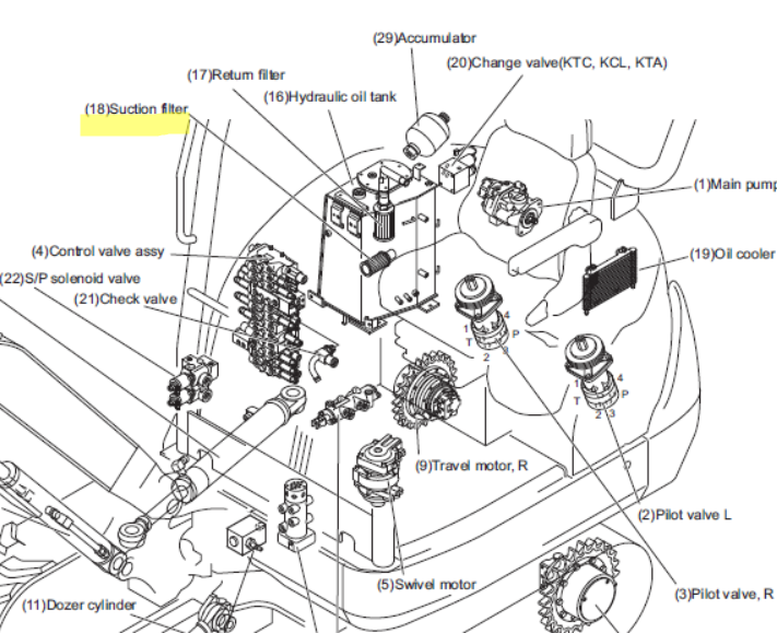

I can’t even get a good pressure reading atm because it won’t give me a good enough consistency to read if you understand me.
Do you mean the needle is bouncing up and down so you can't take a reading?
The Hydraulic Layout Diagram shows a suction filter in the tank, have you checked for blockage?
Sounds like the pump is cavitation (or sucking air) (in addition to it's other problems).
I'd start by pulling the return filter to find out what sins are present there.
Sorry this was a generic picture I had. I rebuilt myself. Need to order new parts as of now
without wishing to sound impertinent ... summat didn't go back together right to cause that level of damage in so short a time ... everything needs to be literally surgically clean before and during assembly and all components 'in tolerance' ... a grand's a lorrabucks to have to spend twice :cry::cry:
I’m beginning to question the quality of the rebuild kit. It was from Chinatown direct. As I said I have rebuilt these before and had no issues with using the genuine parts.

Ok is the plate holding the brass parts actually straight? End on! From the side, so if you pulled all the pistons out and laid the grey bit on a flat surface is it flat?
