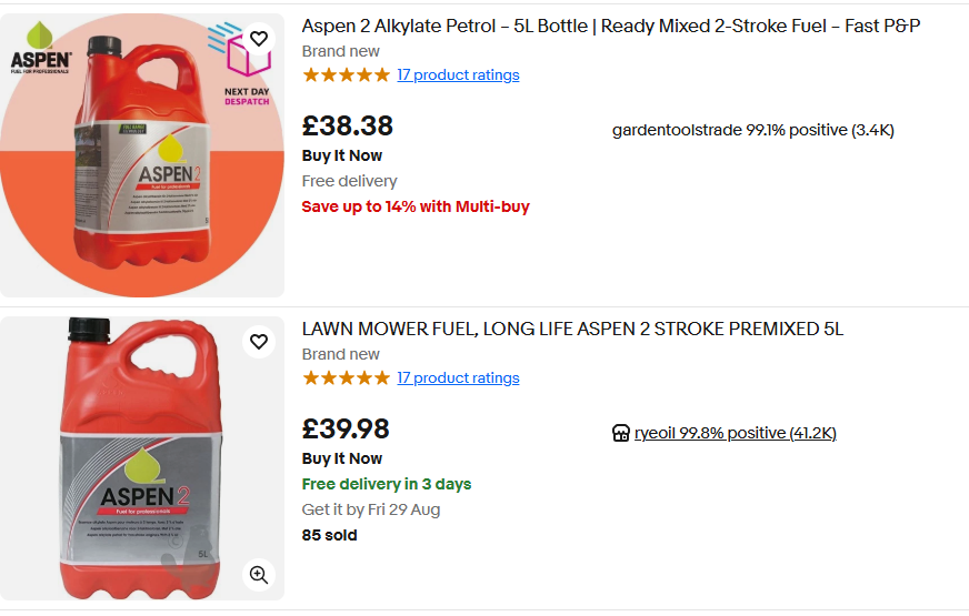

's possible .. I use Putoline MX5 in all my 2 strokes .. have for the last 45+ years ... it's a synthetic though so might try a switch to mineral :unsure:
Ah
But that's eBay...
I pay around 23iirc per 5L.or less for 25L.
which is what I thought it was - ebay prices were a shock!! :oops:
's bad enough keeping them all fuelled at E5 prices :(

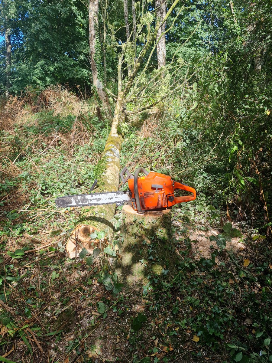

I must be lucky I never really get issues from fuel storage. My Husky was sat in the shed for years with petrol in pulled it out and started and ran like it was used yesterday this was 8 years ago only used it a few times since until today was a proper run for it. Not been an issue until I started treating it 'properly' i.e running it until theres no fuel in the system for storage since then been a pain in the arse. Like today ran lovely until i stopped for a break now cutting out at idle the tw@t. Admittedly my Mcchullochs fuel line was ate from petrol being sat in it but everything else has been good. That tree was an absolute knob to get over today had all my wedges and an axe head and still wouldnt go had to cut the hinge in the end top branch just got caught in another tree.
