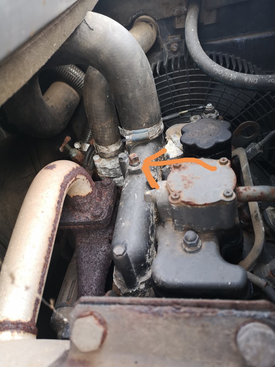

I have also seen impeller doing that, at least if no flow you know straight away, there is a tap beside thermostat housing that switches of flow to heater make sure that's open to increase water circulation to see if it makes any difference
Is it using water? If your going to the hassle of taking water pump off to check impellor which may seem ok when cold anyway I'd price a new water pump first. If not silly expensive might be worth changing anyway while you've gone to the hassle of removing it.

Issue is as soon as you start ripping something to bits you can't diagnose it....Temperature issues have 4 general causes - Airflow, Water Flow, Constrictions and Outside Heat.
My guess personally is it's a outside heat issue, either via the hydraulic oil cooler or Head gasket. Water pump seems unlikely as 10 minutes should not heat the coolant up that quickly, the Merc 1317 that had that issue would do a 30 minute trip before it started boiling.

Looking at it, it seems to be Yanmar 3tna engine, when running does it black smoke when you use any lever?
Mick-the-fitter
Mick-the-fitter
Had plenty of tan’s running with head gasket gone between the cylinders, run fine, til under load, the one hard working cylinder, runs black smoke and gets very hot trying to drive everything, and push the lazy two up and down, (compression test)

Sorry I've only just seen this.... If the offer is still there I would definitely appreciate that. I have the combustion test kit, there didn't seem to be any air coming out of the rad (which I guess is good!) however feeling the oil cooler rad when the engine is hot, I can touch it easily and the inlet/outlet pipes seem the same temp(just very warm, not "boiling" hot.
The heater is blowing hot air👍
