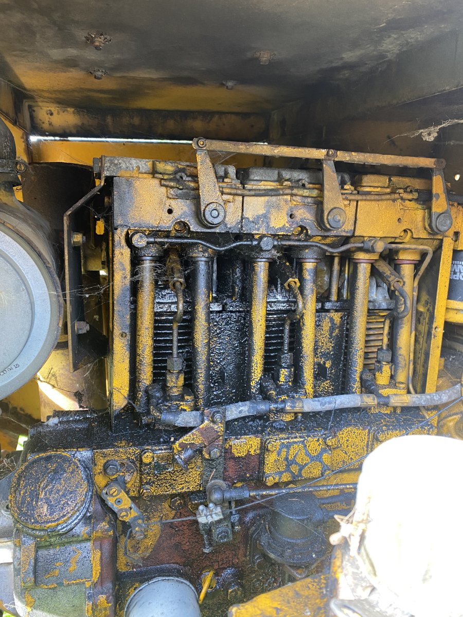

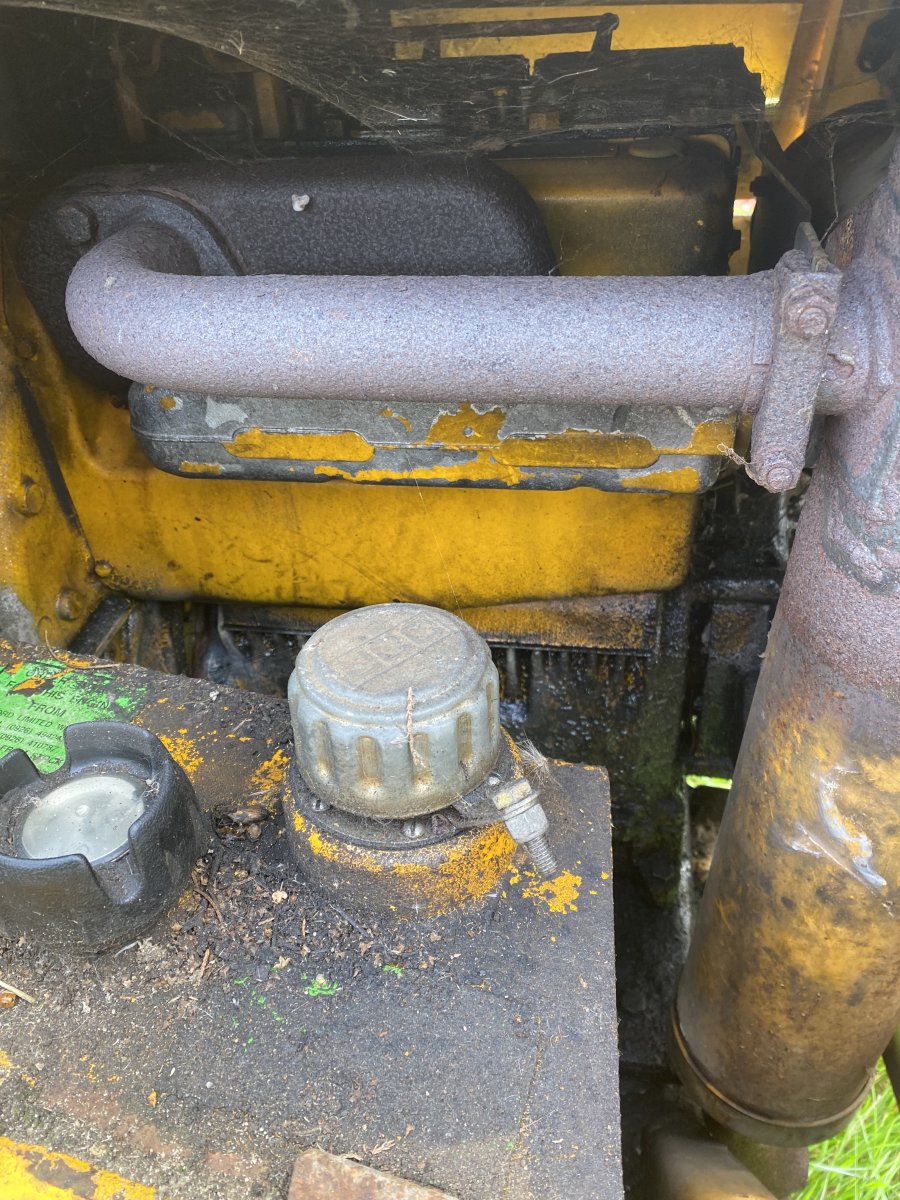

I’ve got an Mreg benford 3000 dumper as far as I can see it’s air cooled as got fins on the engine is there anything else that keeps it cool as it seems to be getting hot now
some better pix would help, but get a good air line in there and blow everything out to start with and an idea of what engine it is ?
depends on whether it has forced cooling (with a fan usually) - it desperately wants a good clean and all the crud which will have accumulated on all the oil spillages blasting out of the cooling finning.One side of the engine is partially covered so doesn’t that stop air flow
I thought there would be a fan but nothing theredepends on whether it has forced cooling (with a fan usually) - it desperately wants a good clean and all the crud which will have accumulated on all the oil spillages blasting out of the cooling finning.
in a cowl, ducted into the engine's covers - if it ever had oneWhere would the fan be
That'll be to guide the air around the cooling finsOne side of the engine is partially covered so doesn’t that stop air flow
Ahhh - I think we have a winner.and what yours may be -Lister triple
