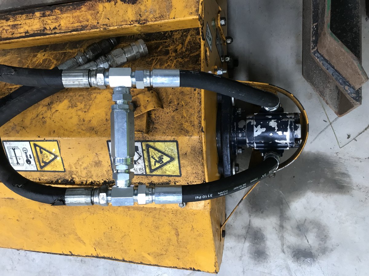

Trying to find a seal for the Parker motor on the cutter, afew companies have come back with nothing, others have said its a Parker/Bomford only part! Quoted £580 for a seal kit from main dealer and £132 from a Parker dealer. I only need a seal with the code
‘CFW A1
BAHDSNSL 1.5
17.47 - 30.16 - 7/5 ‘
I can find seals with the odd size which is correct but the other dimensions are all different! Any ideas??
Give P&R Hydraulics a call.
‘CFW A1
BAHDSNSL 1.5
Sorted! Full kit £54 👍🏼 Cheers 🍻
