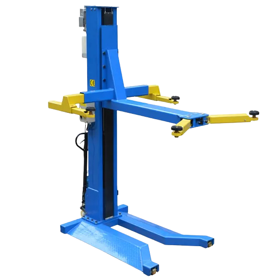

I didn’t know you could move them ! I did think about one of these but I thought that every time I’ve had a shot of one the bloody wheel runs are always in the way
That was a concern , that’s why I thought a 2 post . I think if it needed to come down it could .
bear in mind that they have an overhead connection to each other ;);) can't just unbolt one leg out the way occasionally
I made a base for it Vin .. 300 x 90 PFC and bolted it to that ... could then chuck it anywhere (as long as it was flat/level)
I’ve always fancied one but I just know it would be in the way 99% of the time!!
Plenty of mobile options now. Someone was servicing an 8t machine on one of the hgv sets on Facebook the other day. The type with one person wheel.
I was thinking something like this. The 5 tonne base plate version .
A friend of mine has one of those in his garage. When pouring his floor, he shuttered it so that when not in use the ramps sit flush with the rest of the floor. The control cable runs through a duct to the controller in the corner of the garage.
