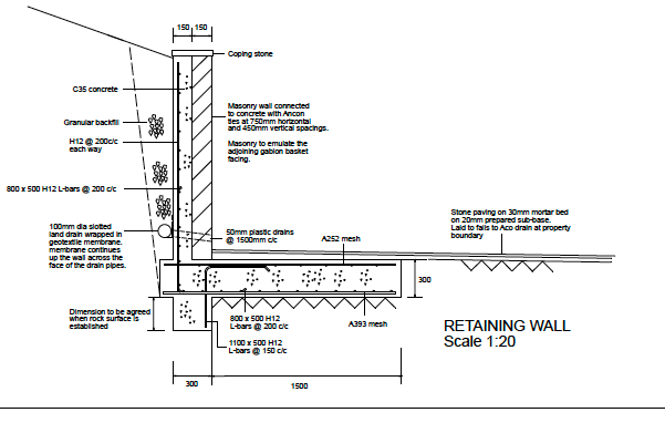

That's my thoughts too. The foundation spec for a hollow block retaining wall can get ott without being silly high and thats full length of the wall.

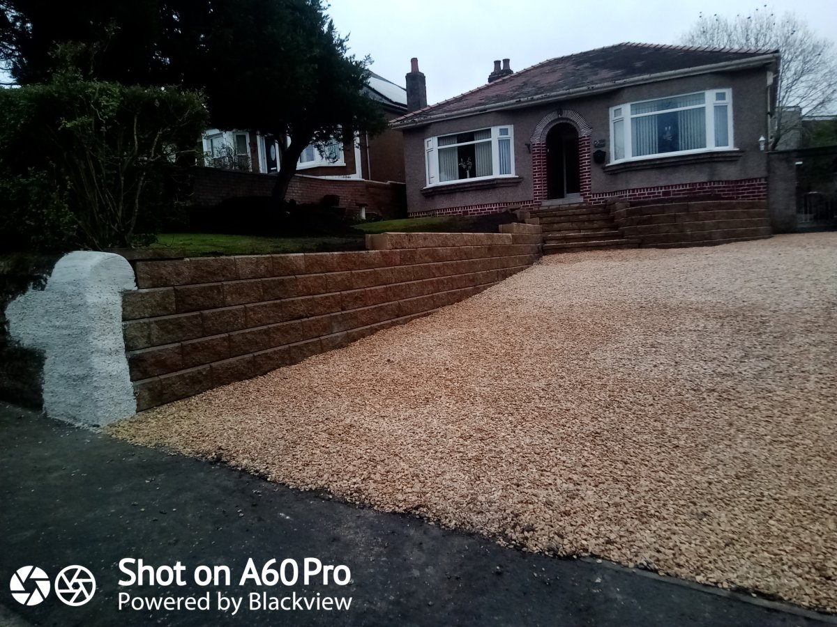

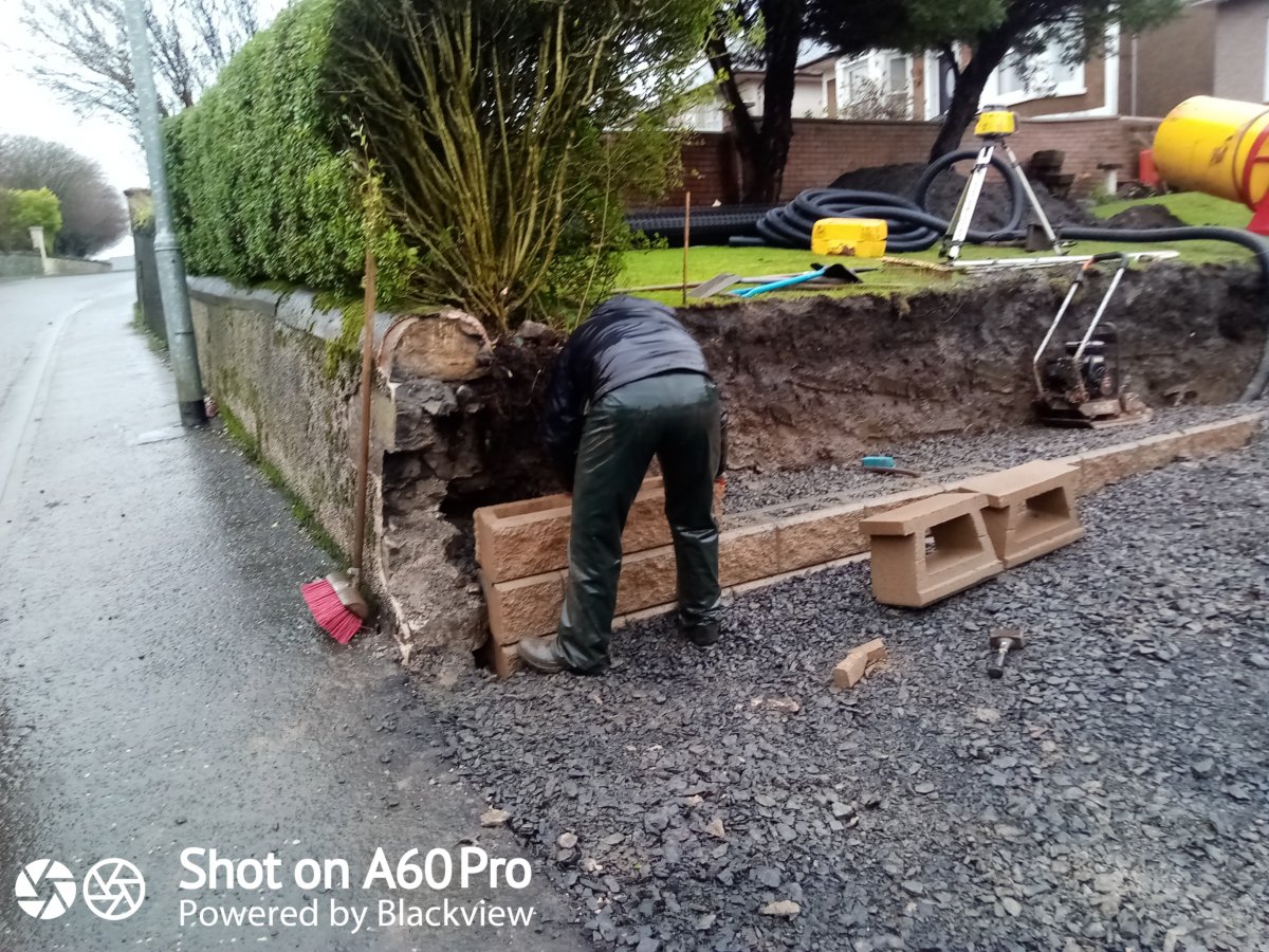

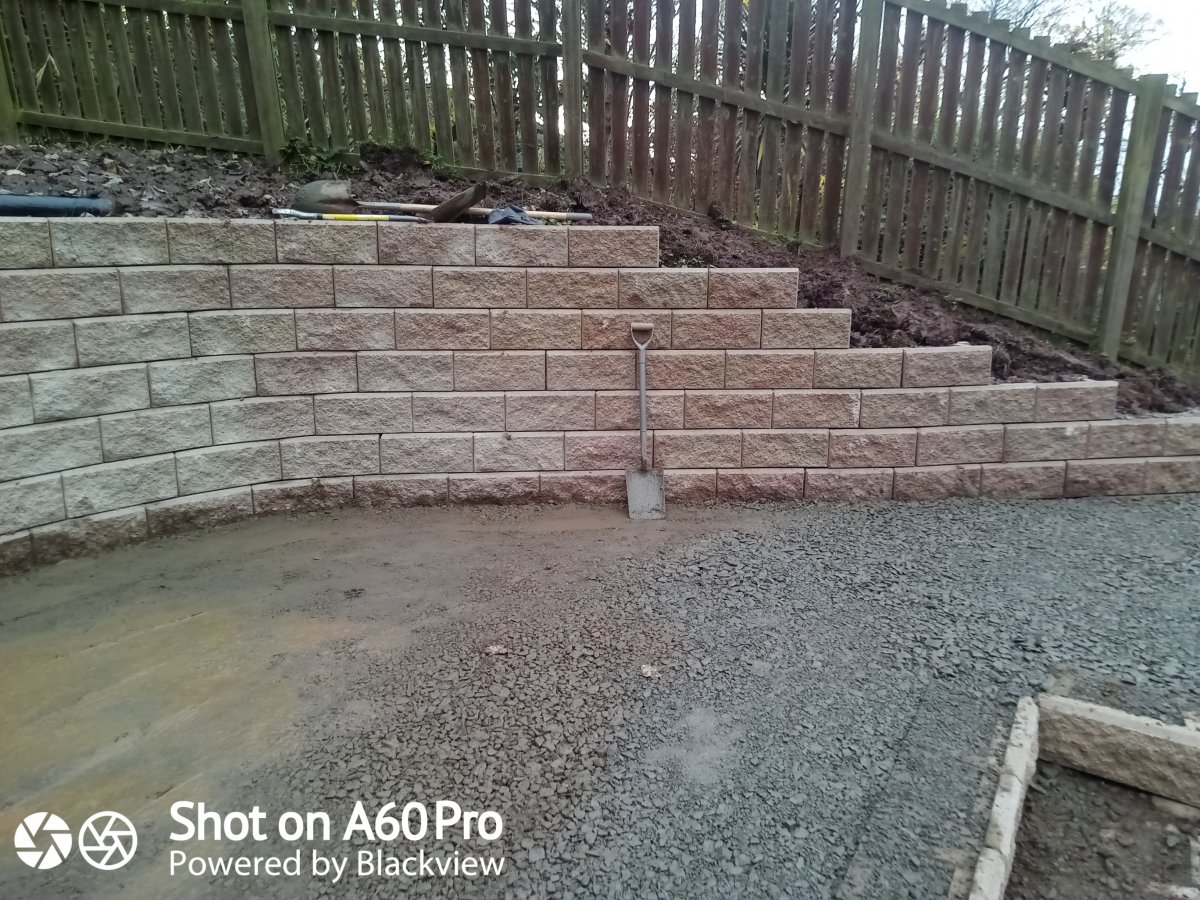

i did a couple of jobs with these blocks fill them with gravel and put geotex between the layers if you are going over 1.2m look excellent not the cheapest but a realy nice job
Got any more information/pictures on this. Are they concrete. How heavy are they. I've got a grab for the digger so would be handy

@Antony Holmes have you got any more information on those blocks, ie name/supplier?
We are looking for a retaining wall in our garden and quite like the look of those blocks. Initially had planned to use hollow concrete blocks and fill them with concrete once the wall is up.
And what sort of foundation are they on? We plan to have a hedge in front of the wall so can’t really have a massive toe as on the drawing in Giles’s post.
Lego blocks soon add up in cost mind, that's without handling if you haven't got the machinery yourself
