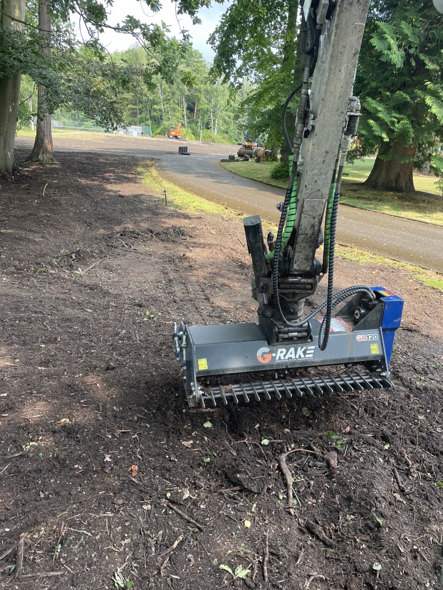

Does anyone have any experience of these? We’ve got a decent size turfing job to sort and I’m trying to decide if one of these would be a good addition to the attachment pile!
The principle looks good, but depending on the type of finish required the operator would need to be able to grade pretty accurately, maybe a job for iDig?
We used to have a Bleck stone rake behind a Kubota tractor which did a nice job, you could set it up to just flick the stones of the top into windrows and keep working them across.
Always amazes me how many stones come out of even the cleanest looking top soil😡
I can't see the point at all. It's painfully slow compared to either a stone burier or a Harley rake on a compact tractor. Why oh why would you use something hydraulically driven on a digger, with all the hydraulic losses, when you need also be grading accurately- which will be made much harder (even impossible on some machines depending upon how they flow share) by the extra demand on the hydraulic system?
I’m coming to this conclusion myself tbh, something pto driven on a compact would undoubtedly kick its arse!
I was quite excited when i first saw them. But as others have said, I want the stones buried not flicked up to have to pick them up!!

I brought one at Christmas & have only used it a few times.
It needs to be bone dry to use it & doesn’t like really stony ground because I’ve bent the scrapers for the packer roller when it was wet & stony
I was after a rotovator or a power box rake to fit on the digger but no one was interested in supplying one only avant kit then I see an advert for this & thought that looks just the ticket but I’m still not convinced

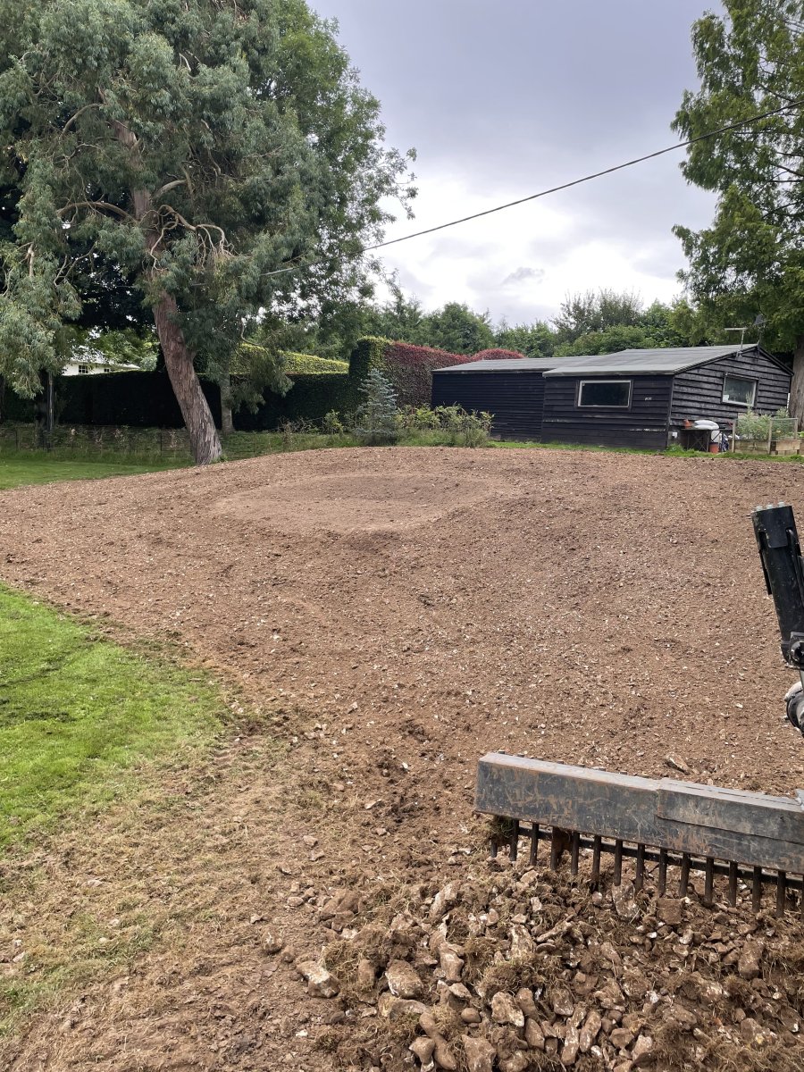

I just finished a job of filling in a old fish pond & top soiling 150m2 of garden & get a better finish by levelling top soil out with grading beam, tracking it in & then scratching it back up with a spiky bar I’ve got & then hand raking for a perfect finish

View attachment 50131I brought one at Christmas & have only used it a few times.
I just finished a job of filling in a old fish pond & top soiling 150m2 of garden & get a better finish by levelling top soil out with grading beam, tracking it in & then scratching it back up with a spiky bar I’ve got & then hand raking for a perfect finish View attachment 50132
