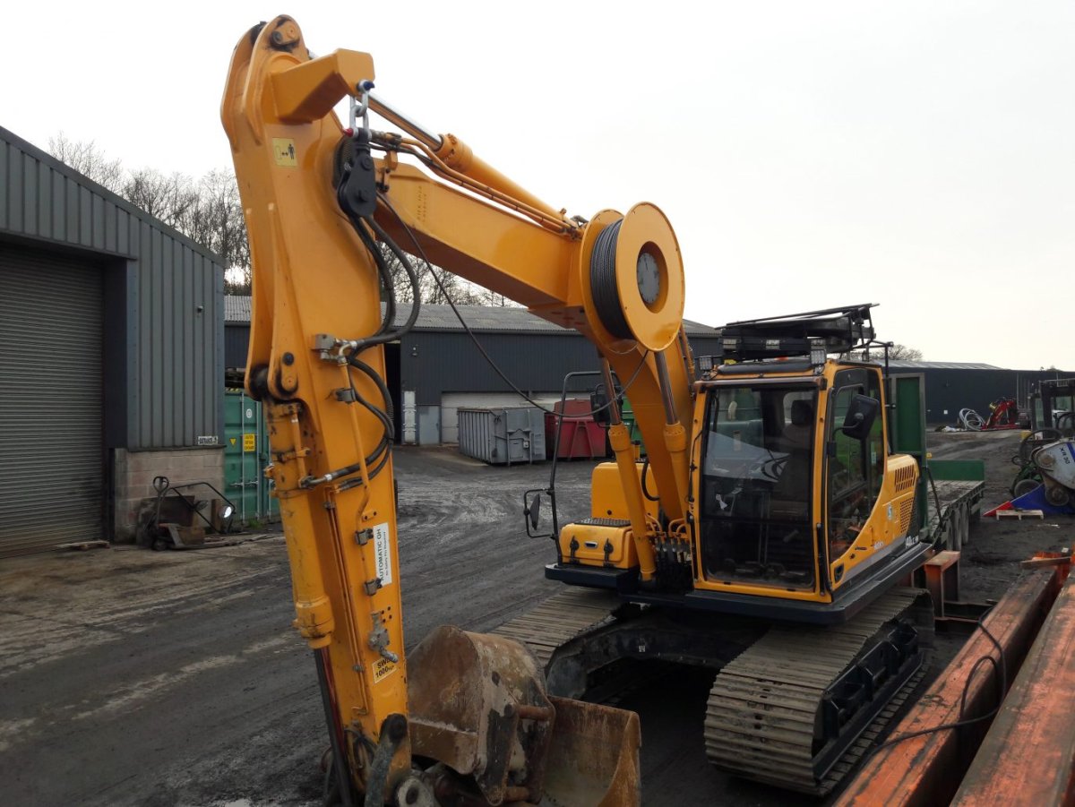

Ref the winch - drum up on main stick, pulley on top of dipper... I'll find a pic...
