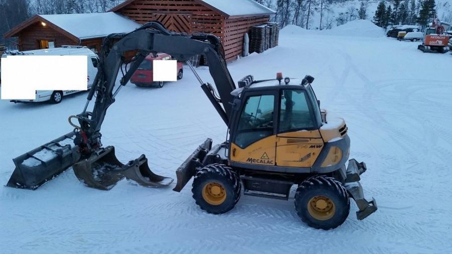

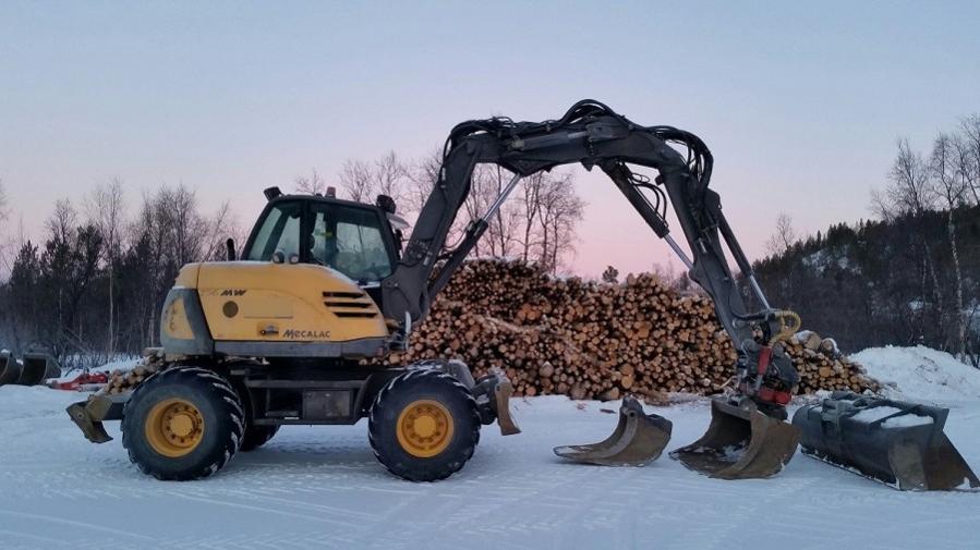

was very tempted to 'bust the budget ' back in 2012/13 with this ..... IIRC was £30/32-ish k ... Owner op in Norway .... Frank'll probably remember it -- recall he was up for a viewing, but it went quick :(

That's a fair machine, I'd prefer a Steelwrist on it though ;) I put 4 15's into Flannery last year and as far as I heard they were getting on really well with them, although they had bought them specifically for lifting on HS2.

There was a really nice 714 for sale recently from the Netherlands, 710mm Nokian tyres etc, I think it sold for about £34k which would have been a bargain as it was one of the last built and had a lovely spec, albeit no tilty.
