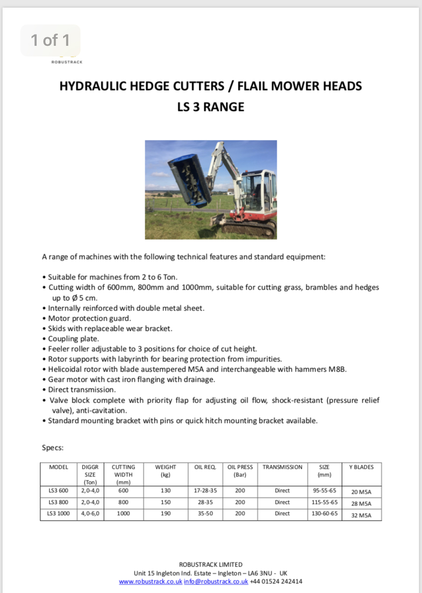

Anyone had any experience with the flail’s from Robustrack LS3-800 ? Or any other suggestions? I guess there wouldn’t be enough flow to run directly through @Engcon UK aux line?

We supply the Femec range of fails, which can be specced with a motor to suit your flow. I run one under our RT10 but not from the aux line. Main reason I didn't change the motor to suit the flow was because I use the flail on a 6 ton aswell. I also hire/demo it to customers so needs to be more universal. If Robert can give you the flow you'll have, I can get you more info on the flail with a motor to suit.
On a side note... it's not as bad as you may think running them with long hoses past the tilty.. if the hoses are kept right.. and you remember not to do the full 360😁

20 lpm on that one. As Aiden says, as long as you remember to take your thumb off the LH roller and you have an Aux line (ISTR you just had a hammer circuit, but I may be wrong), then piping round, rather than through, the tilty may give you more options.

Cheers for info, no i have a double aux line and JC fitted T’s on line with quick release fittings to allow for attachments. (y)

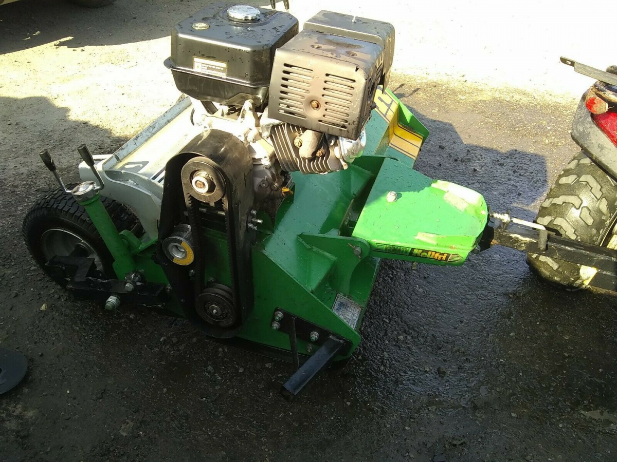

tripped over this last night - again in seller's other items :rolleyes: - make an interesting unit for a smaller machine ;)... leave the motor on it, whip the wheels, draw bar, etc., off and bang on some pick ups :unsure:.... would give full machine controls and full flail power - all the time (y)
https://www.ebay.co.uk/itm/Kellfri-...quad-Engine-new-belts-and-flails/113783191852
