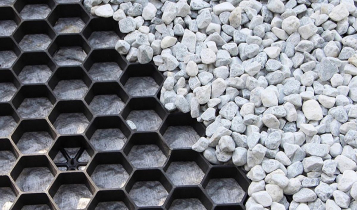

Had a client interested in this product, had a few over the years in fact, but the latest client seems to think it will be better than the usual, geotextile/stone/gravel we do at present.
Anyone used it ? Is it a pita or any good, or even good but pita :) ? Opinions please.
Is that 25mm stuff?
We are about to do a drive the prices for the grids vary between 1300 to over 4k!
Is it all in kinda material? Anymore spec on it?
Tbh convincing them to use any for of gravel grid is usually the hardest part 😂
I've used Coredrive 50 on domestic driveways a few times, works really well but has got really expensive now with the price of plastics gone up since 2020.
Easy enough to lay though, good product.

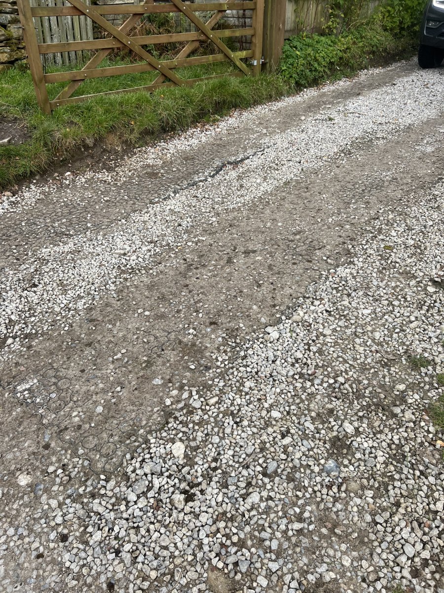

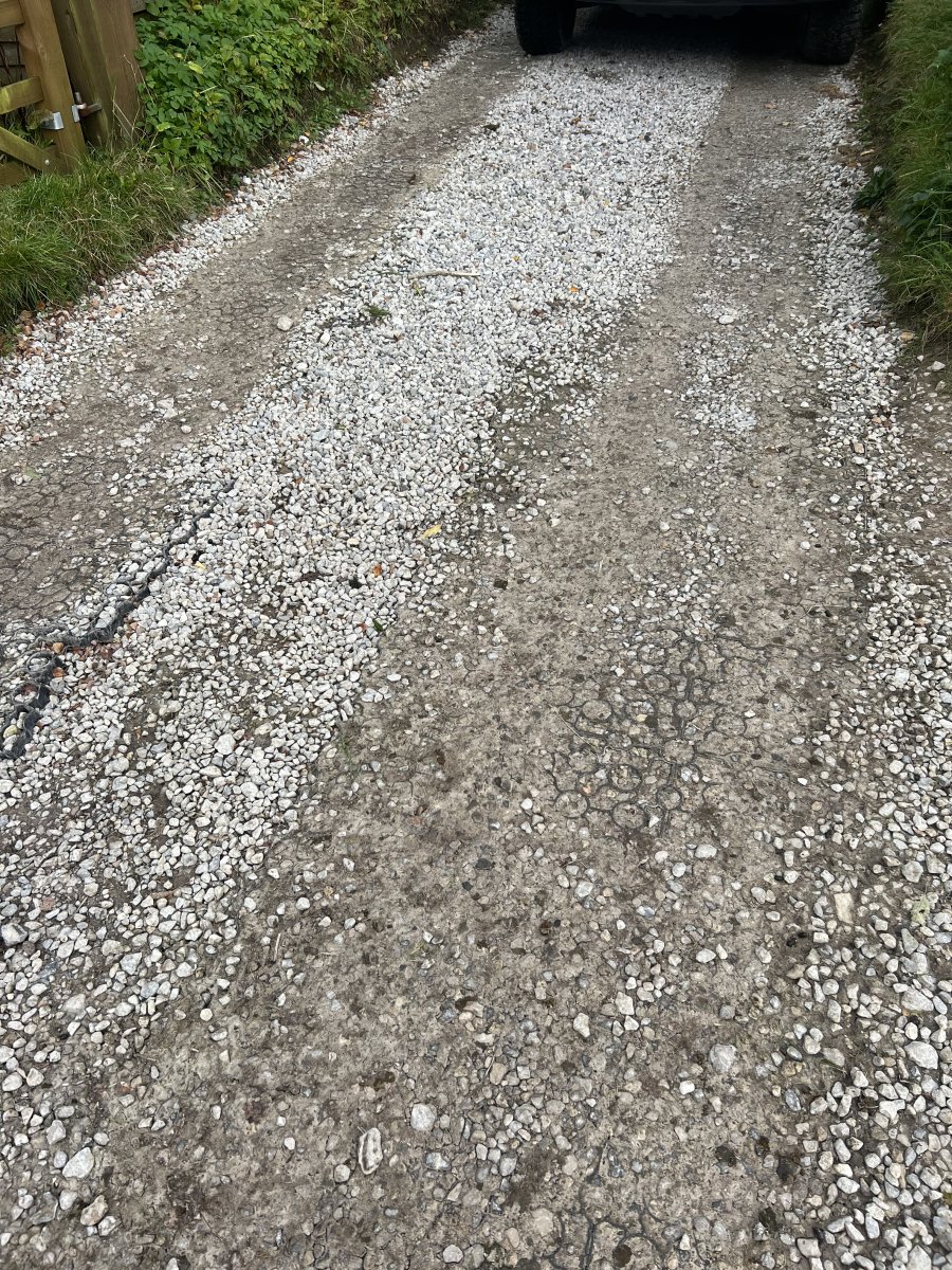

Did these ones recently to fix a rutting track on a camp site and this is them after a busy season. Before was 6-10” wheel ruts from traffic and water run off
Ive always dug them, laid geotextile then about 10cm 0/60mm - 4-5cm of 0-20mm and finished with 3cm gravel.
Never had any rutting with that spec tbh.
