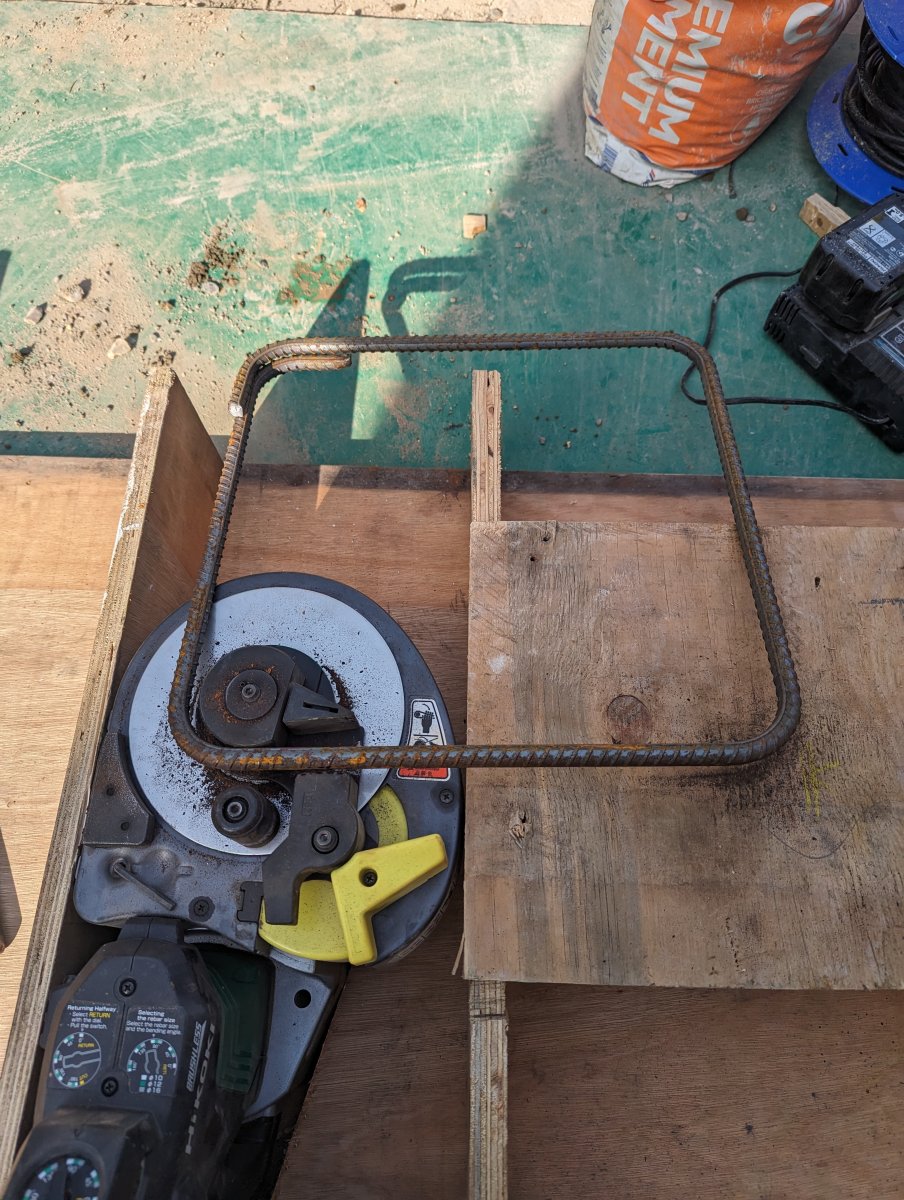

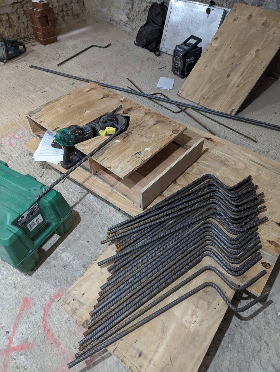

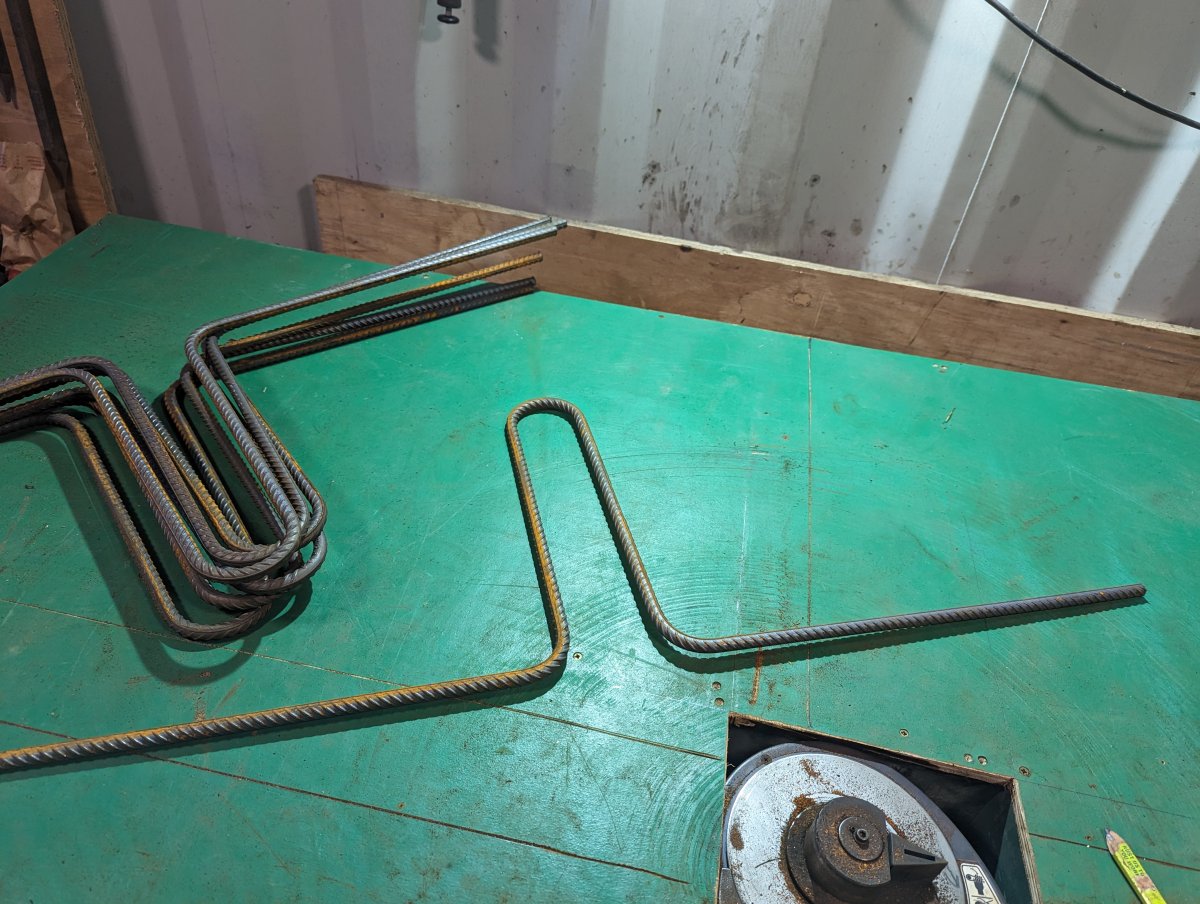

Have a look at the Hikoki
Cuts and bends all on 18v, very handy bit of kit. No idea where you'd hire one from but could be worth buying outright if you do enough reinforcement work.
It won't cut in situ though if that's what you need.
You'd be welcome to try mine but I'm not local!

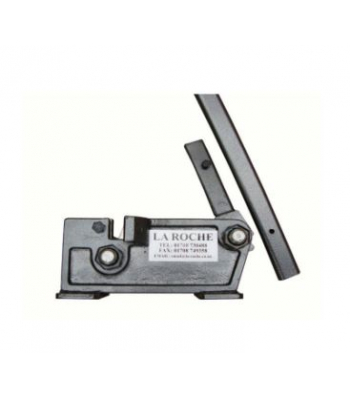

There's also these manual cutters which are glorified bolt cutters but more hefty, can be bolted down to a lump of timber so you can get your full weight into it.
Looks like a lot more graft but way cheaper

Have you got a lot of 16mm to cut or is that your biggest bar?
Can you not increase the splice to avoid cutting all together? or change the schedule.
Manual benders are create for up to 12mm but after that its still possible just takes a lot more effort, usually involves a scaffold tube as a longer lever and that you have the option of using on a bench on the horizontal.

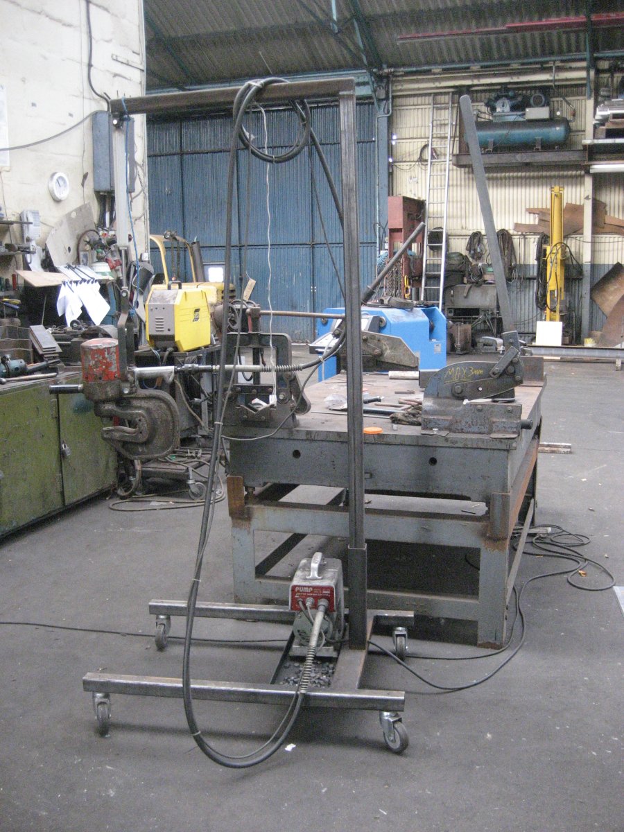

used to have a few Nitto Kohki (what was Hikohki) hand held punches -- were very good, reliable tools
