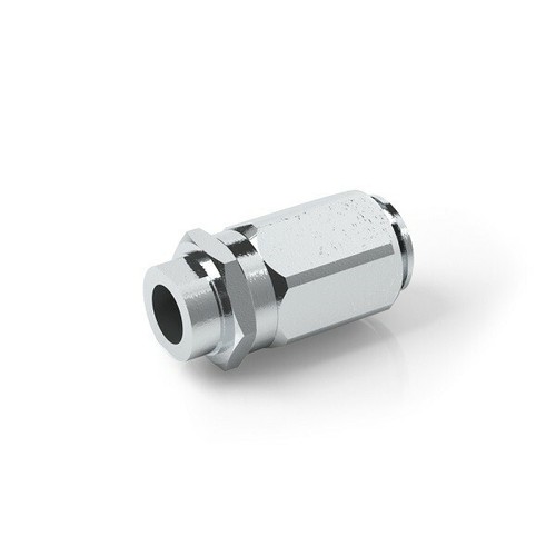

Is that a 1/2" Male / Female? Would be ideal if so as I can squidge it between the fittings. Reading the instructions... would I need 2 of these?

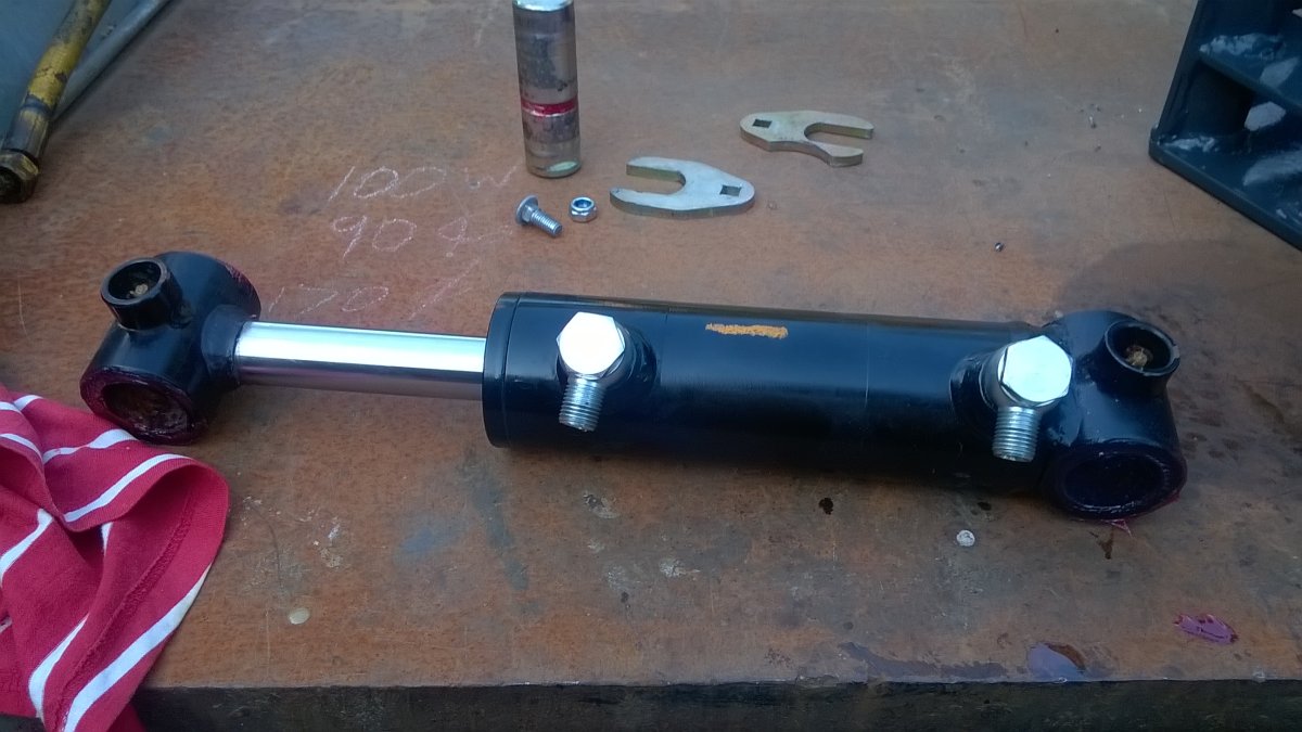

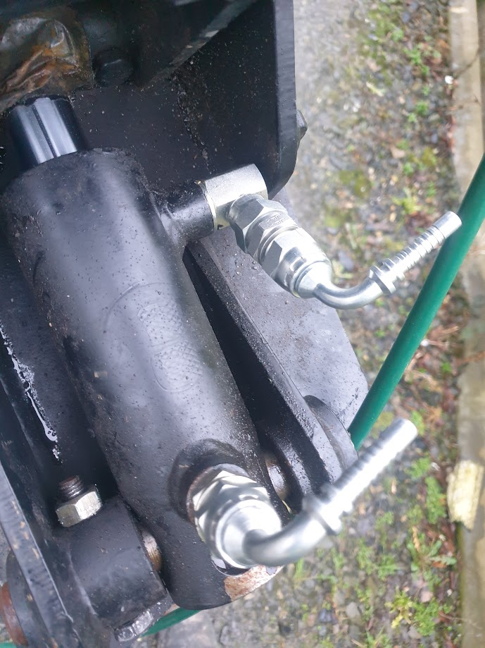

Todays Job. One trip into town to get some fittings, had to use one of our kero fittings to squeeze in between cylinder and frame as very tight. Mocked it up with 10mm plastic pipe then back in town to get it pressed up. (Only a mile away). Removed the welded nut and bolt from the back of the quick hitch and drilled it out for a bow shackle. Bucket feels almost made for the machine as it won't touch the dipper or boom in any position. Bit sloppy on the QH though, so might try fitting some lynch pins on the dipper pins and pinning bucket on direct to see how that feels as well. Its very lively on the Aux Pedal so need to sort the pressure regulator next as others have advised.
What Doobin said is ideal, only need one fitting 👍🏼 only use it on the tilt bucket, once it’s flow is set you can forget about it.
I'd have done that with a banjo as it would then be completely adjustable for position and a bit more compact too
as said, only one required - put it in line behind/after the hose QC to the bucket ;)

Yes I'm upto speed on that one now. A quick scan of instructions suggest it's only restrictive one way? The ebay one will fit nicely .
Didn't have one of them 😕 and neither did suppliers.
keep an eye on your elbow as it's 'loaded' by the hose, which will be constantly moving and will tend to slack the elbow off
did they not have a banjo adaptor either ? banjo to male adaptor like on this cylinder ... very handy to have a couple sat about
once set it can't 'magically' open up for the reverse flow - it will restrict in both directions -- it's basically a needle valve and seat, in line instead of across the line of flow
