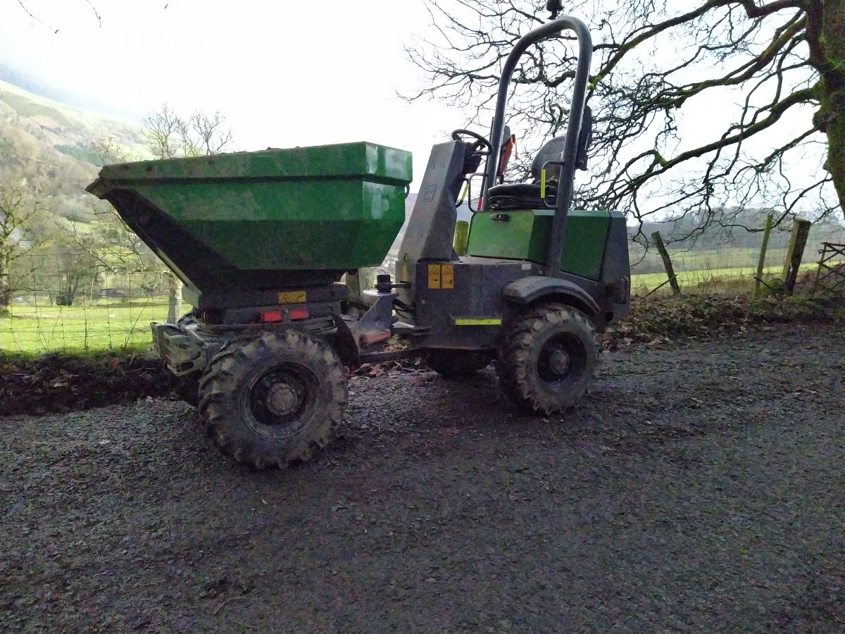

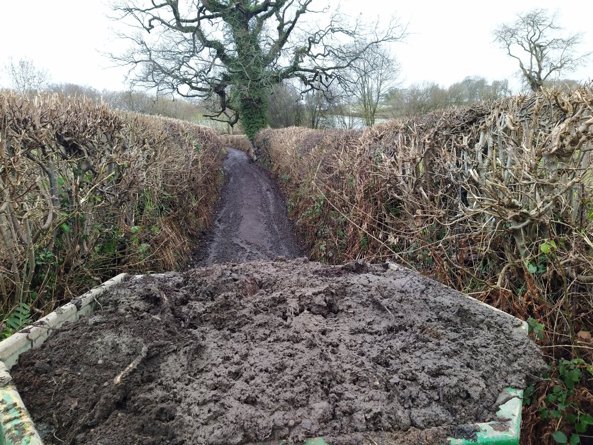

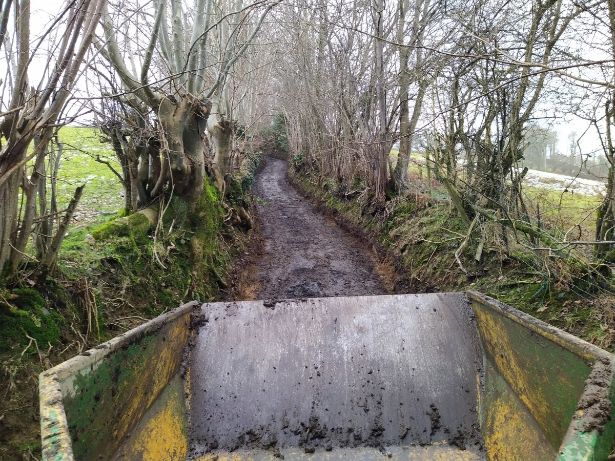

One I had on hire, specifically needed a high tip.
The lane we where working on wasn't wide enough to get a tipper, or even a 3.5t tipper up, so used the dumper to carry down to a 7.5t tipper waiting at the bottom, and tip into him.
