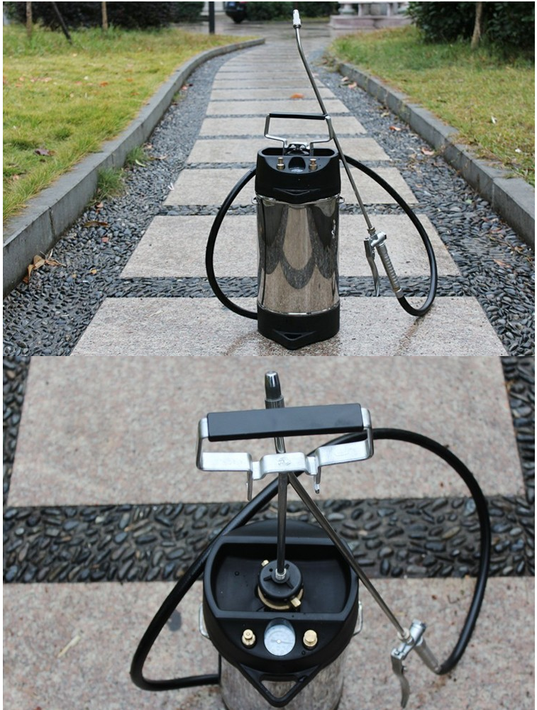

If you don't mind a bit of diy a 20l can with a tyre valve and a hose nipple in the lid works well with either a foot pump or a tyre compressor or if you feeing cheap I have managed with the hose pushed through a tight hole in the lid and a tap to regulate the flow on the outlet best thing I have used is those blue plastic 30 liter drums with the snap top lid as they are easiest to fill
