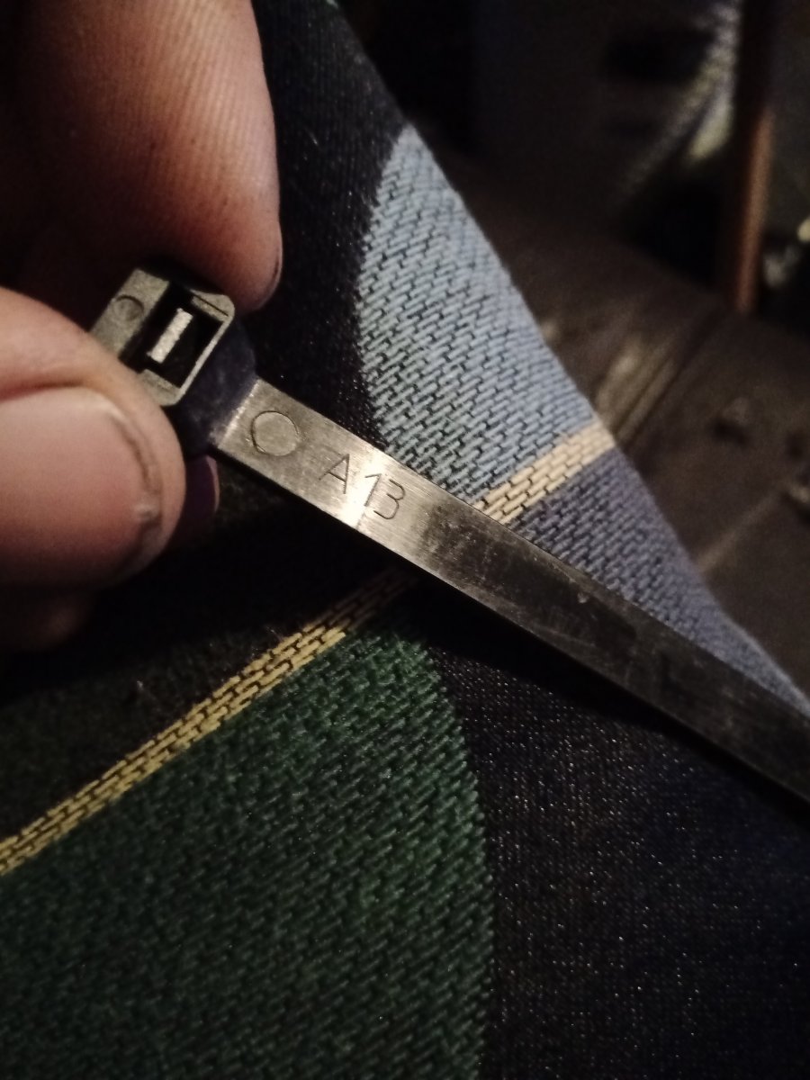

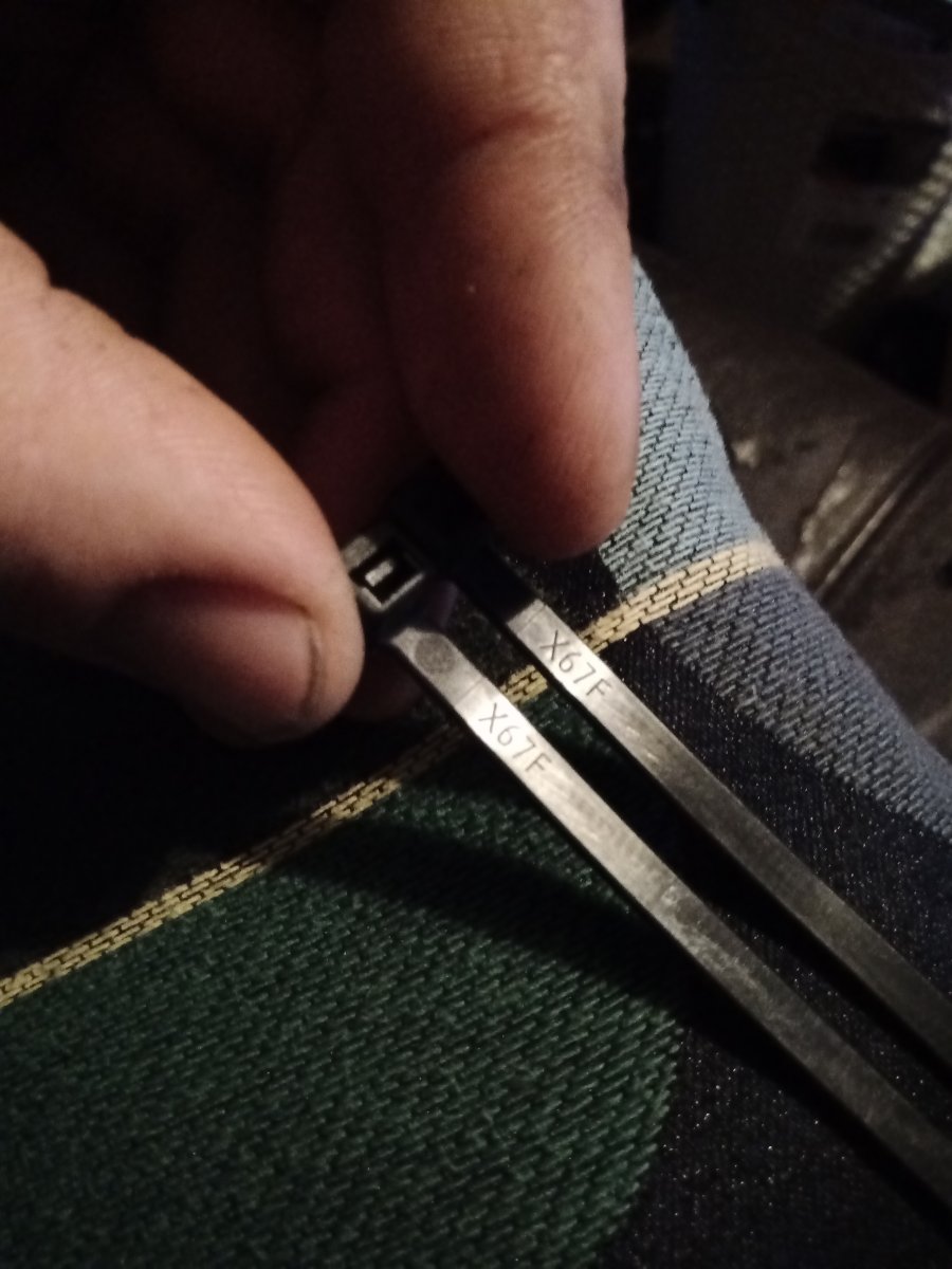

So they do, not something I've ever noticed before it wasn't to hard to find a pair either
View attachment 19922View attachment 19923
Would be very frustrating trying to read that wrapped around a pipe and no doubt lead to errors. I'd much rather spend a tenner on a pack of coloured ties.
I'd have no chance of reading them.
Just a few different colours and also used with blacks/whites in conjunction'd give you a huge combination of IDs
