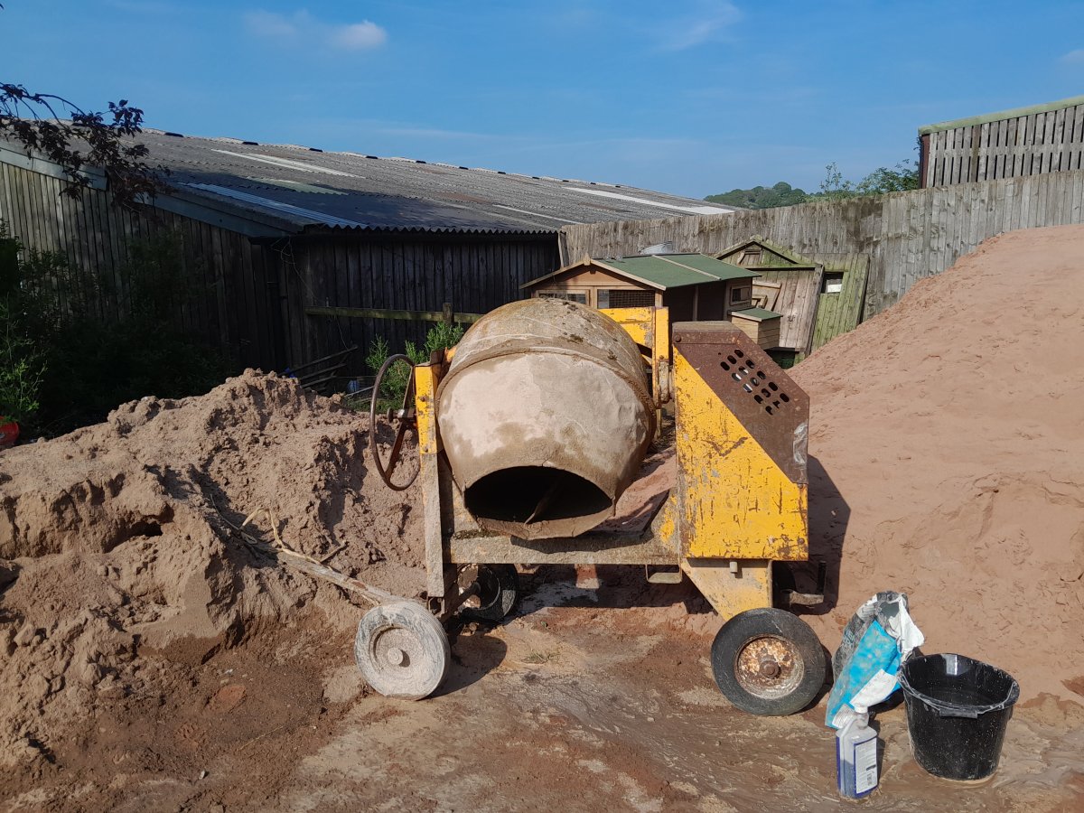

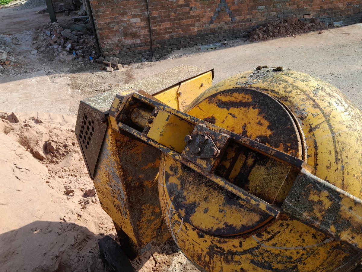

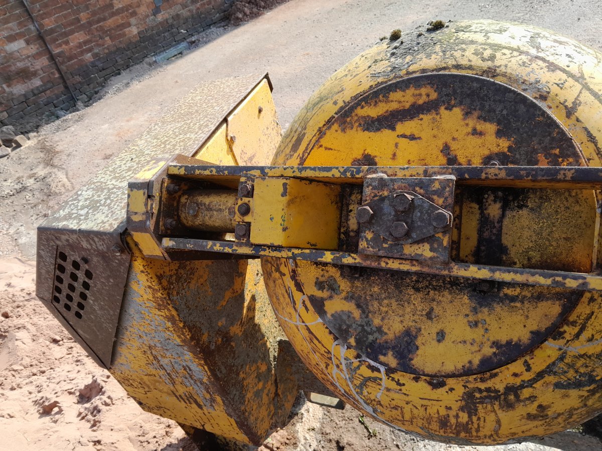

Anyone know anything about these. Few years ago I had the drum bearing done inside the barrel. It seemed like the barrel has play in it. Wondered if there was a bearing at the back that was wearing out.
have had a few Parkers over the years ... great mixers, but never had to touch any of 'em - just crank, run, wash and repeat
We had a Parker Little Giant a long time ago and I’m sure I changed a bearing at the back of the drum where it joins the yoke.
Yeah like this one. But it's making noises now and again. Expecting it to go banghave had a few Parkers over the years ... great mixers, but never had to touch any of 'em - just crank, run, wash and repeat
i got one ,it got a bit noisey ,took a link out the chain ,quiet as a mouseYeah like this one. But it's making noises now and again. Expecting it to go bang

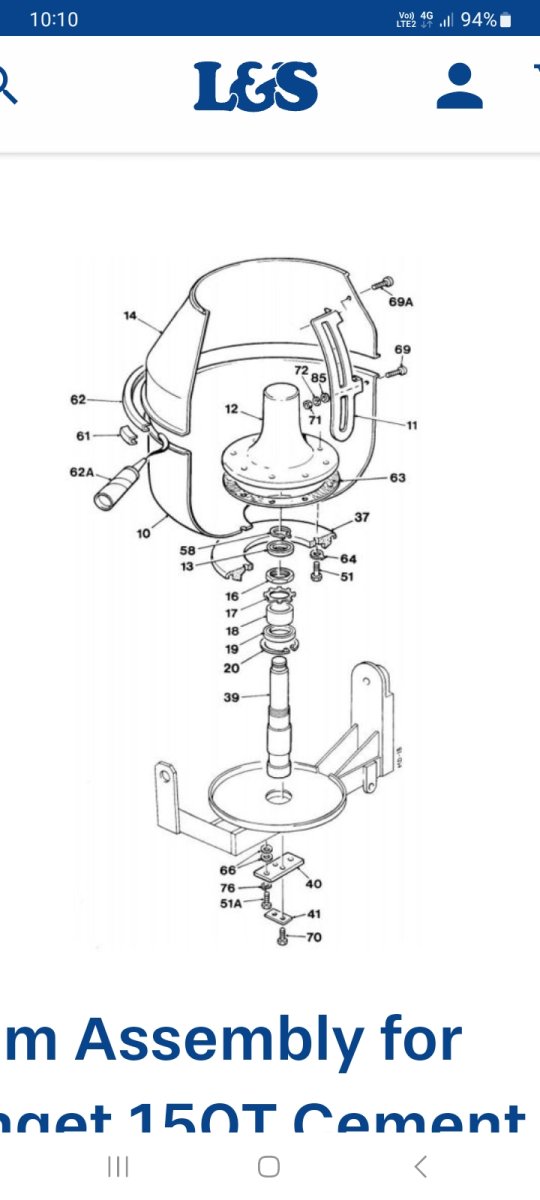

Not quite how I put it DylAs Graham has told me on pm. Thrash the shaft out and remove barrel then strip and replace bearing
