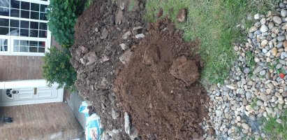

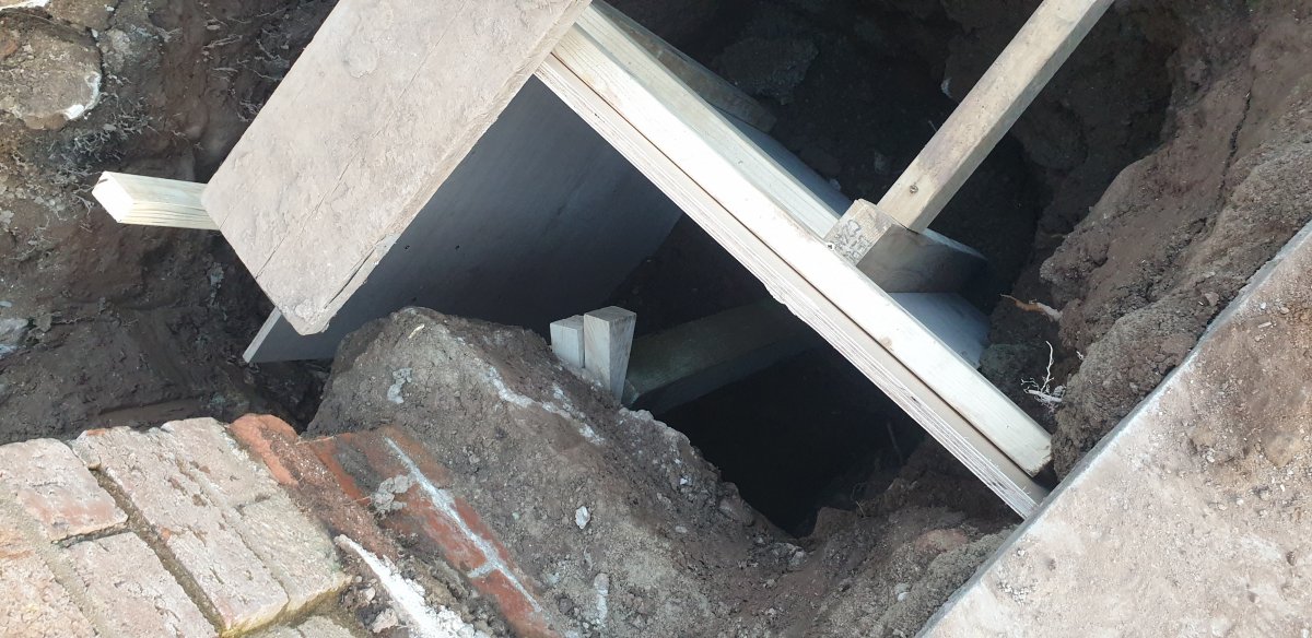

Yes the ground is awful made up with all sorts of crapIt's always scary underpinning the corner it always feels like there's nothing under the house literally!

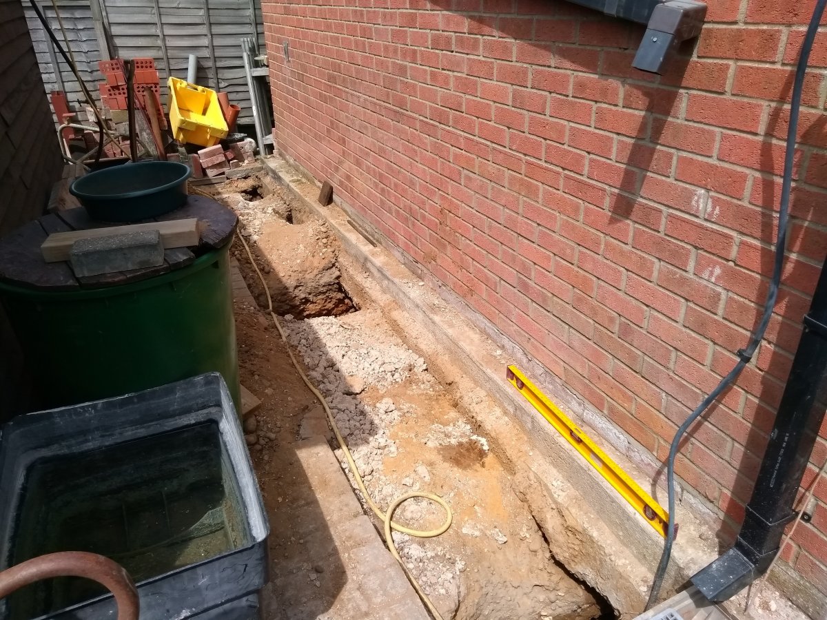

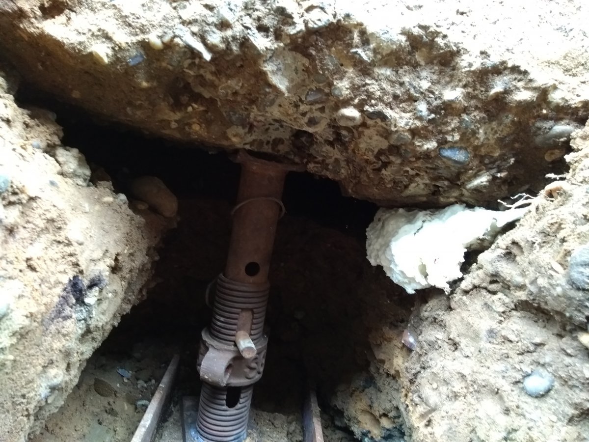

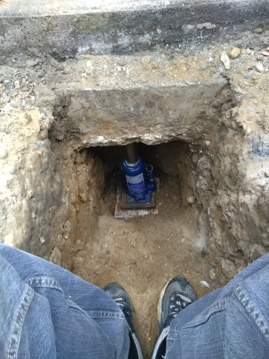

why?? .. had it dropped?last year during first lockdown I got a bit bored and decided to lift my garage up about 6" at the back I had already ask a local Helix screw pile contractor and I thought it was a keen price but could not get his mini digger around it think it was someting like £800 per pile to a certian depth then so much a mtr so I dug a hole under footing and found some concrete blocks cut them in half and put on a 16 ton jack and jacked them into the ground and keep putting a new half block untill it would not go down any more then i went all around the garage,rear I went down about 1.7mtrs front over 2 mtrs.Then put a few jacks under totaling 72 tons and jacked up the back 6" .I had a few trench acrows cut them down and put them under the footings and concreted them in,then dug under footings between piles and concreted under then drilled through floor and washed sand under floor

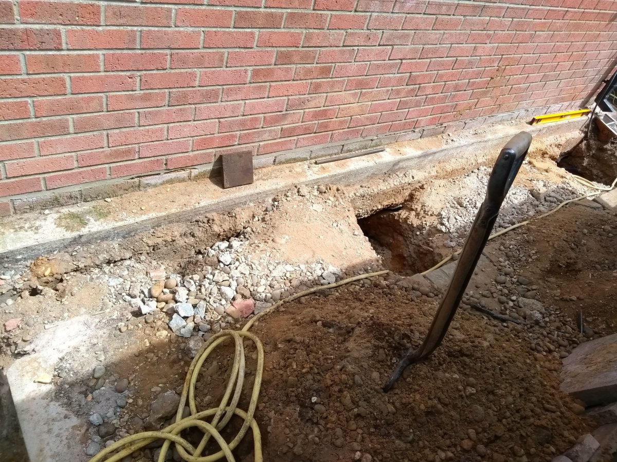

how did this go did you have to tighten up the gap after you concreted it and stitch brickwork or was it concrete it and leaveUnderpinning single storey extension, limited access 1.9m deep before we hit firm ground, shuttering part complete.
A lot more to do!
We've concreted, reinstated patio but hope to go back later this week to tie it back.how did this go did you have to tighten up the gap after you concreted it and stitch brickwork or was it concrete it and leave
This 1 was too. The problem was it was a big extension with limited access thats why they decided on the underpinning routeLuckily so far anything I’ve come across which needs under pinning is single story, works out a lot less hassle to knock it down and rebuild of decent footings. Plus no issues when you come to sell ref warranty
