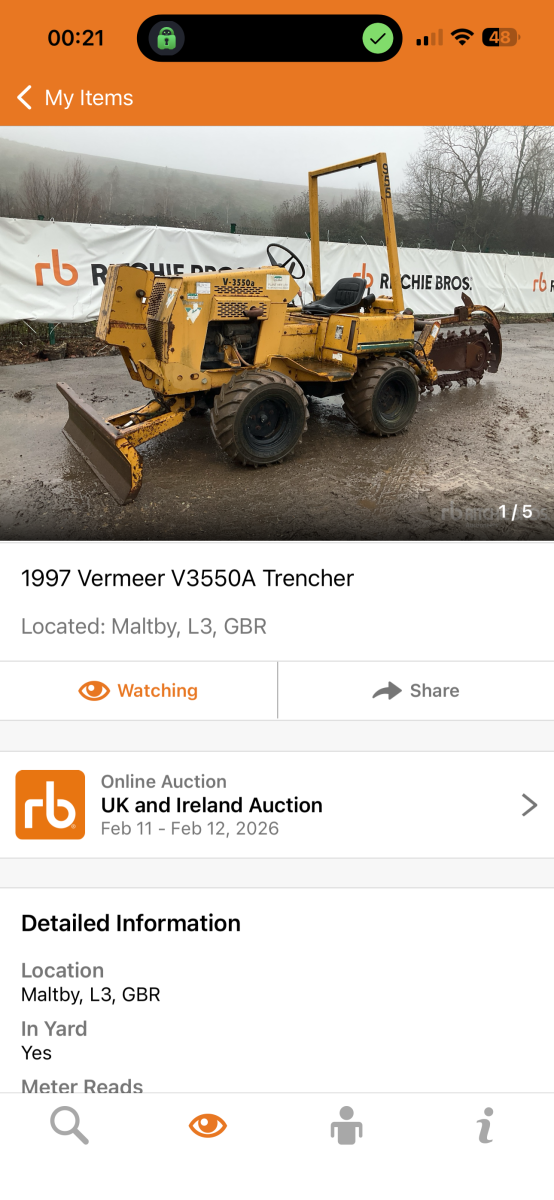

Revisting this I’ve got two jobs to do for the trust in ag farm land new supplies for fields and 1 for farm yard. 250m each
Thinking of buying a trencher as time is tight this year
Anyone know going rate per m and other than checking for services and drains the downside to thrmmm

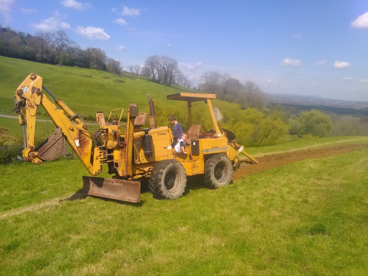

I have borrowed this one a few times. Will do 100m an hour quite comfortably on clay ground. Around 1m deep and just over 100mm wide. They are no good on stoney ground as trencher will bounce off big stones.. handy to have digger on site to deepen any rocky sections.
6 way blade makes backfilling quick.
I've only ever charged normal day rate as usually helping friends out, but sure my friend on the utilities charges we'll over £15 a meter.

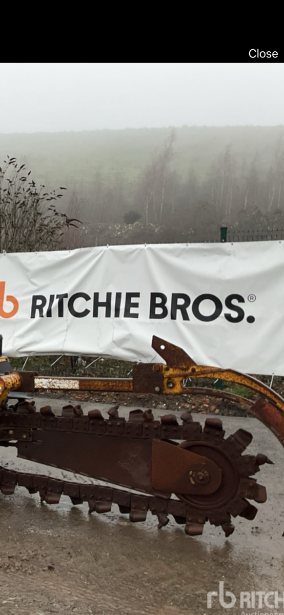

That’s a big one!! lol the one in auction weight plate says 1830kg so attractive as towable, has carbide planer points on chain as well
It’s the fear of drains etc in the ground I’m unsure about

no cab for starters :oops::(

That small trencher should be useful at that weight with the carbide tips. Vermeer very good kit.

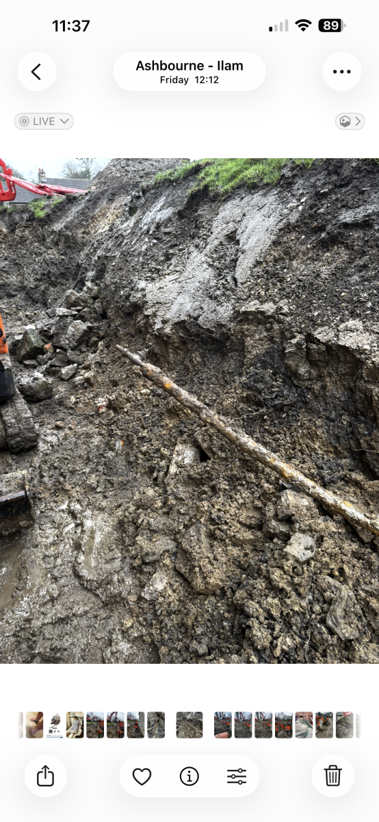

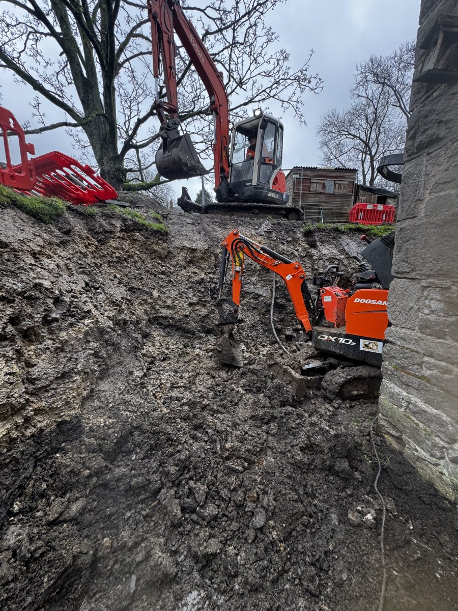

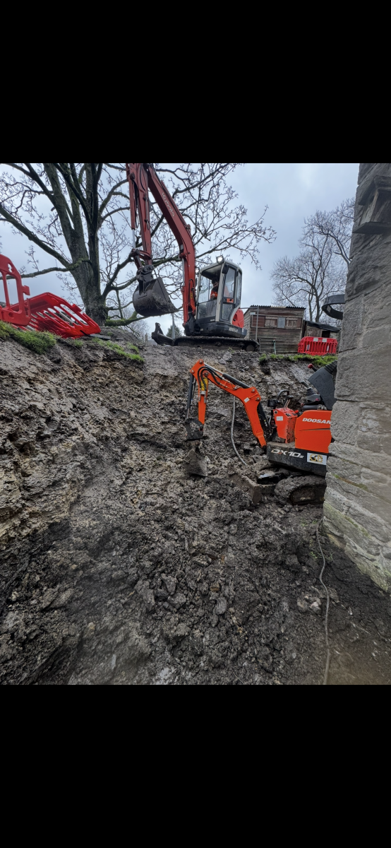

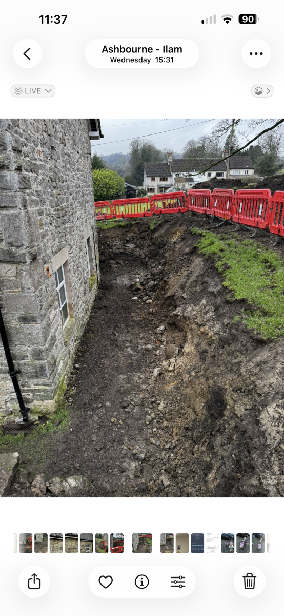

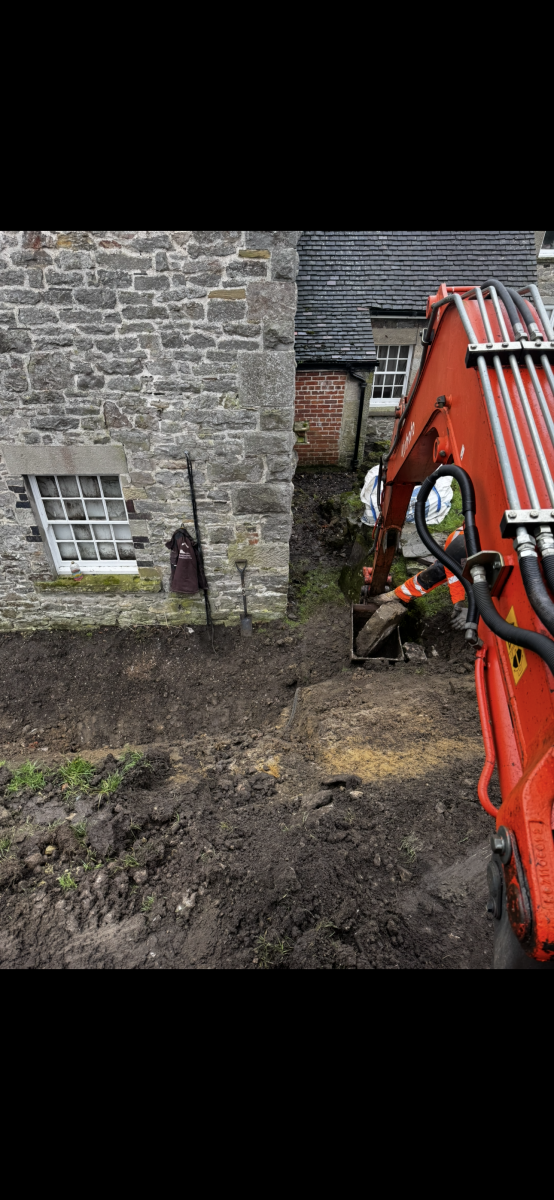

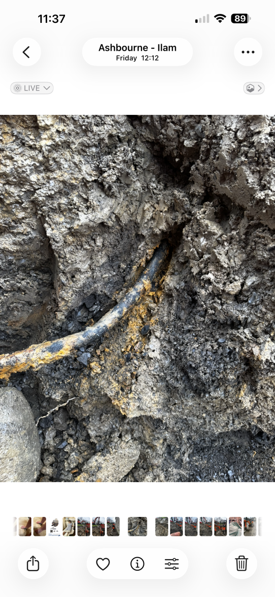

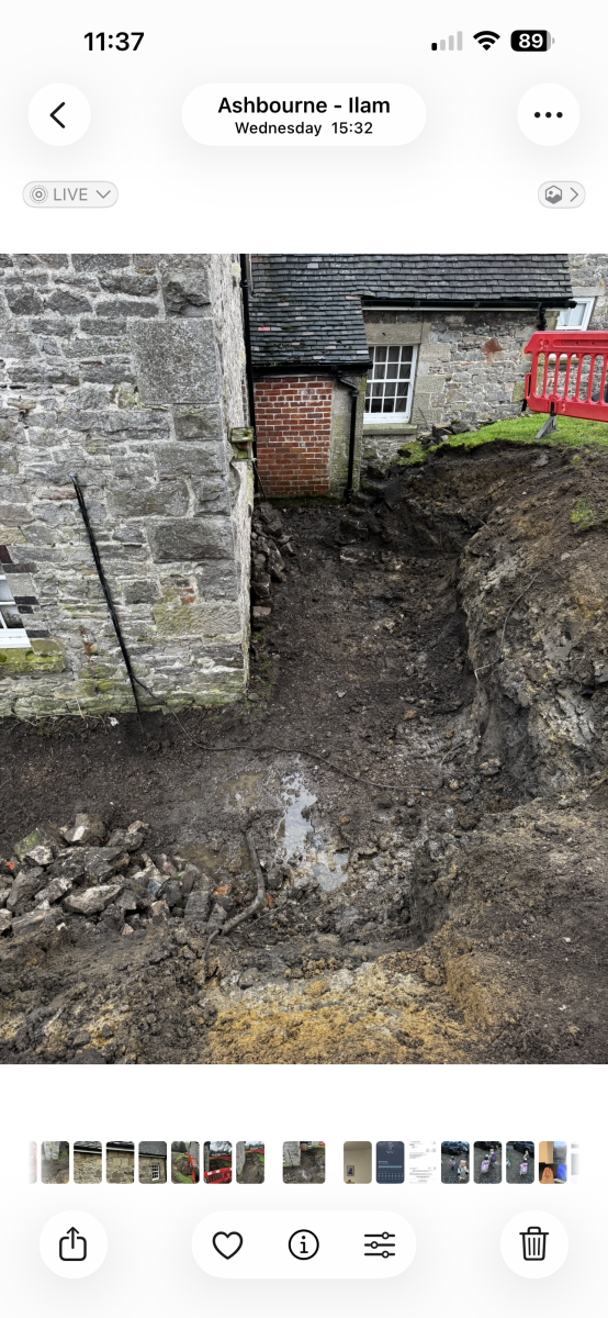

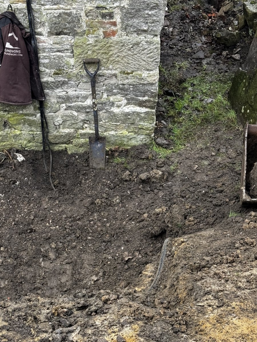

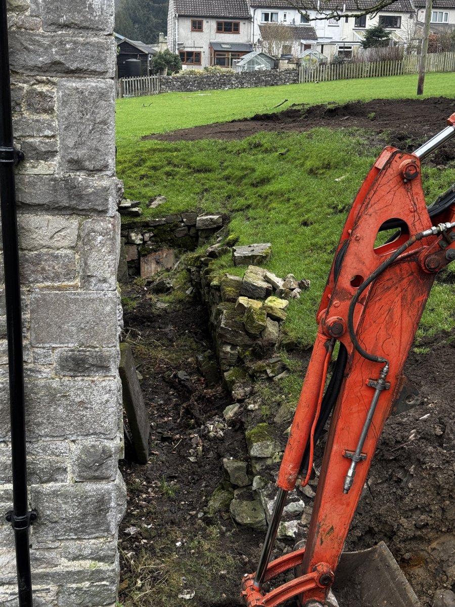

This one we are on at moment found an old cast water feed and 2 electrics, cat showed 1 incoming main but other wasn’t showing but the genny on it
Also traced fibre with genny and clamp ring
Avoiding stuff while digging is 25% the job lol

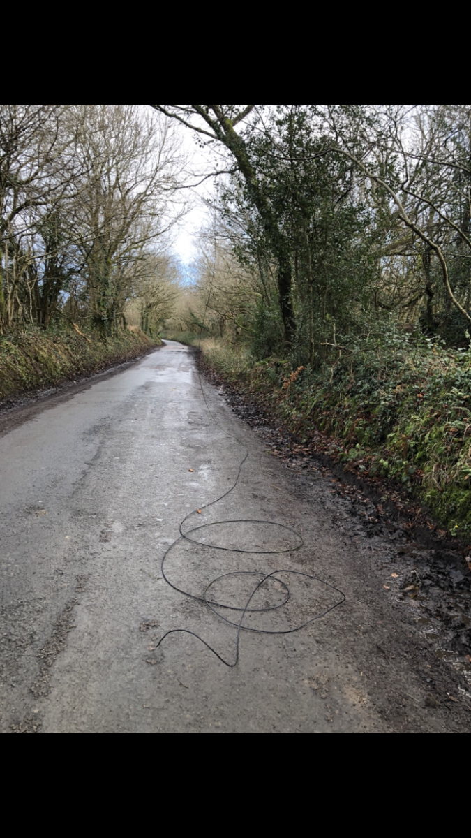

I may or may have not pulled out an open reach cable. Last place on the exchange and both the places served by the line that I dug through don’t have a landline. (Mum and dad at the farm - and the original house they sold off)
I was then only giving the pole a test wiggle and the cable pinged off across the road so I threw it up in the opposite hedge. Still there I think.
Pole ‘fell’ down in the wind shortly after 🤣
