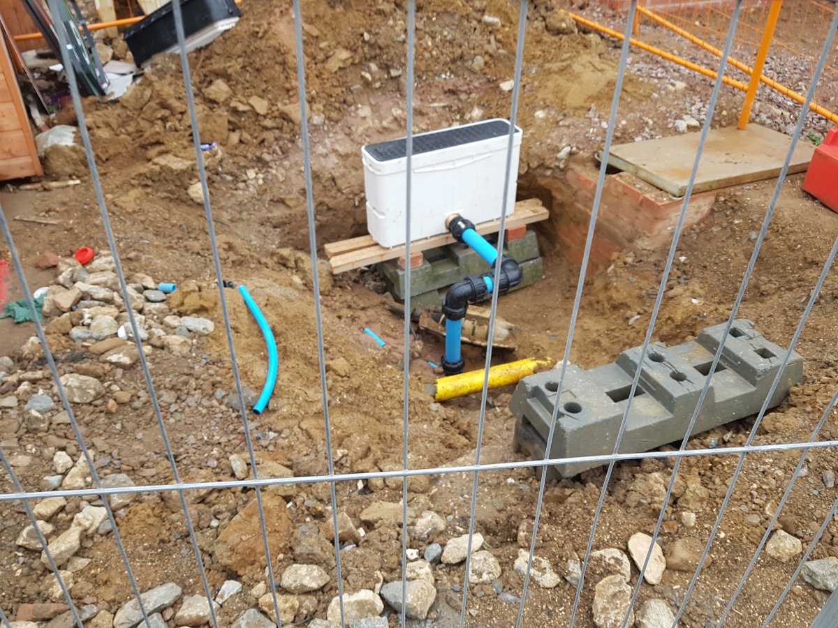

On a job I'm on
Big Jordy
Big Jordy
It’s a multi box form the main normally 2inch feed and can be from 4 upwards outlets used for the likes of apartments..I know over here in Northern Ireland that will b a t piece off a bigger main to feed that multbox and should reall be once piece from main to box.. to many possibilities of leaks.. is that off a saddle on the main? Can’t make it out? If it is that’s a big no no over here anything over inch isn’t allowed on a saddle has to be a t piece..
Jordy
Jimoz
I think it's a multi service box as discussed but don't think there's any flats here must be for 4 of the houses. Imagine if there's ever a problem with those elbows digging that up! Also so much for 750mm those boxes don't even look that deep it's like the single telescopic ones very rarely see them in at 750...
Jimoz
The work here is honestly dog poo. I'm taking a few pics here and there. Keeping my work half right bloke was well chuffed with my joinery but id never buy one of these f****ng things.
I did wonder with all those joints .... a lot of potential for future grief .... and not very deep at all for water :oops:
